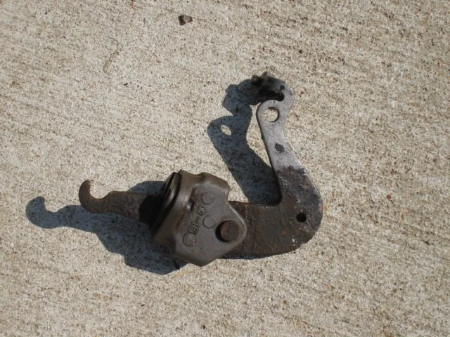

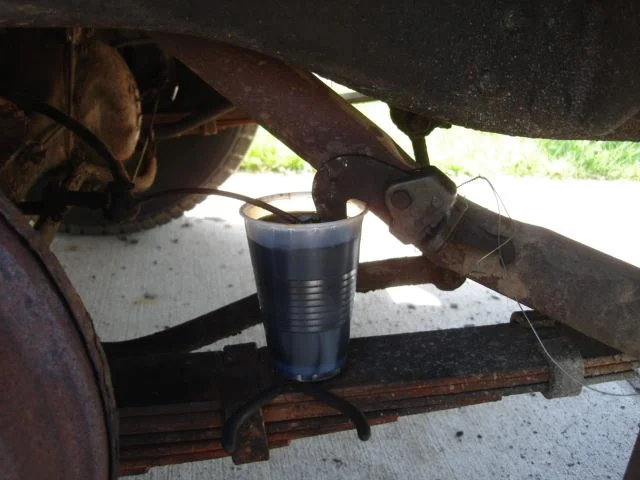

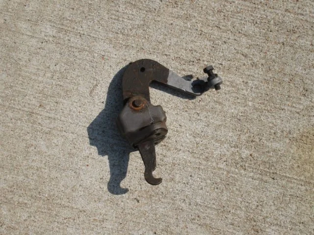

attachment.php
attachment.php
20hrs later and wiped off with paper towel
attachment.php
attachment.php
