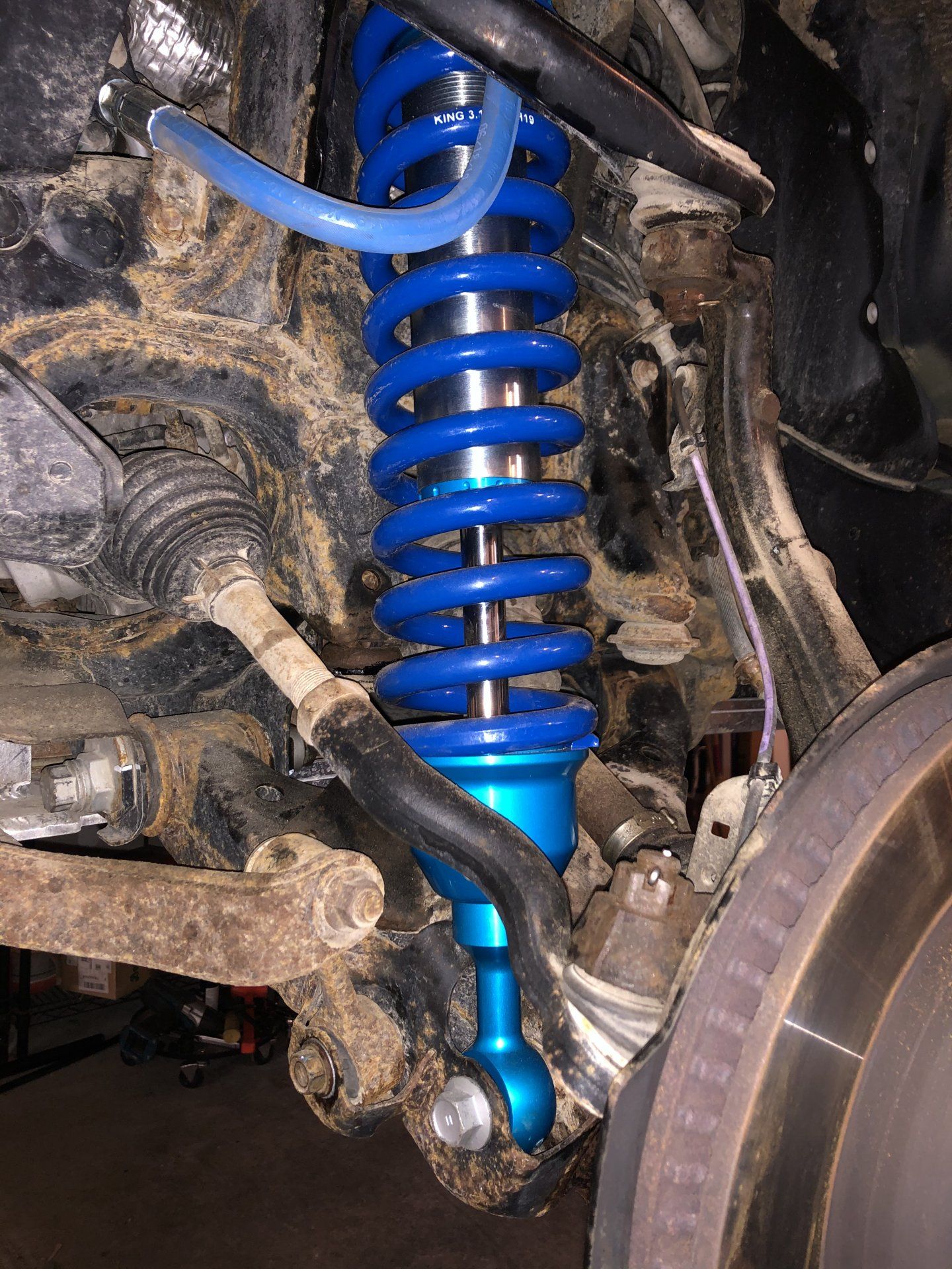

Here is a representative snapshot that I have on my phone from a recent suspension job:

Pictures of the rust would help. If it’s flakey and thic
Love the Kings though. I can’t wait to put those on next fall. The blue will look great on my blue 200 🤩
