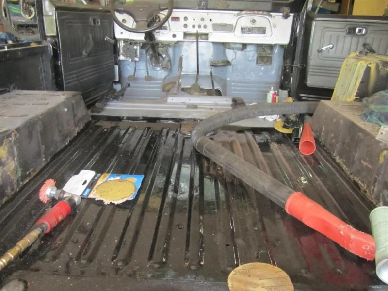

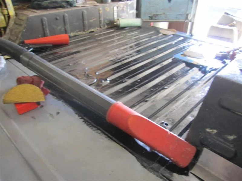

Here's some pics of the before/after of the bed. I still need to finish up the wheel well arches.
Overall, I'm very impressed with the Chassis Saver. It dries to a smooth and hard surface.

Why didn't you CS into the front floor boards? How far are into the front are yougoing raptor line the truck? When you did the CS did you cover the bolt holes?
I see cool! How many coAts of CS did you use? How long between coats?
