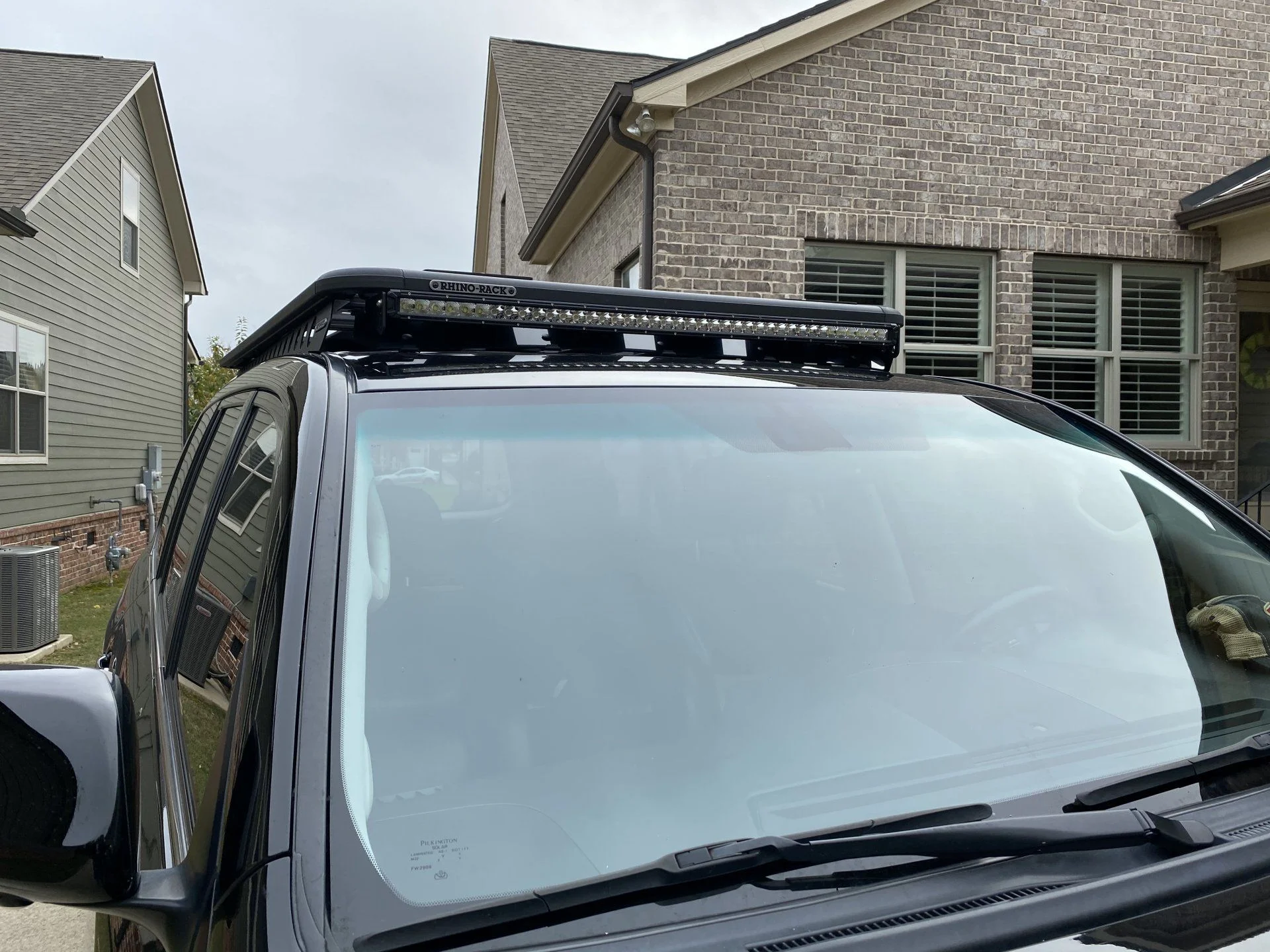

Currently setting up solar on the roof and was planning on running the wires thru the rear hatch. I have been running the cable for my magnetic antenna like this for some time and haven't noticed any water intrusion or other adverse affects. However these cables are larger and there is two of them. I've seen people mention this method over the last year but my search came up dry looking for examples or other methods. Any comments or suggestions welcome, just wanted to ask those who have gone this routes for some feedback before putting the side panels back on.

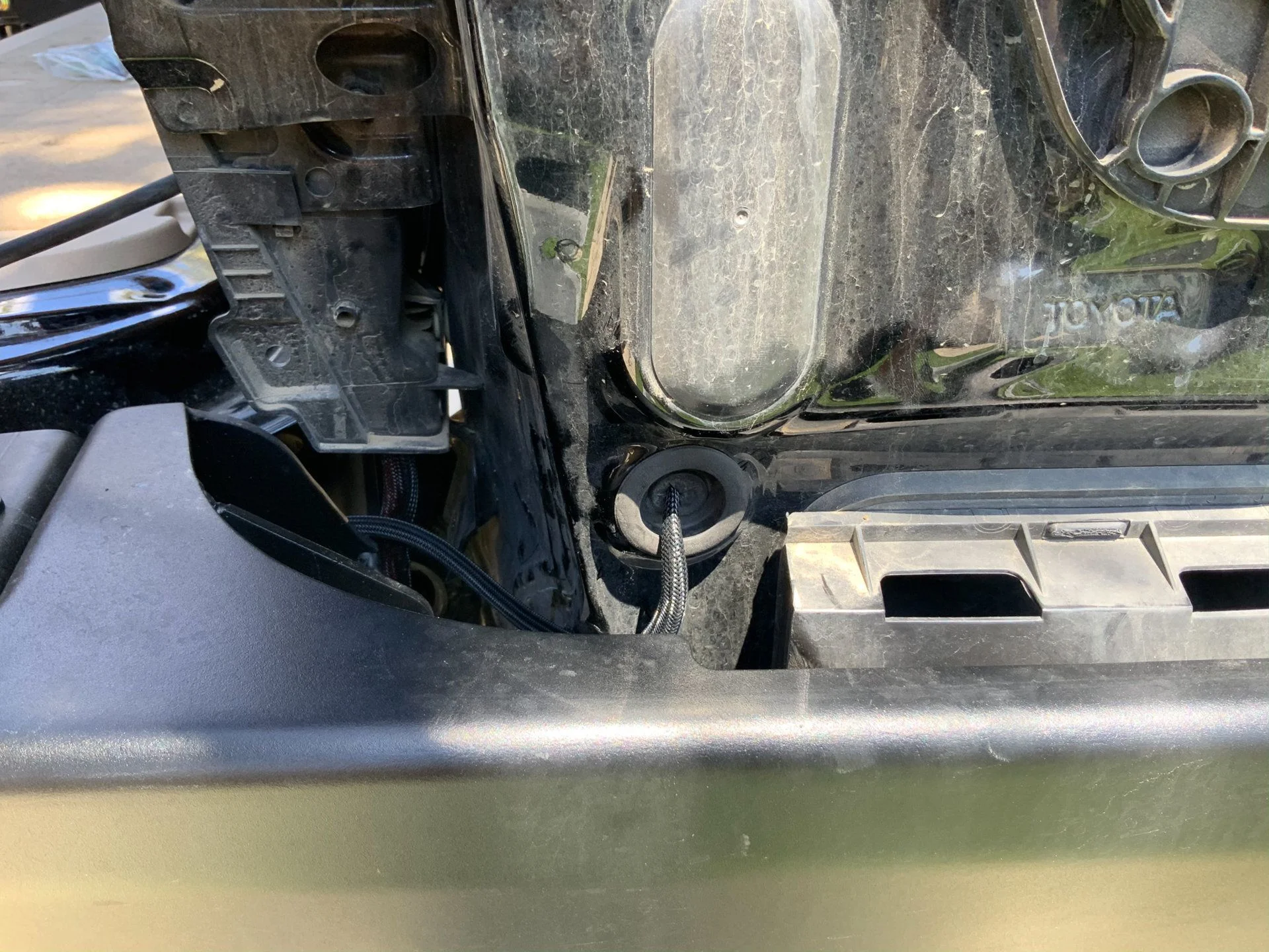

Ran my rear antenna cable thru this "mythical" grommet on the lower rear passenger side. In hindsight, this was way too easy compared to all of the other options. Not sure how hard it is to get access on an unmodified bumper, but with my rear bumper modified it was a 2 minute ordeal to gain access. Will definitely be using this access if I add more electrical accessories externally.

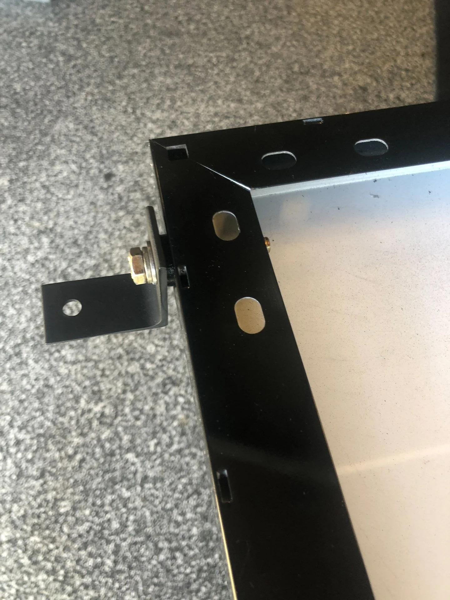

I'm also interested in how your attached the panel to your roof rack.

Went back and changed out tte brackets. 2" angle iron mounted straight to the rack. Probably only super relevant to fellow dissent rack owners, as the fit was very nice, only needed about 1/4" spacers to get it to fit.

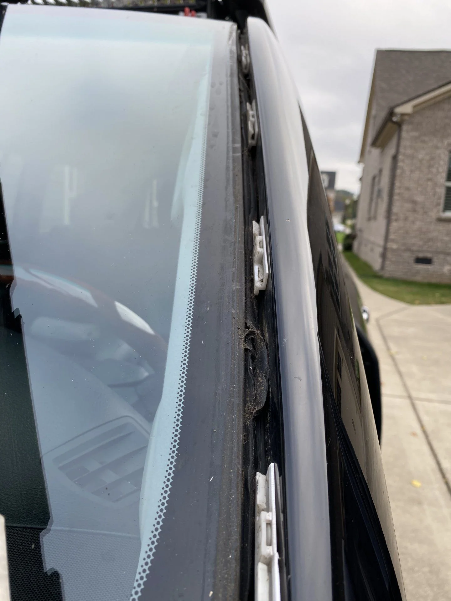

I don’t have a great close up “after” shot, but I think it looks pretty clean. I removed the windshield side trim and then ran the wire tucking it under the white clips, and then reattached the trim as before. In my case I had to use a blade and clean some adhesive where the windshield had been replaced prior and they did a sloppy job. That was the hardest part.

I ran my wires under the trim channel like @TN LX570 and you would have no visible indication that there are wires there.
This is prior to reinstalling the black trim that completely covers the wires:

agree with other posts, the wire is completely hidden adjacent to the windshield when done this way. A few others have put it in the channel on top of the glass, next to the trim. That's fine too, but you can then see the wire bundle.
@bemerritt where does this grommet tlead to? Can you access it from the inside?
I need to feed 2 cables to the outside for my Codan HF antenna and this seems the best option.
I believe a previous post said it leads into where the rear jack is stored. I’ll probably use this grommet for a solar panel soon, glad to see there’s a good option in the back.
