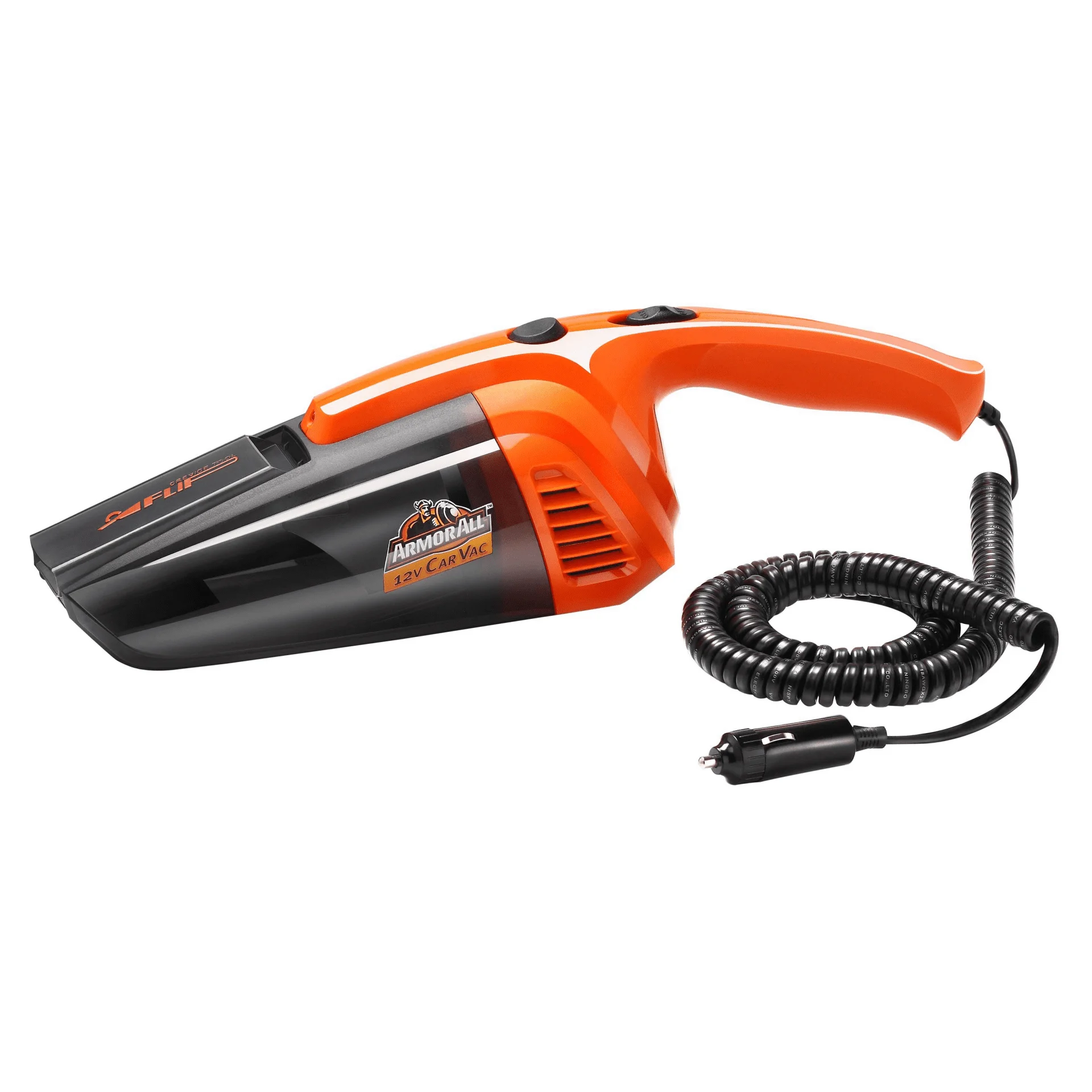

▼What will work▼:p

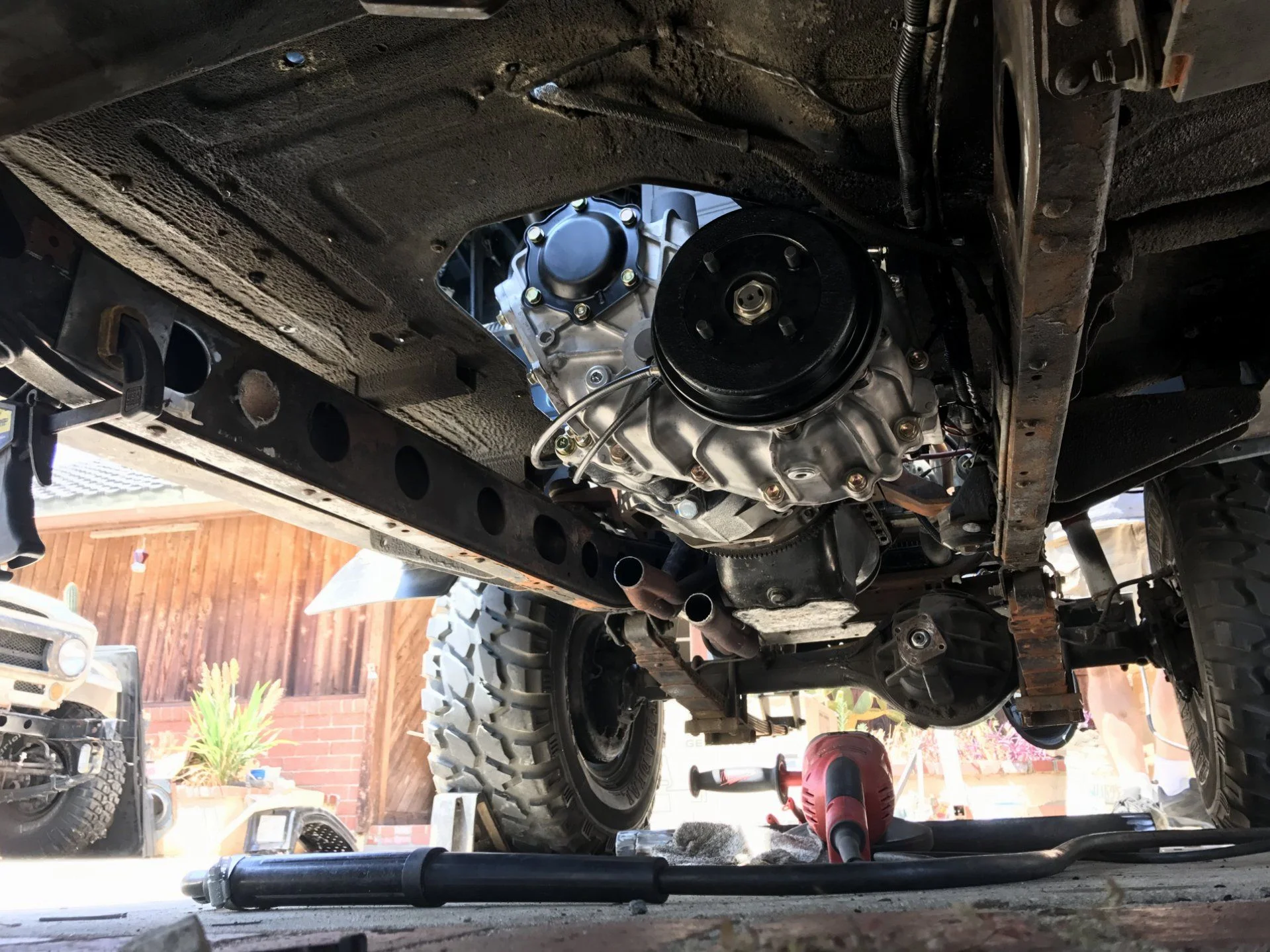

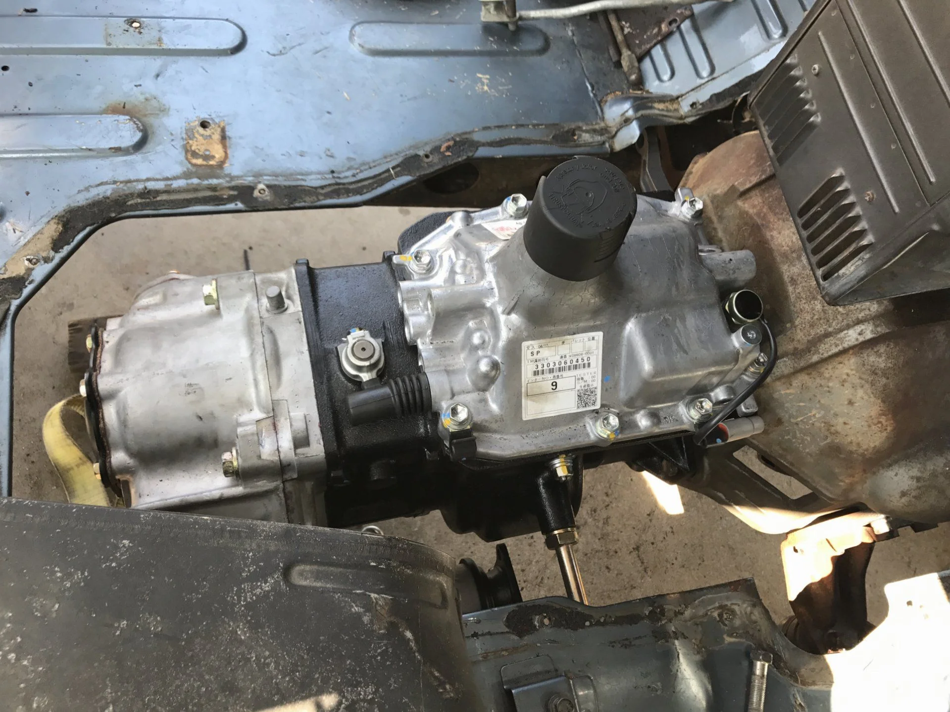

I know I know. I had an H55 transplant I needed to finish :(
What's the story here? You have some fancy hardware for sure.
How are you going to support the transmission?
