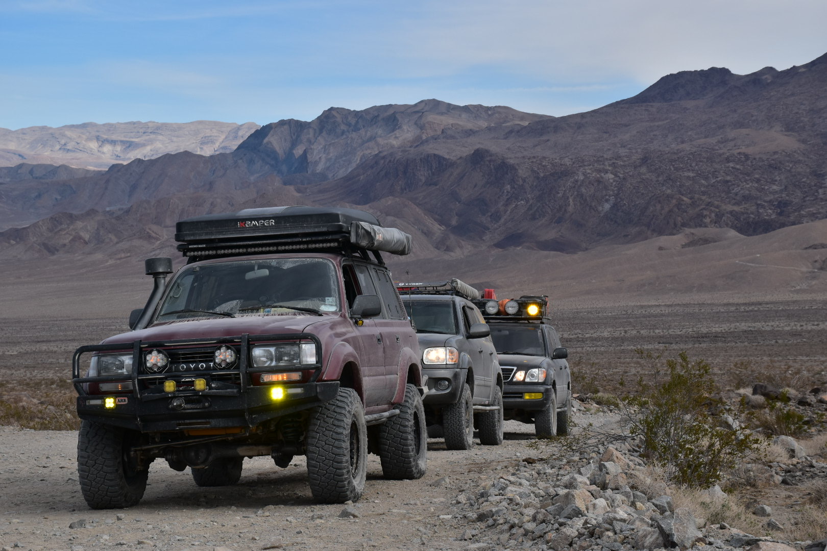

It should not be a problem to make that work. I’ve made many large awnings work with the ikamper on my Pioneer without having to offset the tent. What size Pioneer Platform do you have? The Wraptor is very similar to the 23zero in the first picture here. I even think they use the same mounting bracket. At the shop I work at we do this stuff all the time. We also sell both brands you’re interested in. Let me know if you want more info. 👍🏻
That's good to hear. I'm running the 84"x56" on their backbone with a Wraptor 6k. Specs for the Skycamp mini are 54.75" wide closed and they tell me it comes 5" away from the hinge opened, but can't really give me more data like at what point, angle, etc. I have a little room to move the awning bracket away from the rack but would prefer not to if possible for clearance.
