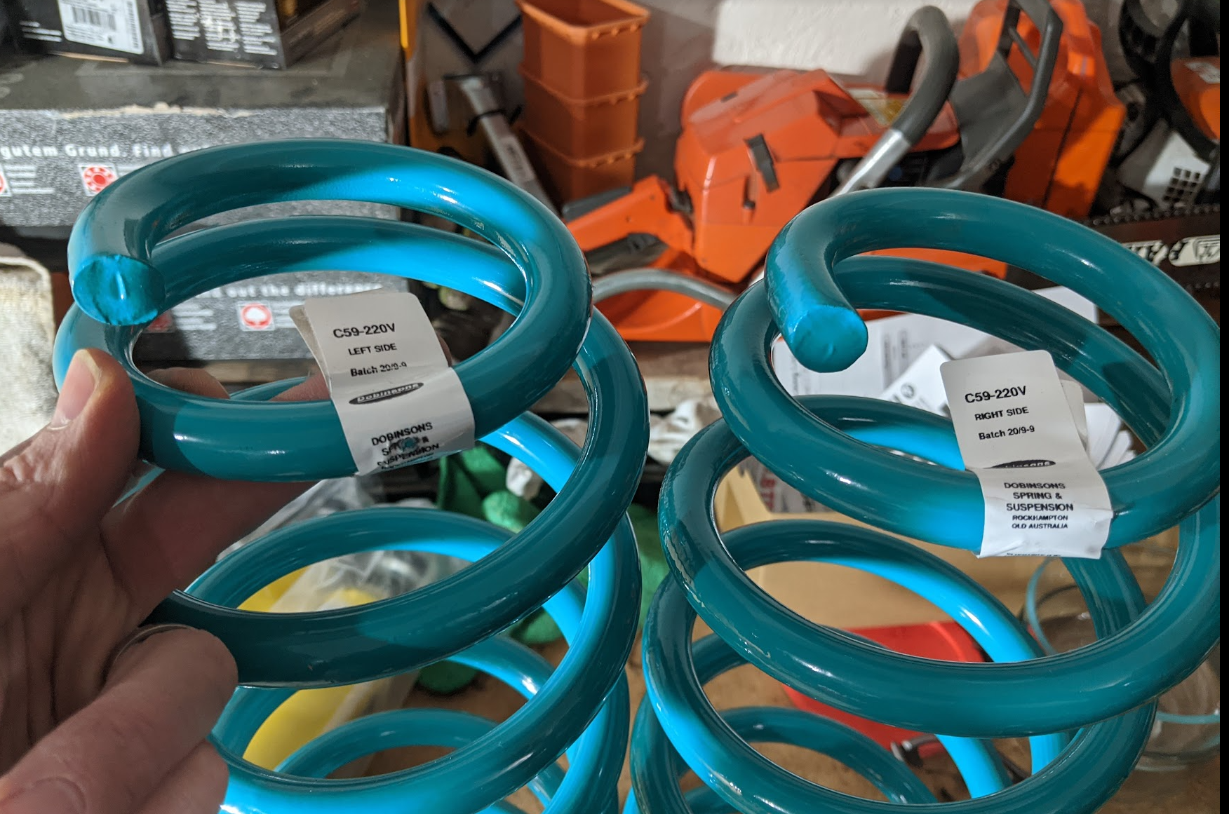

With the Dobinson progressive springs the taller spring says right and the shorter says left! So the shorter is on the drivers side…. The gas tank gets the taller spring???
Correct?

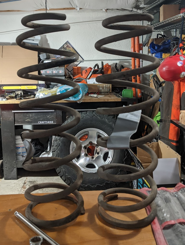

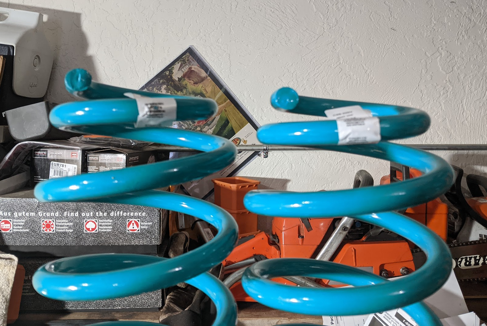

The taller spring goes on the driver (left) side. All photos are facing forward (like sitting the the driver seat).
You can see even the worn out factor spring is still a bit taller on the left side.
