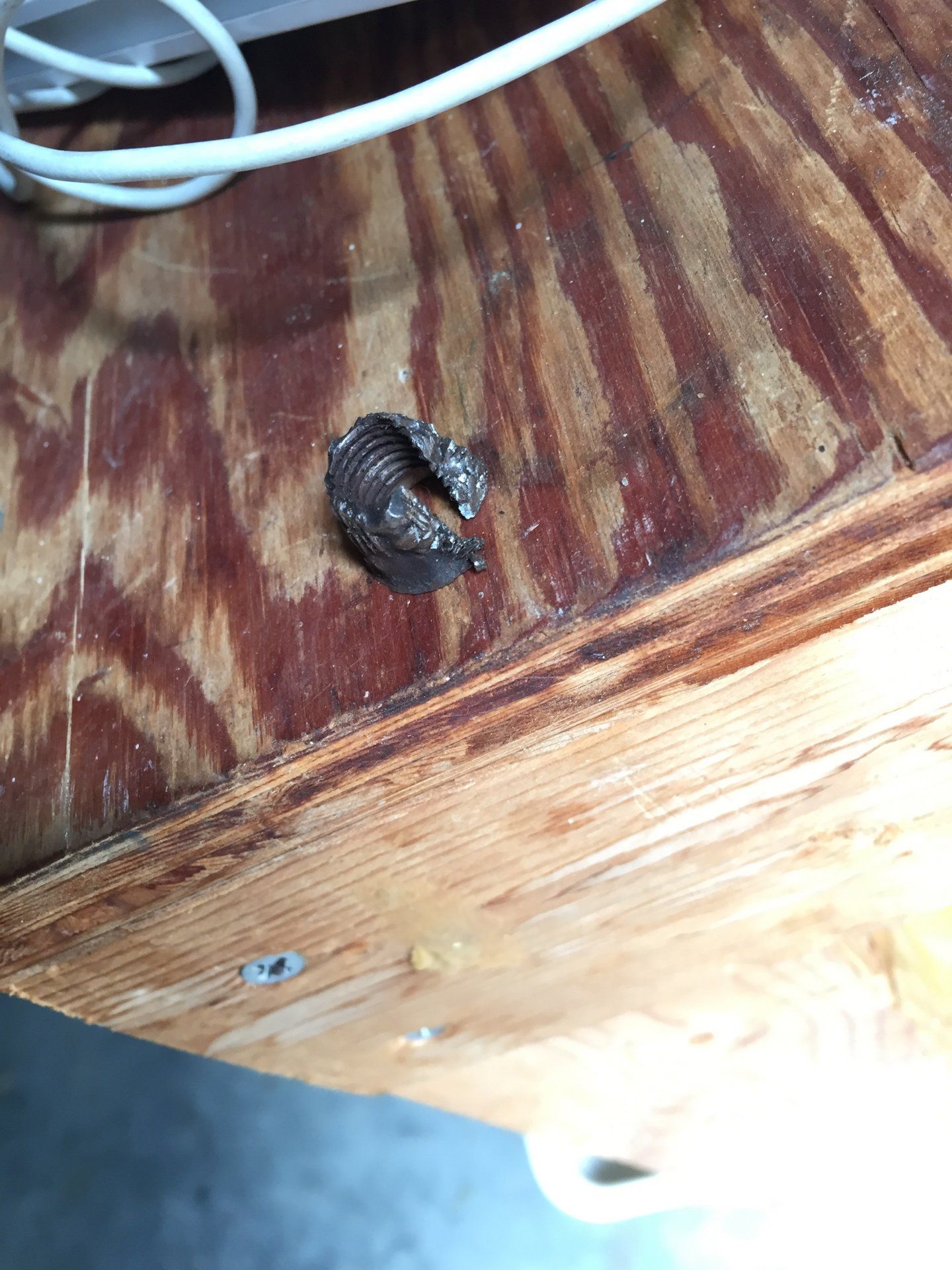

In case anyone's still watching - Just did o2 sensors (1994) today. I can confirm that you will be much happier removing/reattaching (especially reattaching) the heat shield with a 12mm racheting box end wrench (which will also be useful for the o2 sensor nuts, depending on the size of your regular ratchet). 3/4 of my nuts were fine after an overnight soak in PB blaster. The fourth (the outside one, thankfully), required a bit more effort.
full
The miniature vise grips didn't do the trick, but drilling the nut then using a hammer and chisel did...three hours later. If any of the other three nuts hadn't come off immediately, I'd have been up s-t creek without a paddle.
