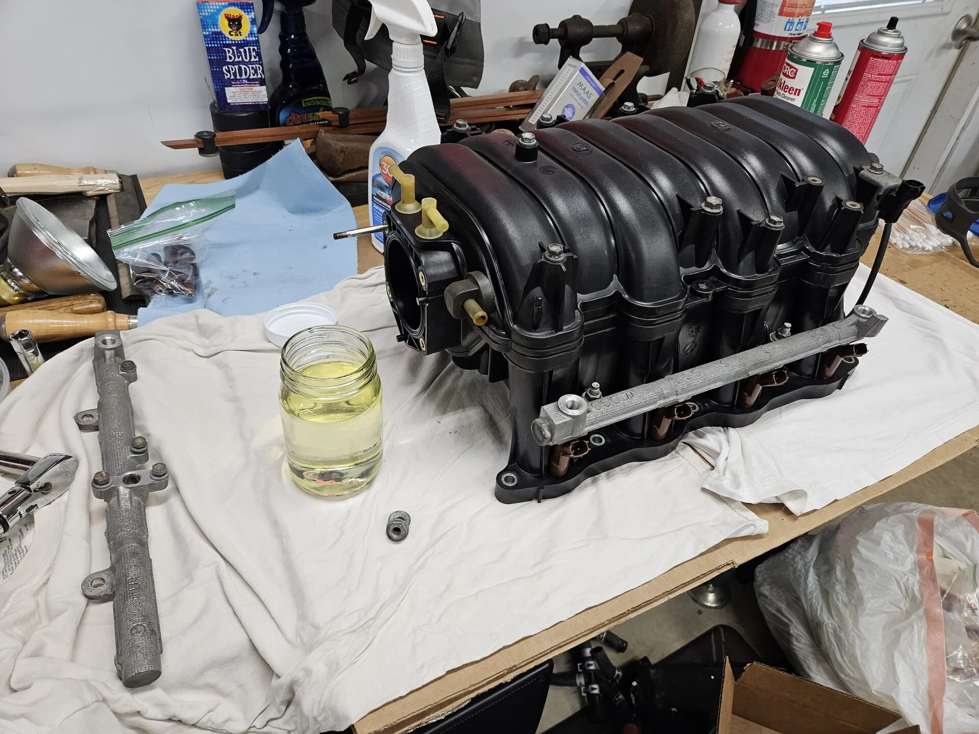

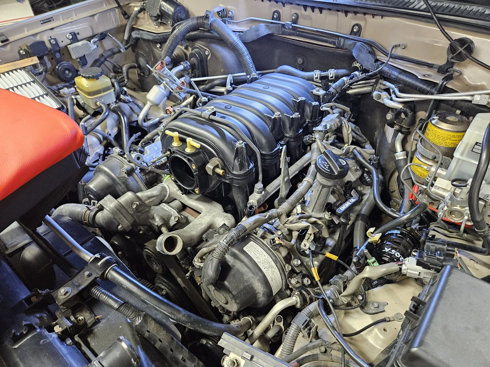

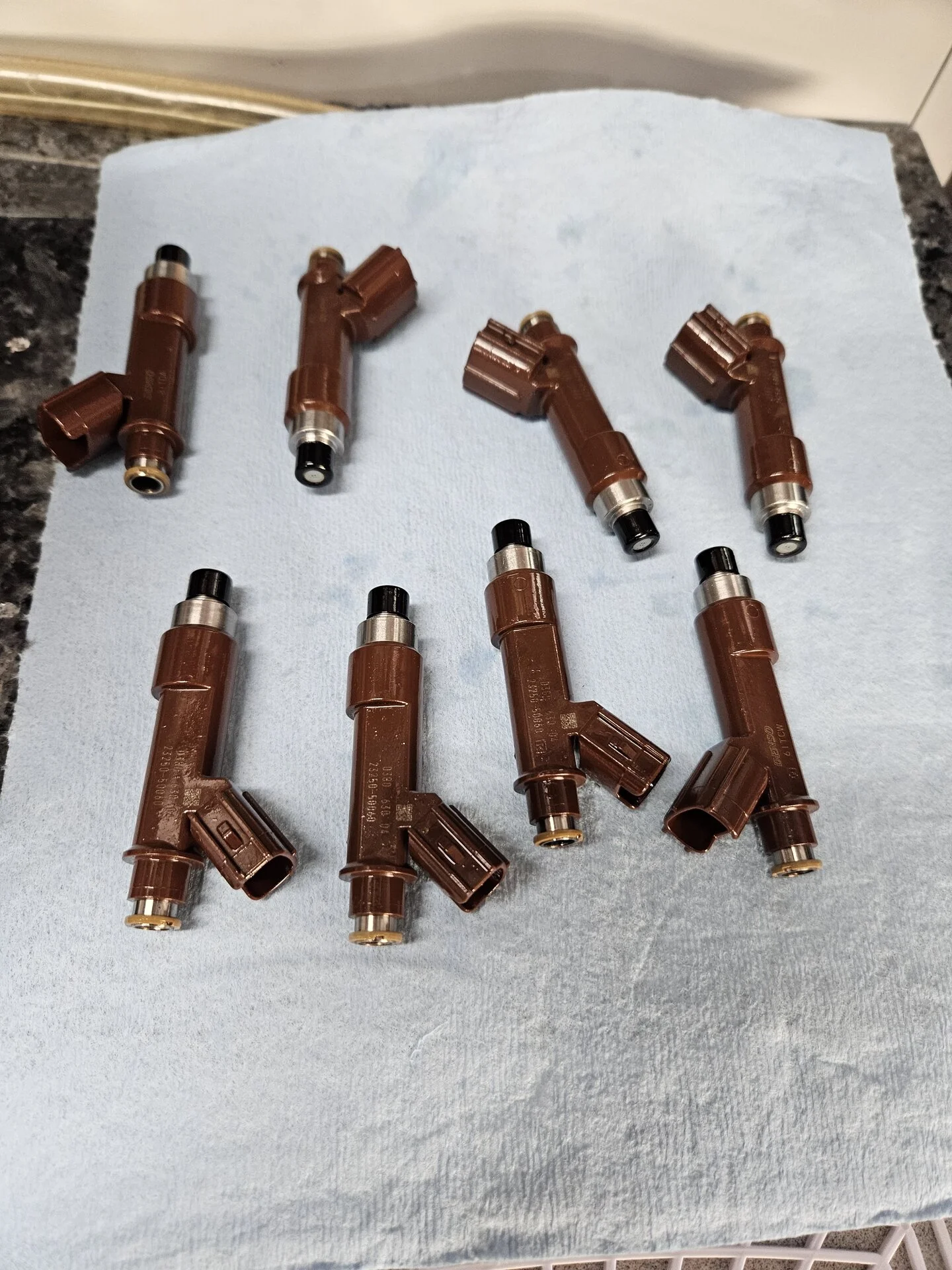

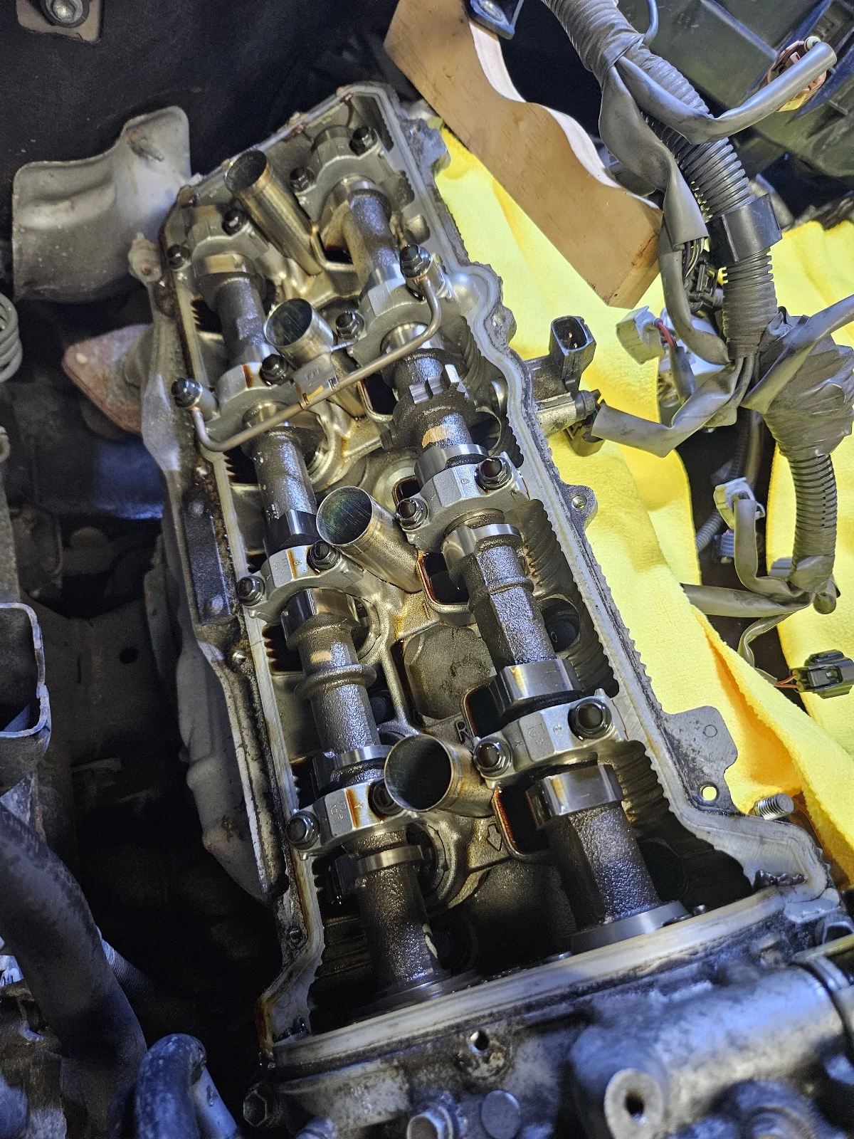

The work that Ryan did in part 1 made it drive 80% better. As I drove it for a week or two after OTRAMM work, it was evident there was still something going on. I messaged a bit with @2001LC and did some poking around and decided to pull the manifold. So after the OTRAMM work, I ended up replacing fuel pressure regulator and damper, new denso fuel pump. Rebuilt all the fuel injectors with new filter baskets, o rings and insulators. Did ultrasonic

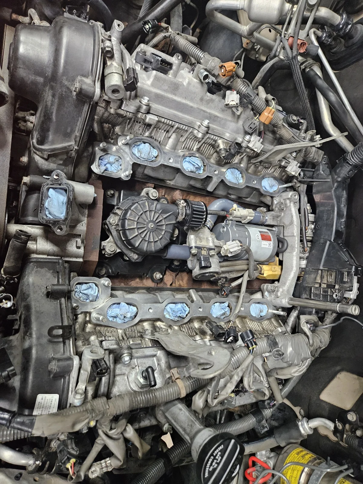

cleaning and flushed them out. They were quite dirty. Replaced intake manifold gaskets (someone had been in there before and used aftermarket gaskets w/ gasket maker...what a huge mess and was obviously leaking a small amount) and de-carboned the intake manifold and intake ports (thanks @OEMGUY0720 for the tips) with Berryman B12 (that's harsh stuff btw). Cleaned the throttle body really well this time (was able to get to the backside of it). New TB gasket. New IAT sensor. Hardwired the SAI bypass and took apart all the valves and pump while I was doing the gaskets and starter. Foam had degraded and blocked up the ports in the valves as predicted by 2001lc. Added the pre filter just to have the system sealed up at both ends.
So, basically the entire fuel delivery system is cleaned and new. All air intake passages are cleaned like new. The Throttle body 6 pin connector had been broken by someone prior to my ownership, so depinned and repinned the new connector.

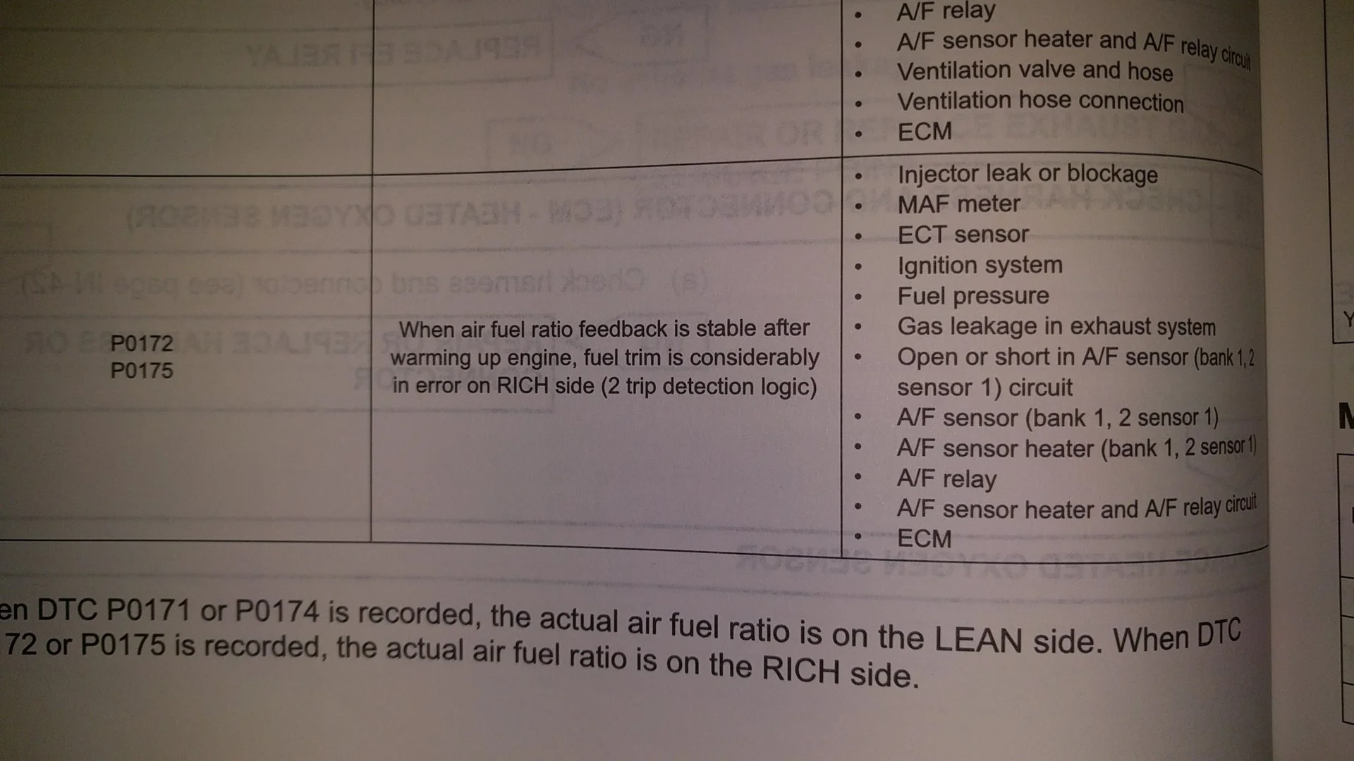

2 weeks ago, started experiencing intermittent stumble on acceleration but WOT (wide open throttle) was no issue. It would get up and go. First day it threw P0101 (MAF sensor), P0172 and P0175 (banks 1 and 2 rich condition). I cleared the codes on the side of the highway so I could get to my work meeting and carried on. It would run ok, but then randomly stumble until I gave it more gas.
