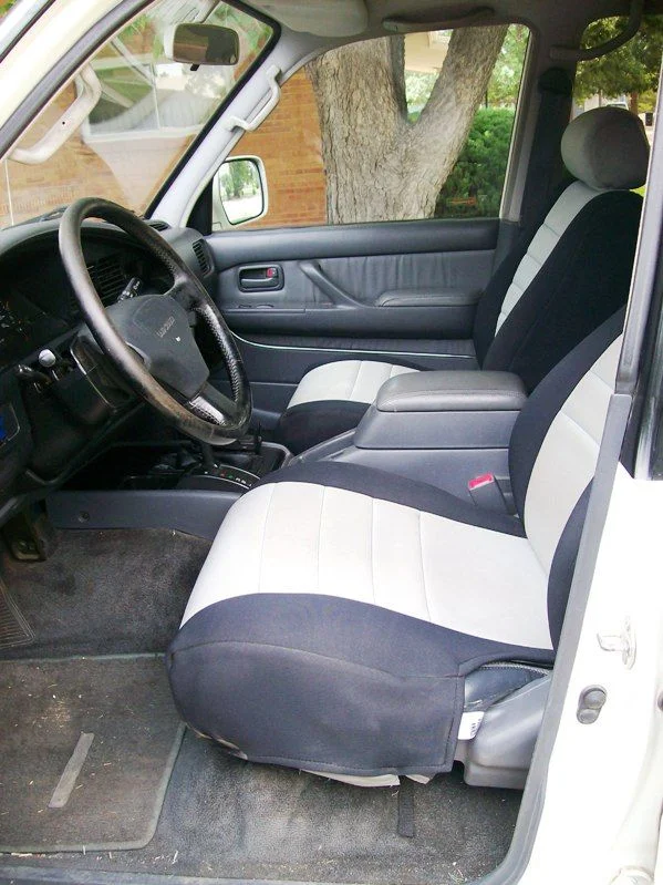

Can you post some pics of the Wet Okole seat covers and some feedback?
Do you sweat a lot with them on your back?
Are they comfortable?

here's a few not so good pics of the Wet Okole's.
I haven't noticed sweating in them. My A/C works really nice so it stays chilly in there. They are definitely nicer than the leather in terms of very hot or winter days. You don't get that freezing or burning feel. The rig is leather, the fronts were just cracked. I actually prefer leather, but for a cover, they are nice. They kinda stain with dirt when the get wet, so you need to clean them. They have instructions on the site about cleaning them on the rig with a mild detergent. I haven't done it yet.
They feel pretty comfortable. I'd prefer a leather replacement kit, but so far I don't have any complaints. The strap on to the seats pretty tight so you don't have full foward seat position...you get about 90% of the way before I stop it because you can tell it's pulling on the cover. Which is fine, the seat all the way foward is crazy close.
