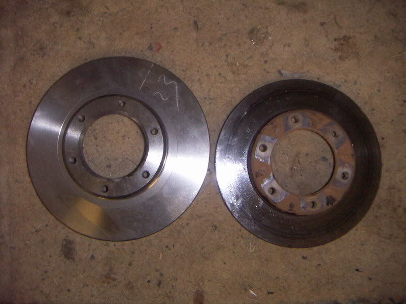

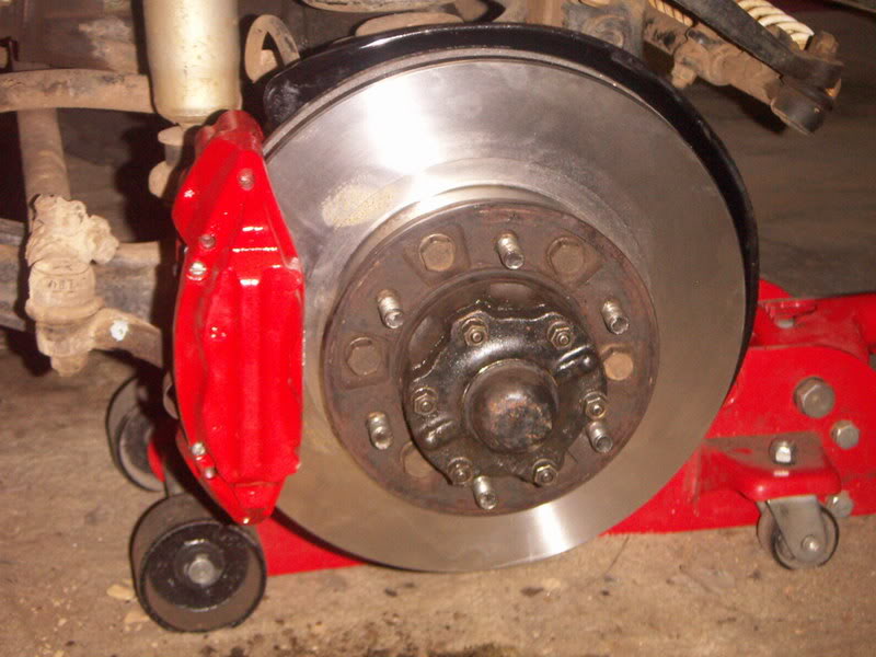

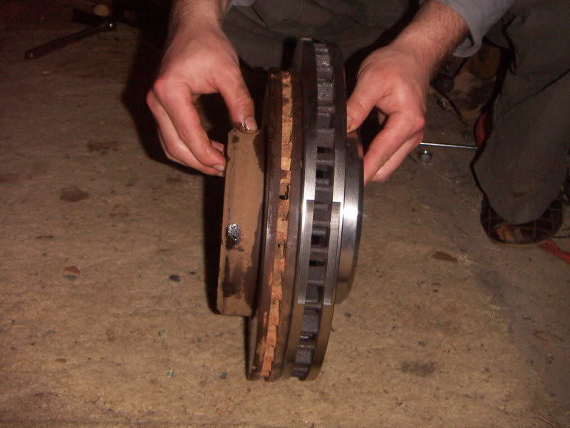

As my landcruiser was built prior to 8/92 I had the smaller front brakes. So I ended up converting to the post 92 front callipers, backing plate and 100 series pads. That made a HUGE difference in the braking ability of the vehicle.
Here is the difference between the rotor sizes:

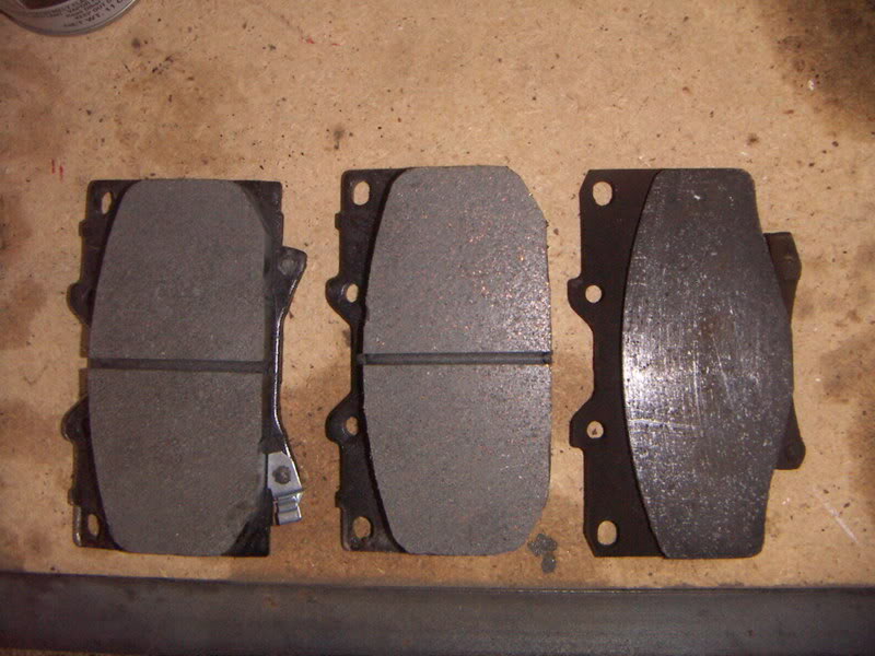

This is Standard 100 series pads on the left, cut down 100 series in the middle and standard 80 series on the right.

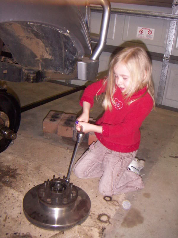

I ended up needing some help with this project:
This is the final product:
Very useful mod. Did you paint the calipers or did they come red?
So you have to trim down the break pads like the middle pic shows. Why?

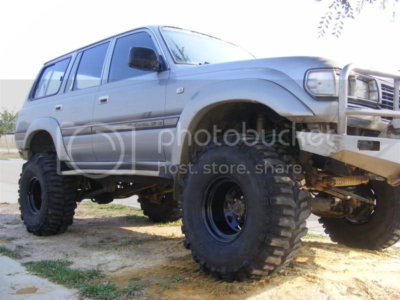

Its been a while since I updaded this thread. Alot has changed on the truck. Here are some pics.
I got myself some 37inch TSL Boggers.

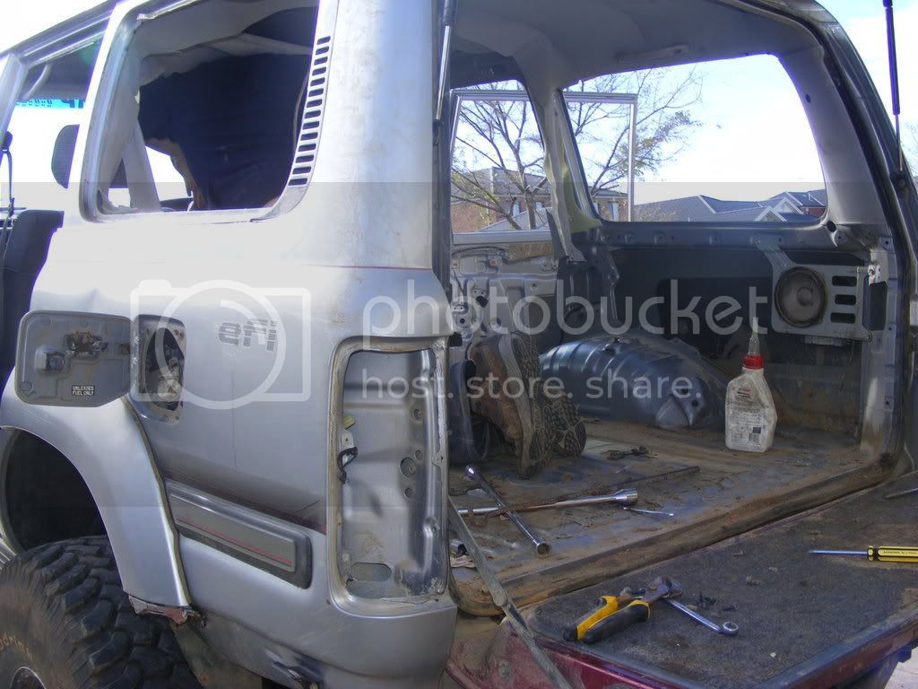

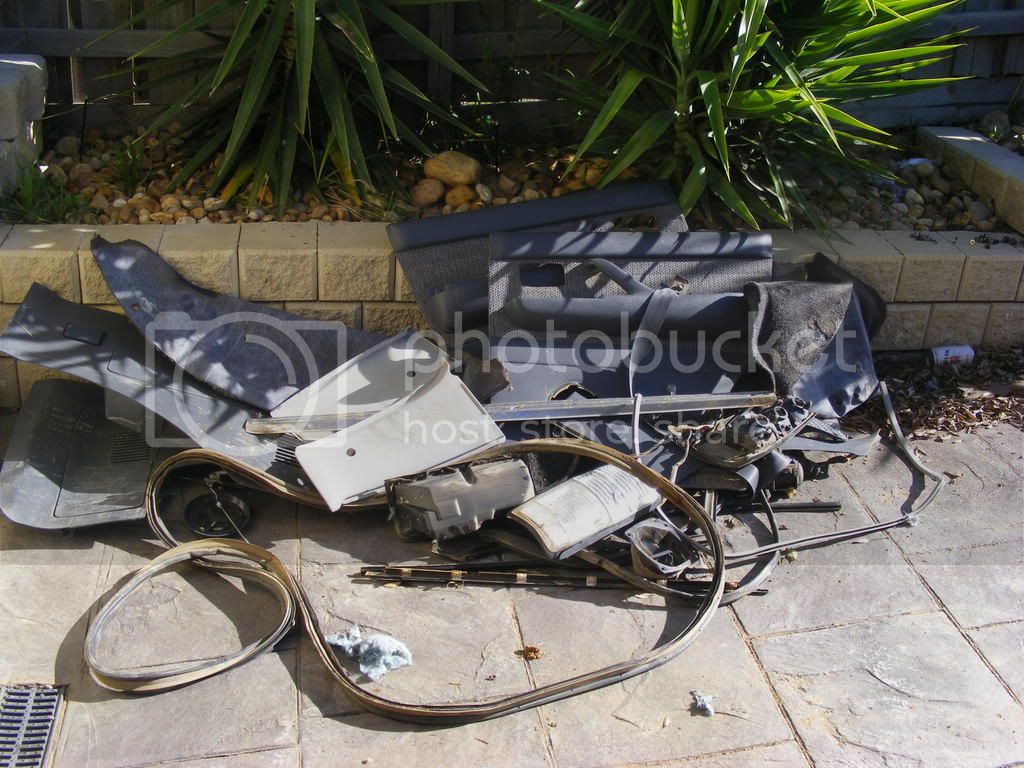

The boggers meant that I was pushing it all a little harder causing some serious panel damage. I also bought front and rear difflocks. So as you can see from this pic I decided to cut it into a ute.
