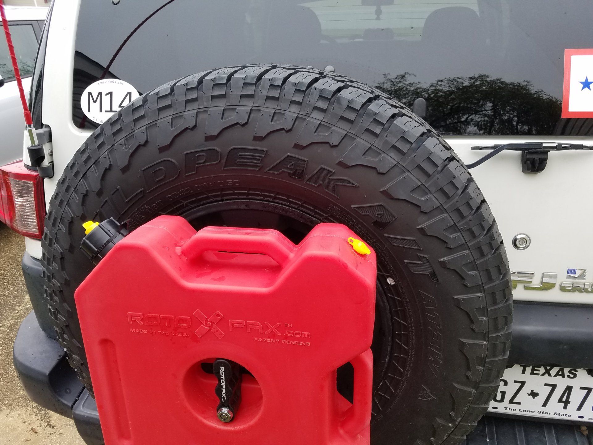

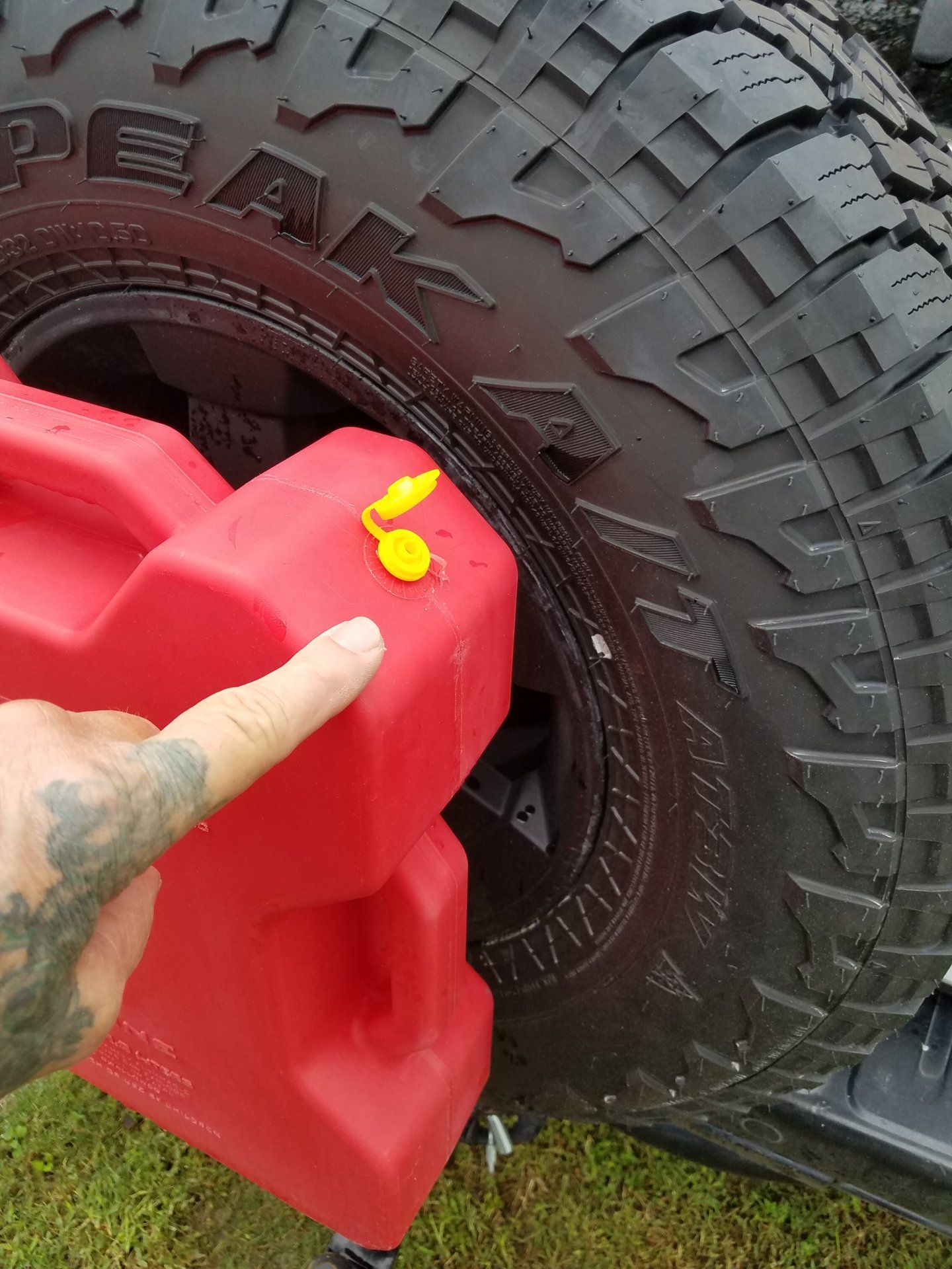

The kit comes with a separate vent. You drill a 1/2 hole where you want the vent and snap it in. Now it works just like the old style fuel cans. When you drill the can be sure and use a step drill. A regular drill bit with make an irregular hole in the plastic and it won't seal.

Ah, it makes sense, now. Thanks for clarifying! That would work well for carrying containers upright - as in your pics. But, might give problems if carried hoizontal, since Rotopax doesn't have the vent or an option to have one. But, you did an excellent install - looks like it came that way! Good tip about the drill bit to use.

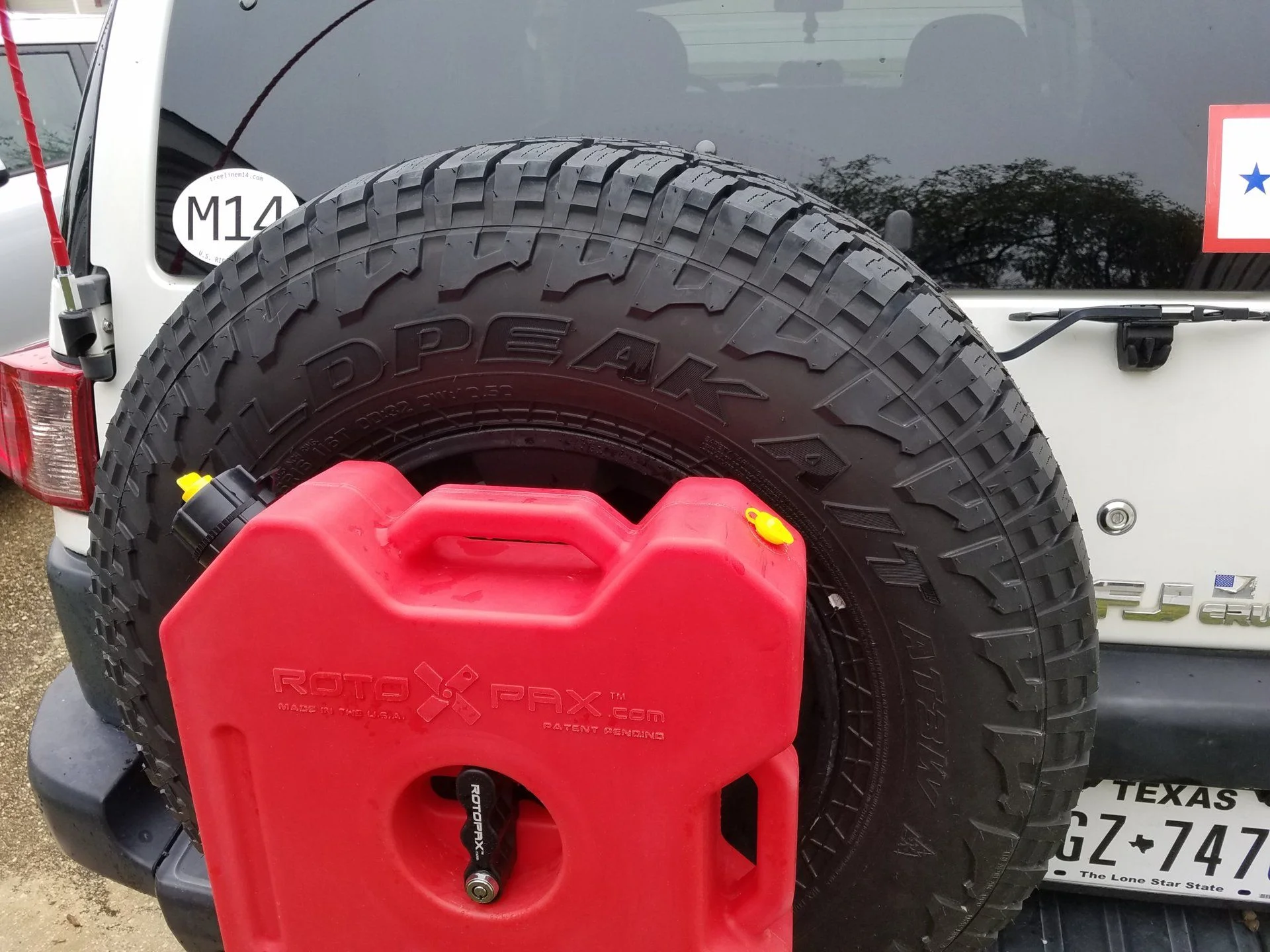

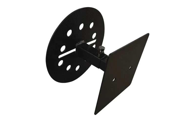

Can you link to the spare tire mount you used for this install?

No link, I made it.
I took a rotopax mount for a jeep spare, welded the back plate inside the tire carrier of the FJ. In retrospect I wouldn't do it again. I have to remove the gas can, then unbolt the plate the tank bolts to, then remove the spare. Kind of a pain
