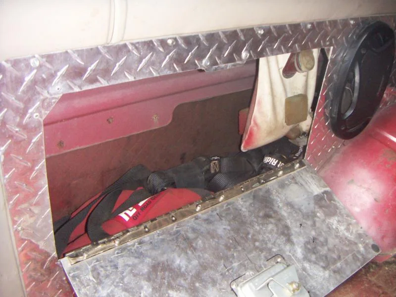

Before it started raining, I went to the big city and bought a sheet of 1/8" aluminum diamond plate. With some cutting, sanding and riveting, I created a solution for the old dingy, buckled interior panels. While the panel was off, I relocated the bracket for hanging the washer bag, opening the space above the well created in the body behind the wheel arch. I now have all my recovery gear (snatch block, chains, straps, tie downs, shackles, Hi lift come-along parts, gloves) carried in a stored position on board. It used to be that I would load this 60 some odd pounds of freight when wheeling, but now it's there 24/7.

That looks great Rick! Any extra 'rattling' with that setup?

No rattles! I was worried about that and took pains to not install noises. Screwing the panels around the perimeter helped. A slim strip of foam on the inside of the right side isolated the panel from the internal body braces. The latch Tee handle is quality: the handle is under constant tension to avoid movement. The latch bracket is formed to pull the door into slight tension when closed. Finally, at the top corners of the panel door, I added stick on pads to keep the rattles away.
After installing I did have a rhythmic "bumping" from the back that turned out to be the washer motor swinging and bumping into the panel, so I glued on a piece of foam to prevent contact.
I have more material and latches to build more storage in the tailgate, and may do this sometime when I feel its required.
