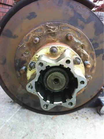

I started trying to remove the disk brake set up from my Donor axle today. Got the locker off and removed the c clip but can't seem to get the hub off. Book says to remove cone washers by tapping the out but they won't budge!! What am I missing ? How do I get the rest of this off?
I think it's generally advised to use a brass drift to transfer a hammer blow to the end of the stud and loosen the cone washers. A couple good whacks and they should be loose enough to fish out.
