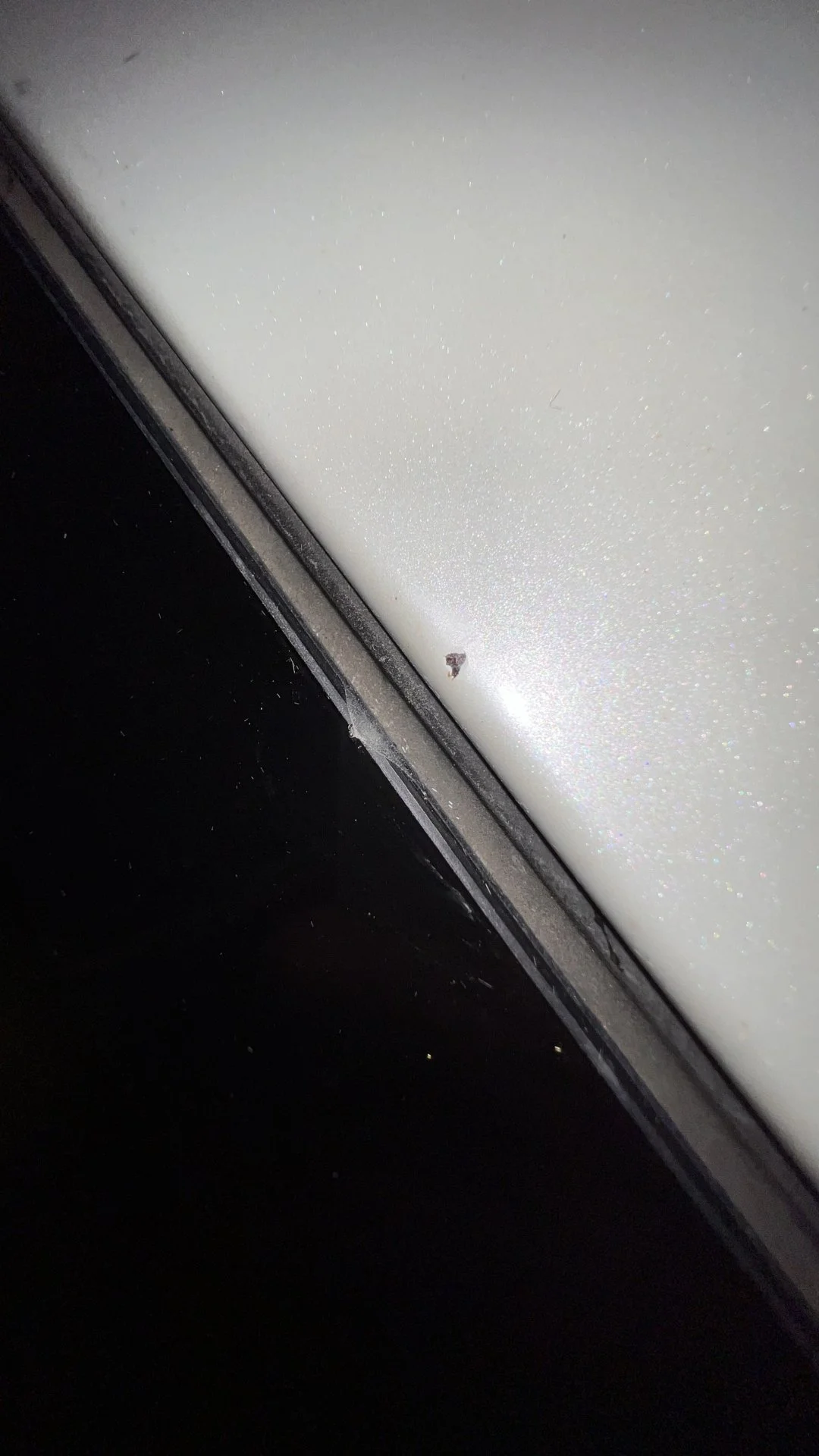

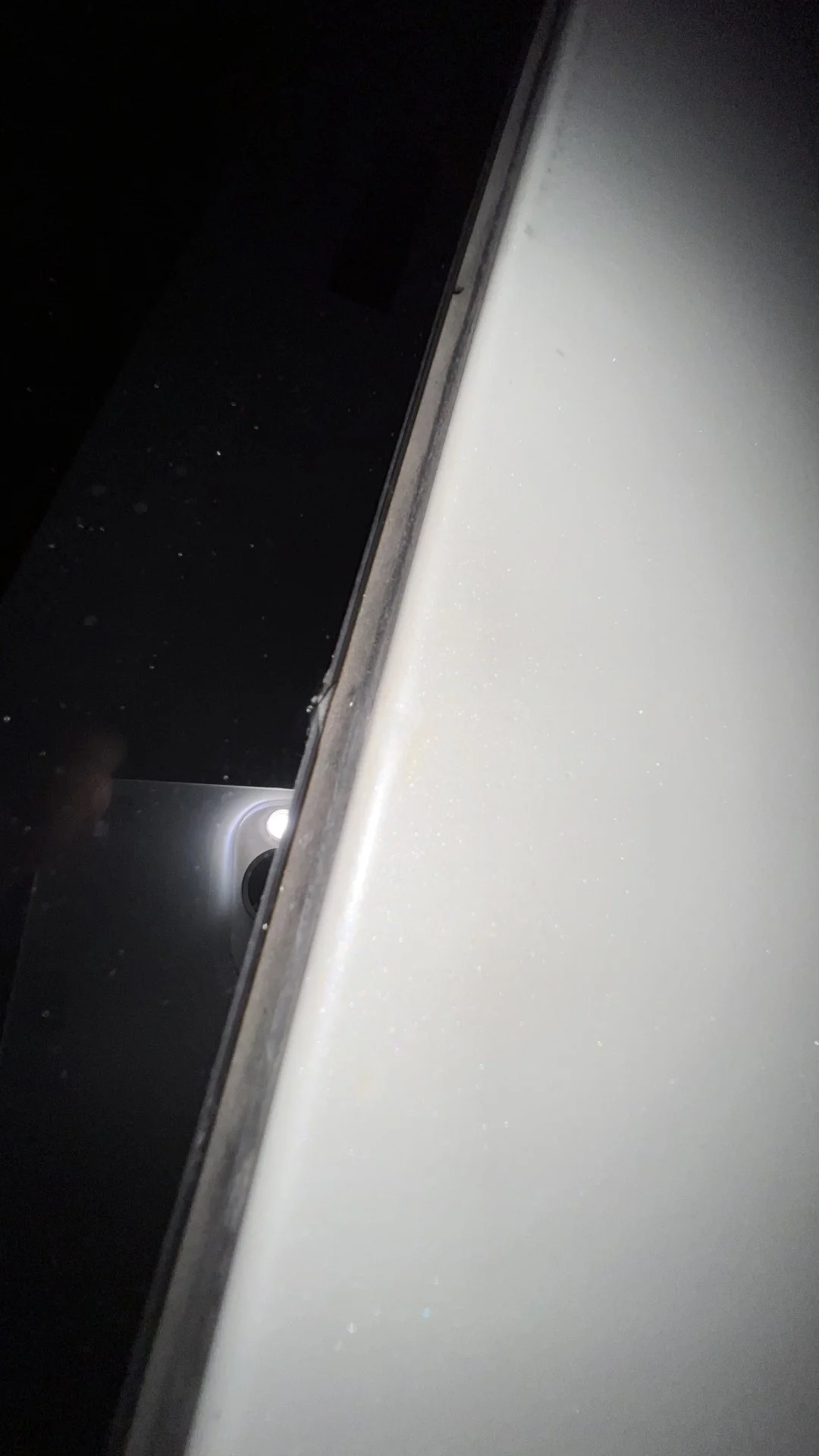

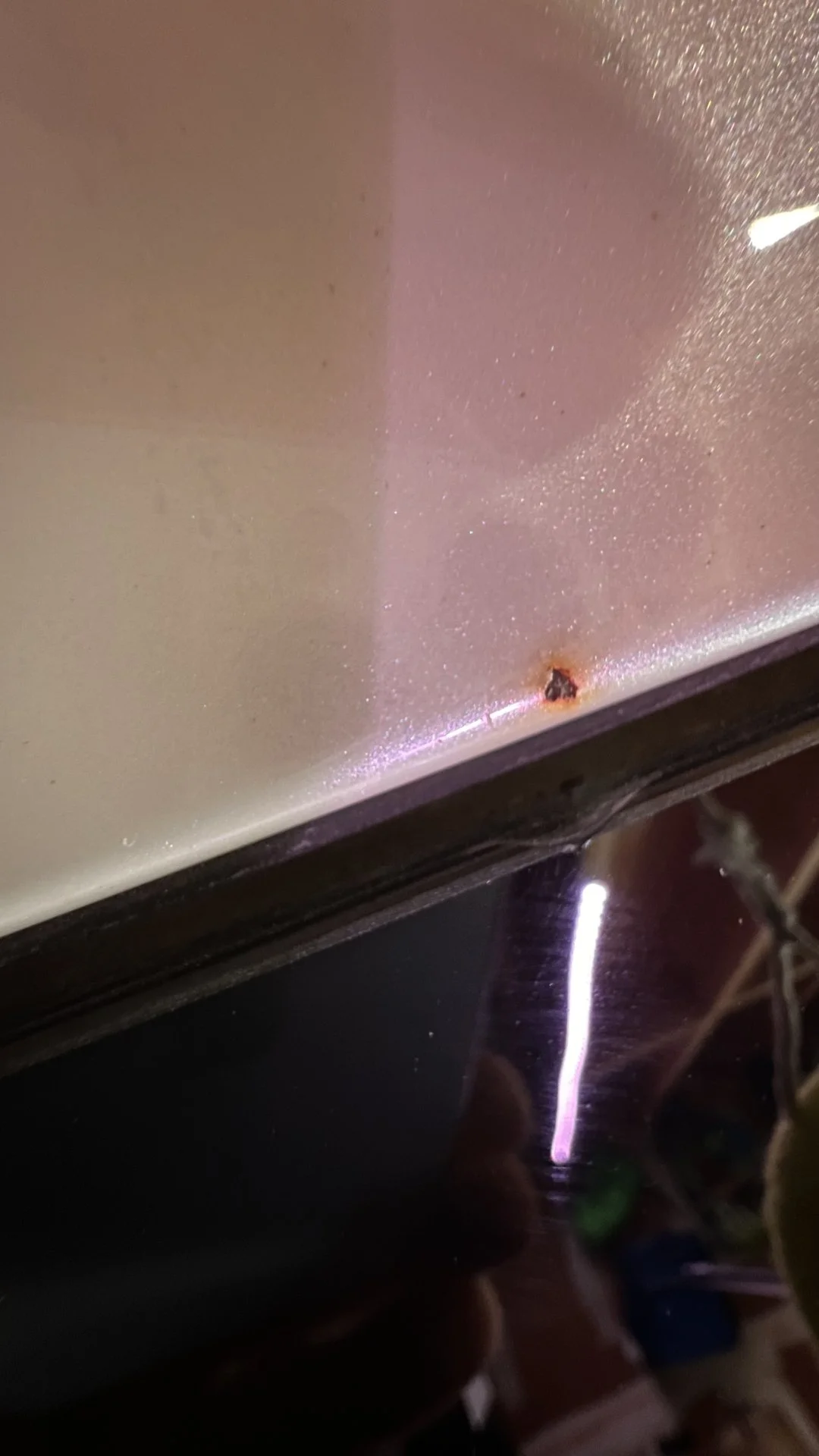

I just noticed this rust spot on my roofline due to a chip from a rock (notice the chipped glass).
Is this something a body shop could fix? Dealer? Warranty? (I have extended warranty on my 2016 with 55k miles) Insurance?
Order the factory touch up paint and bring it to a good detailing shop. They'll have the rust cleaned and spot painted in a way that you will have trouble finding again.
This was a simple paint chip repair. But unfortunately you left it too long and now it is a much bigger job that it would have been.
Warranty not.
Dealer not, unless yours has a body shop; most don't, or if they want to take care of it for you and send it to a local repair shop they work with.
Insurance maybe if you have very low deductible. Although they may say that you failed to take corrective measures in time - fix the paint chip, and now the damage - rust, is not covered.
Go to a body shop and see what they say. There are also mobile paint chip repair shops that can give you an estimate. It will not be unnoticeable but it will look good enough and more importantly it will get the rust out and prevent further damage.

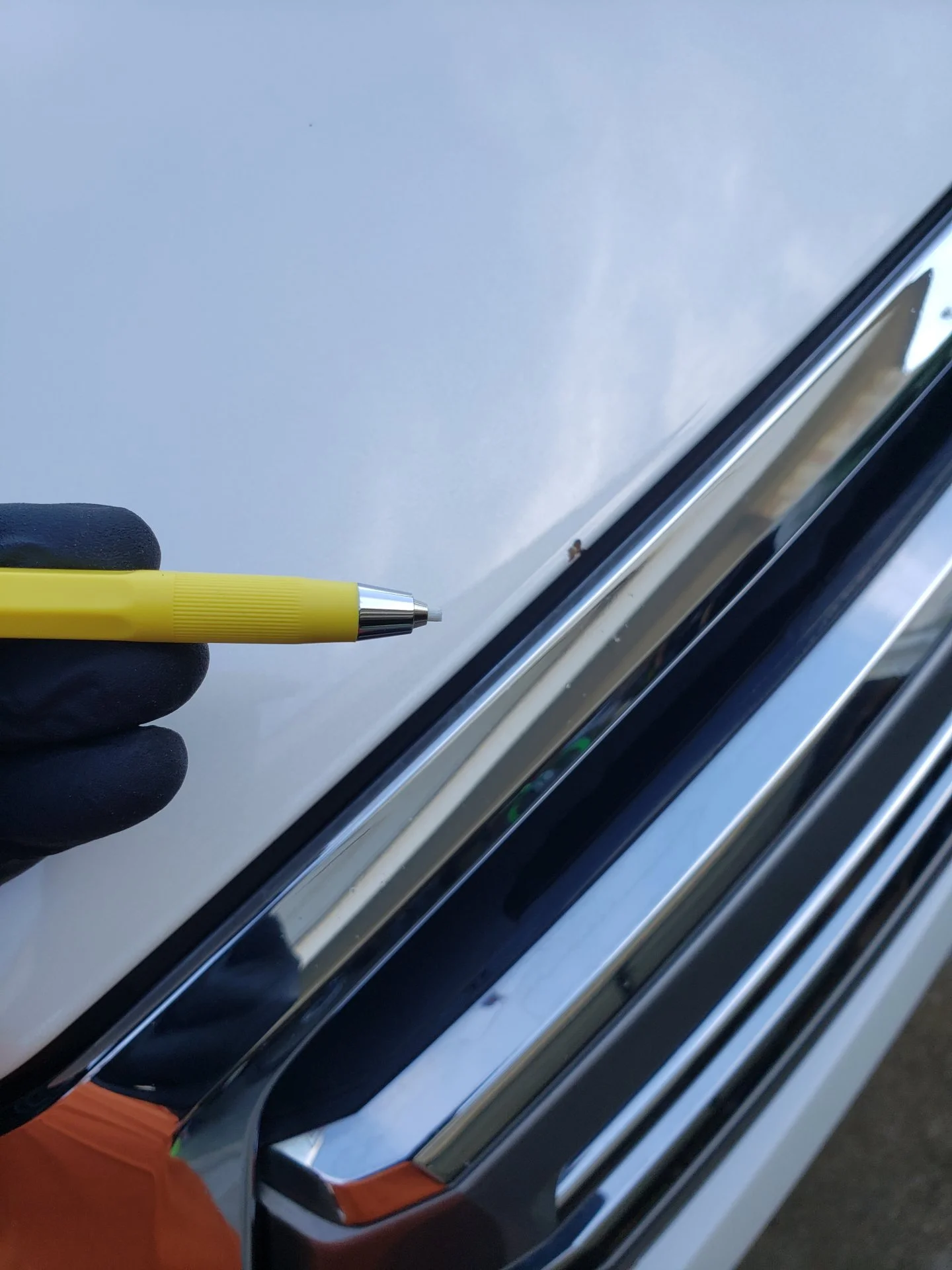

For more convenience, that's "good enough", use one of these fiberglass pens (wear eye protection) to easily remove the rust with precision, only as much paint removal as needed. Then spray some Rust-Oleum auto primer in a small container so you can brush it on (tiny brush), then use color-matched Dr. Colorchip (search for YouTube examples for how to apply by smearing w/ gloved finger) - the package that includes their sealer / smoother / polisher. The paint doesn't match tri-layer pearl colors perfectly and the fix is noticeable, but pretty good.
Amazon product ASIN B002RMCFZM

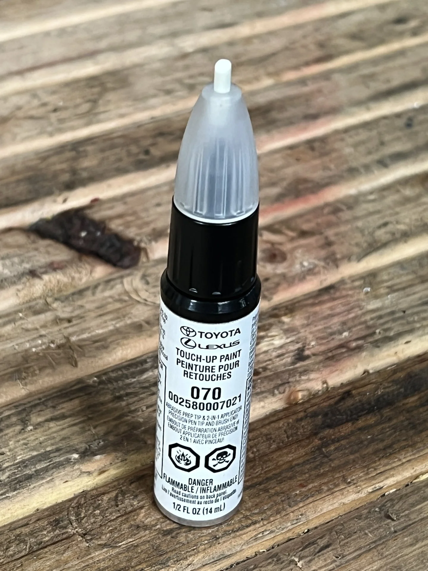

The OEM touch up paint, which does match the blizzard pearl other than the clear coat, has a fiberglass pen built in to the cap. Also I've repaired a few of these and no primer is needed. It is designed for this exactly.
And it's not very expensive. Any dealer can look up the paint code by VIN or you can do some digging from the ID plate in your door sill to find it online.

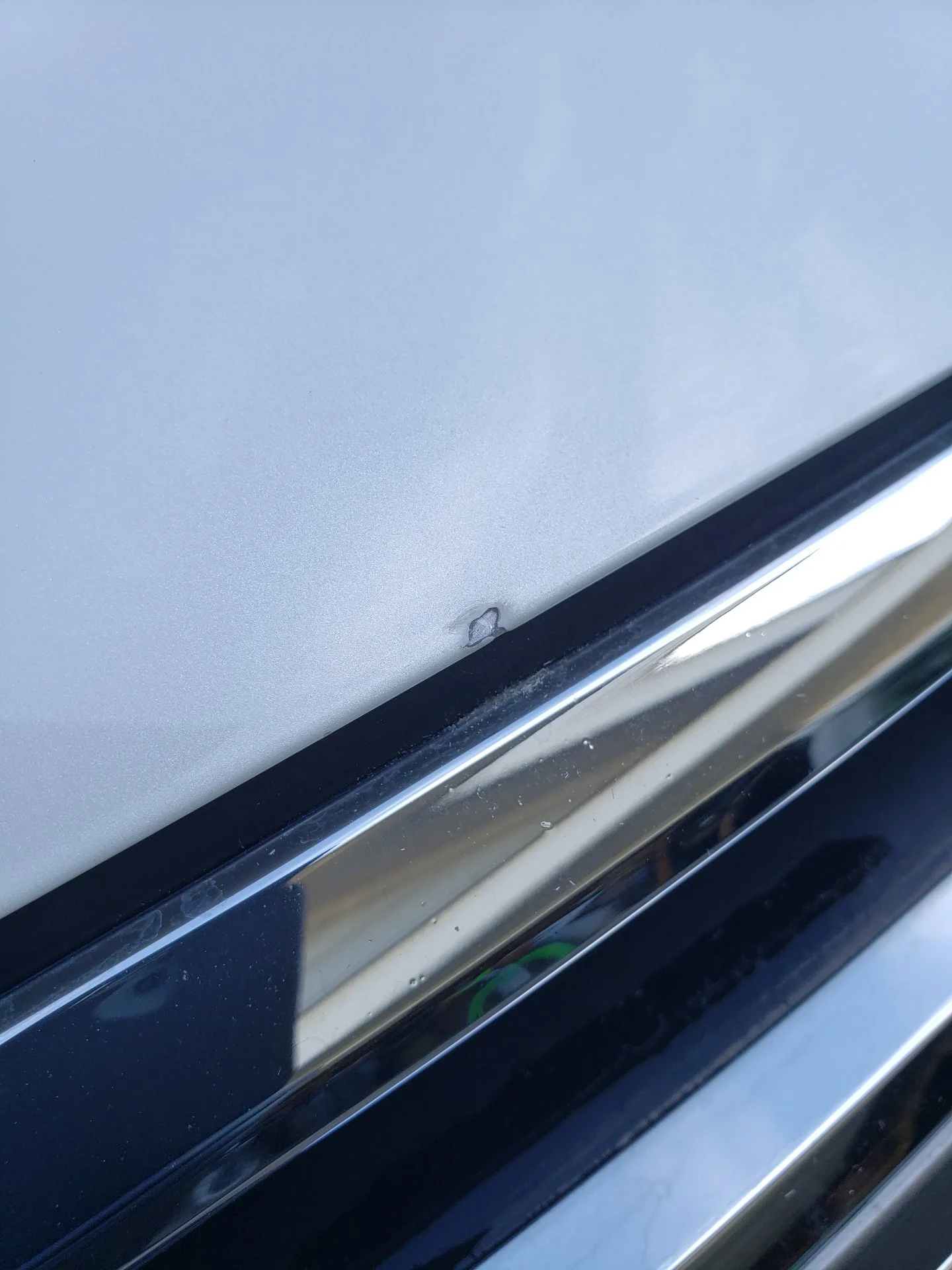

Mine didn't have as much rust as this post though.. so you would want to find a chemical treatment or other way of dealing with that.
I have one similar on the leading edge of my hood and it's underneath the 3M protectant as well, it's extremely frustrating. I have no idea how I'll go about correcting it, but it's going to spread if I don't get after it soon. These Toyota's have the least durable paint on the front of a vehicle of any modern make we've owned, it's pathetic.
Thanks for all the tips. I wish I had see. It when it happened. That’s what you get when you don’t wash your own car…
I’ll start with the fiberglass pen and see where it goes. I have touch up paint so I’m good there
