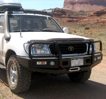

Right, with the 1" cross bars you need to add some type of spacer to make it work- doesn't have to be the true 1.25 OD but enough so the clamp tightens up with some load, before it bottoms out on itself and runs out of travel. What works well is a piece of sprinkler tubing, thin rubber (garage door gasket, or the stuff you get with bike lights), even foam pipe insulation. it's a rig, yes, but for me I don't keep my accessories on all the time so I just need it snug for the trip, then it's off.. I keep the top clean most of the time for less wind drag and to make it easier to haul other stuff, usually other roof racks.. :rolleyes:
I just got back from camping, and took my mountain bike. I forget what these are called, but it's the kind where you leave your front tire on and that arm swings up to grab the down tube. Anything that sits "on top" of the bars will work, which leaves out some of the bike rack options (like Rocky Mounts), since all the cross bars are fixed at 10.5" spacing.
And all the rocket boxes, space cases, and most RTT's have u-bolts that slide on tracks, so they're obviously less of an issue and bolt right up in just about all cases.
You can see the Thule box and Yakima fairing here:
And here are your Yakima bike rack pics: :popcorn:
One more of the Thule box.. you can see the U-bolts pretty clearly, also quick tip I got this roll of Velcro straps from the Depot, and use a couple of those little guys on the sides around the u-bolt, which keeps the box from sliding sideways. This worked well last month in Moab, I wheeled for a week with 2 guitars, 2 fishing poles and a tackle box up there, and the thing never moved. I'd recommend those little straps regardless of what rack you go with. :beer:
