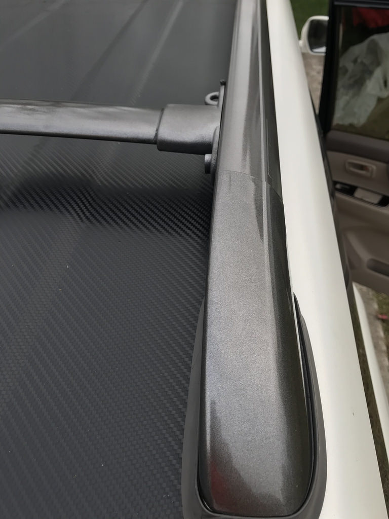

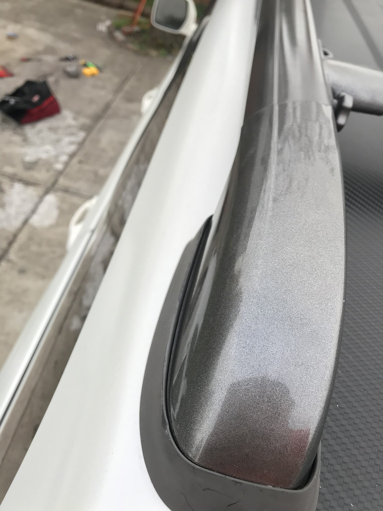

I sanded my down then hit it with some wheel paint, charcoal graphite metallic. Then I cleared it with 2K clear coat, a single can clear both racks and bars. Looks real good now, I’ll post pics when I get home. 2K clear is expensive. $22 a can but it’s as close to autobody quality as you’ll get in a can.
Here's a pic of what my roof rack paint and 2K 2 stage clear looks like, it's a lot shinier in person and feels like automotive paint.
Make sure after you remove the bolts from the rack, is to apply some silicone to the screws so that rain water doesn't get into it. Prep it well with sandpaper and clean with alcohol before paint. that 2K clear is very hazardous so have a good mask and/or paint it outdoor with ventilation, it cures in about a day at 70 degrees then you can reinstall the rack.

I started sanding the rack with 180 grit, to get all the gunk and flaky paint off, then i hit it with 320 grit and cleaned it with rubbing alcohol and just shot it with 3 coats of paint after it dried. I waited 5 minutes between each coat, ambient temp was 78 and sunny that day so it was drying quick. Then after the 3rd coat i waited 30 minute and applied the clear, 3 coats of that, 5 minutes in between coats then let it dry over night.
Yeah i painted the cross member and the rack, it's mostly for looks i barely use it except for loading my kayak.
When i removed the rack there were a few rusty spot, i hit it with a paint stripper wheel attached to my drill until it got to bare metal and then i treated it with rustoleum primer sealer and just shot some paint on top after.

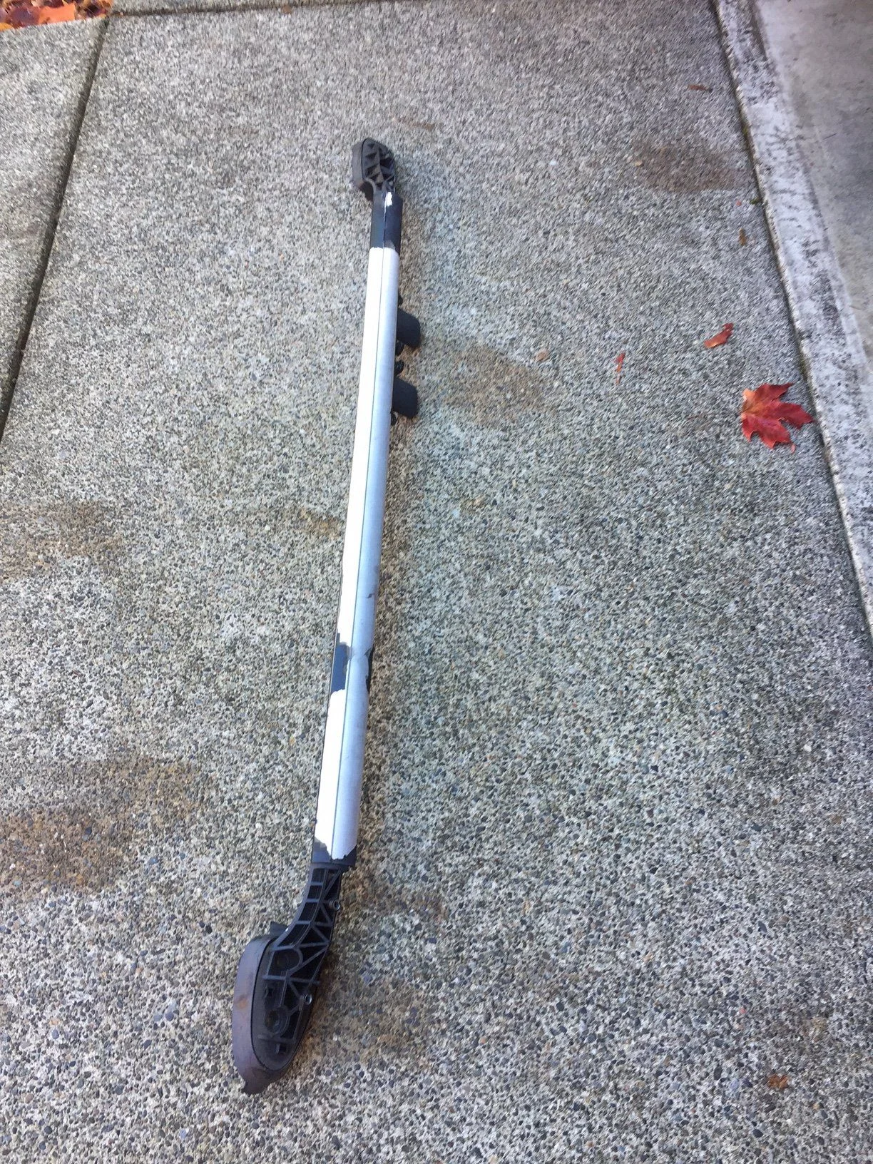

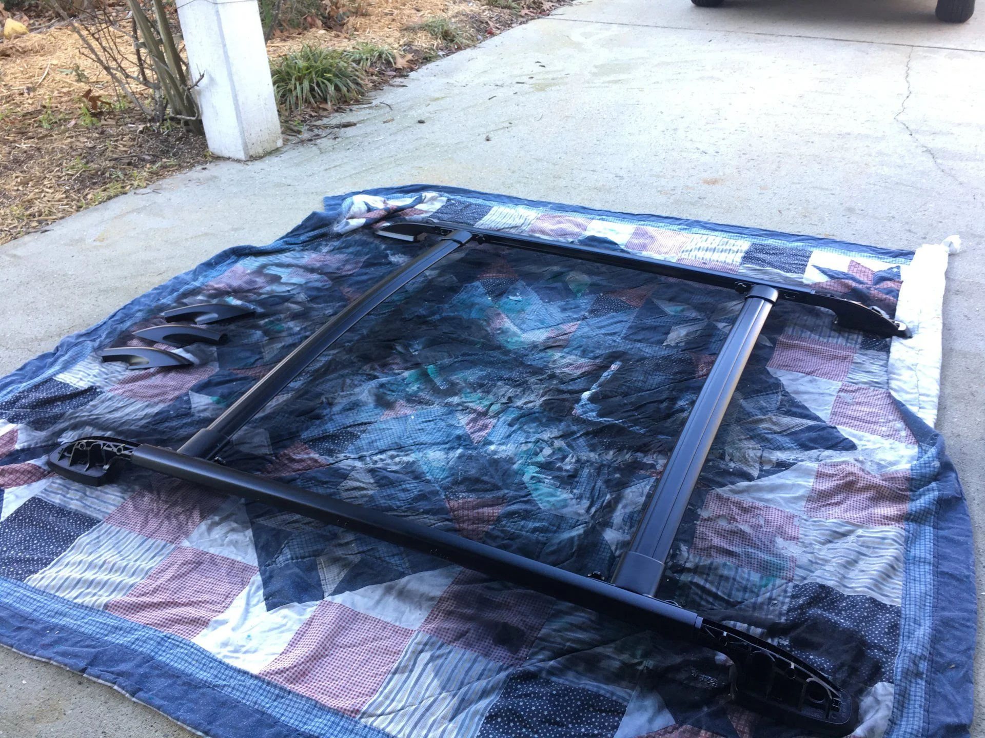

One more - so i bought an LC rack off craigslist because my rack was missing one of the cross beam screws.
So i paid $20 for a screw, but thought it was worth it because you can't get the screw and now I have extras.
I've noticed that the rack I bought has three footings per side (front, middle, rear), while mine has 2 on each side (front, rear).
if you were me, which one would you go with? Does the additional footing give me much benefit? Just seems like better weight distribution across the rack, which claims according to the factory sticker that it has a max load of 150 lbs.

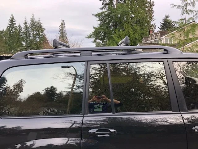

Sorry for the delay, forgot to check in for a couple weeks. Below! A couple of quick thoughts:
1. @FxFormat was right on with the wheel paint/2k combo. I've really enjoyed the outcome, and the matte finish is perfect. Not shiny at all, but still looks good, which is what I was hoping for. My goal was for the rack to just have a uniform black appearance.
2. That said - I did the painting quick, probably too quick. So I have some 'drips' that dried in place because I wasn't paying close enough attention to how much product I was spraying. One can of wheel paint and one can of 2k was plenty for the entire rack. @FxFormat has a better end result compared to mine. Mine hides better because its black, which kinda saved me.
3. My only additional suggestion would be to start with an even lower grit (one step grittier than 180), and strip the original paint as fast as possible. I was getting impatient, 180 was moving a bit slow. I also sanded everything (even the plastic parts) and repainted everything.

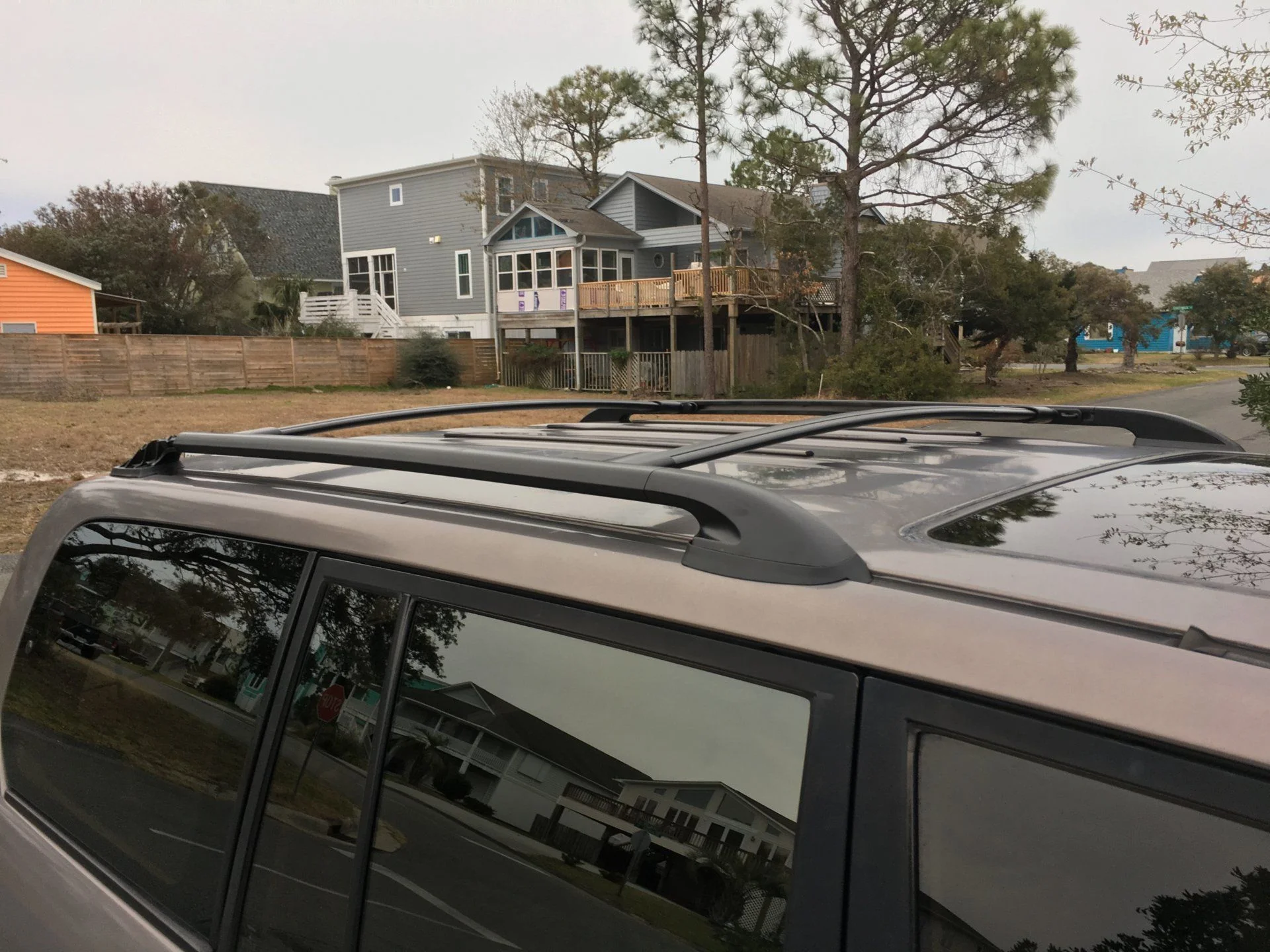

@Gnarwgn Great scoop, buddy. The matte finish appears to be a good pair with the the side window trim black...I was thinking I needed a glossier finish, but the clear coat appears to do a good job of accomplishing the finished look. Going to give this a try. Thank you for the recommendations.
