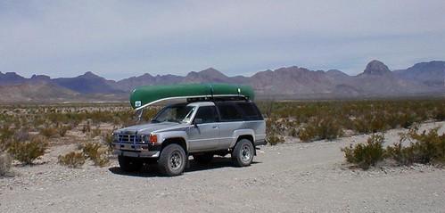

I put a roof rack on my 88. I'd recommend making the holes in the front very close to the front of the fiberglass... a few inches back and it get's very thin... about 1/8 inch. In the rear it was about 1/2 inch thick. I made feet that extend all the way to the front edge of the fiberglass to put the rack/cargo weight there and put the bolts about 2 inches back.
I made the rack because I didn't like any I saw available... I made it low profile, it adds only about 4" to the roof ( i meant for it to be a little shorter..)
It has held up perfectly. Carried a lot of cargo and canoes to some rough places and never cracked the roof.

I'll see if I can take some photos of mine tonight and I'll show you where I drilled the holes and how I made the feet.
I've put my spare on the roof a couple of times... you can feel the weight up high when you turn.:steer: a kinda tippy feeling.
EDIT... BTW, I made this 8 years ago and it was my second welding project... it could be better designed, but hey, it works. (the light bar was kind of a hokey after-thought with a spare piece of angle..)
You can see where I put the holes in the roof and how long the front 'feet' are...
