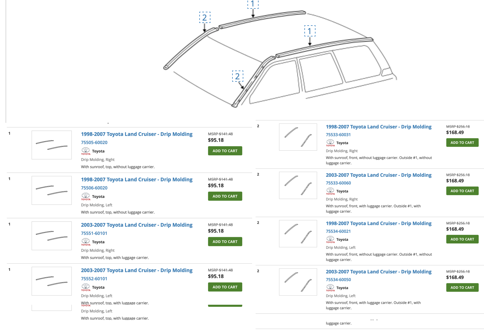

So I notice that if you look here at the parts diagram (for 2007 LC). Toyota describes a part #1 (roof molding) and #2 (windshield molding). They list a sunroof/luggage carrier sunroof/no luggage carrier variation for each.
Does anyone know what the difference is between each part respectively?
If I had to guess (and I was just doing a roof rack swap on my 2004 100 series that involved wrestling with that drip moulding), the trim for a luggage carrier has windows cut out that expose the bolt holes for the factory roof rack. The trim for a roof without a luggage carrier will probably be solid from end to end without any windows.
