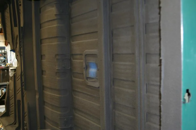

I got all the glue off, then painted on Zero Rust, before spraying the Lizard Skin.

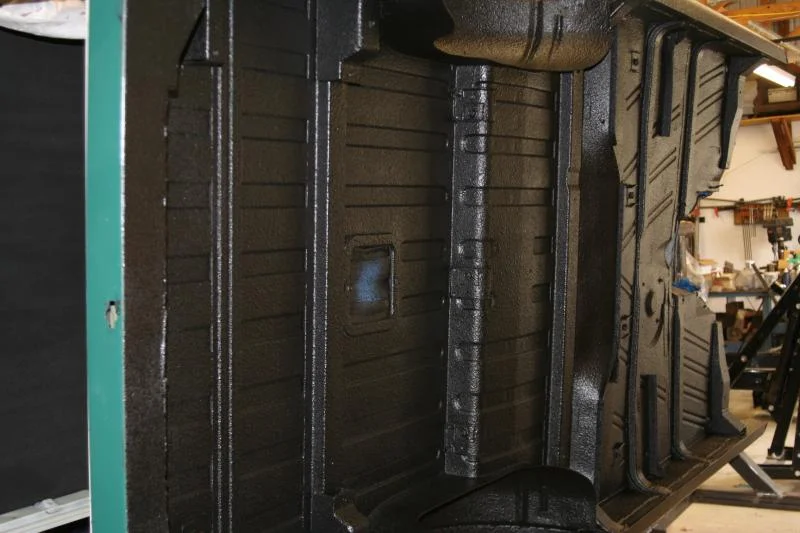

Two coats sound deadener

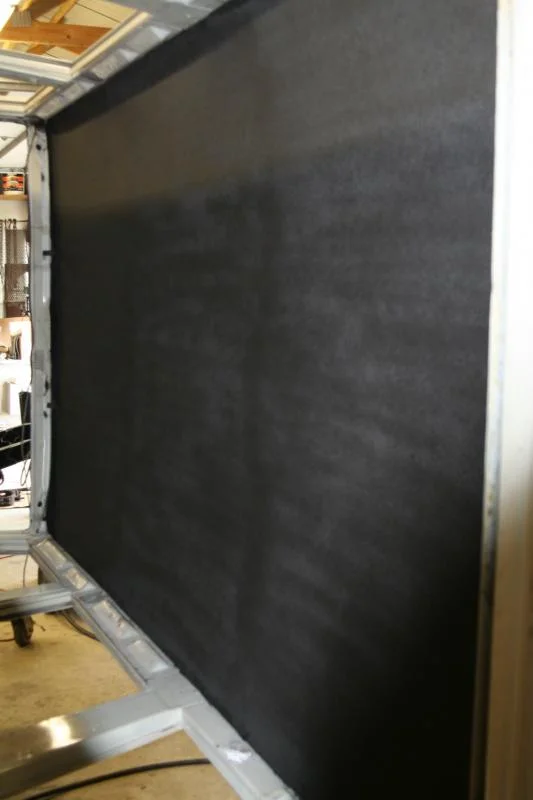

two coats ceramic insulation

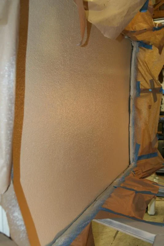

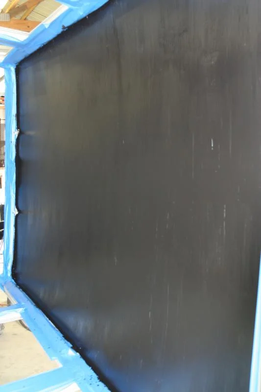

@ six coats tinted monstaliner. Tinted Cygnus White and it didn't want to cover the black.
I did learn they have a white Creamic insulation, that would work better, if covering with the white paint.
