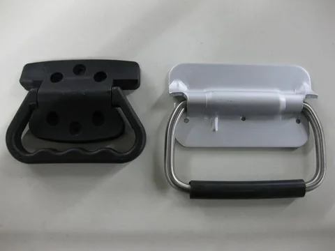

Comparison and install of new beefy handles. Always tricky perfectly lining up holes, but it worked out.:)
Using old handle to mark holes....
And...wala!
Nice work on the handles. I thought they were kind of pricey at first, but I can't even find anything like them on the internet. Plus it looks like they will be quiet if you tie down your cooler with another method.
It's too bad the OEM handles are so cheesy and edgestar doesn't sell upgraded handles (they sell upgraded hinges though). I was careful picking mine up empty, definitely would hurt your foot if the handle broke and you had to drop it.
Yup, these are sprung very well and hold tight to the wall. Seems they would work just fine as a tie down too.

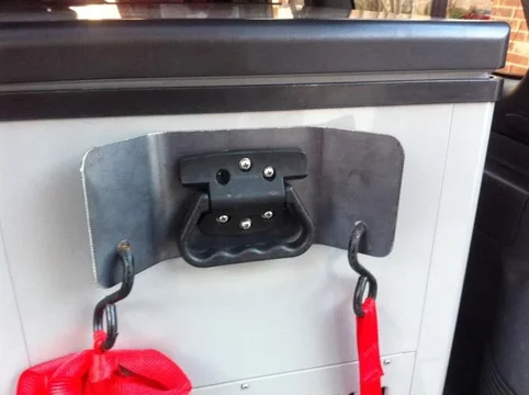

I made a tie down bracket today, copied from Expedition Portal thread. I used 12 gauge, 4"x10" pieces. My father works in the galvanizing industry, so he had one of his customers cut the pieces for me. I bent the sides at around 2.5", rounded the corners with a grinder and de-blurred everything.
One of the handle screws would spin but would not back out, the insert was loose from when it was installed. I tried yanking on it a little but it wouldn't budge. I was able to slide a hacksaw blade in there, that was the hardest part of the job.
Looks good. Still debating on the $40 handle upgrade, found some heavy duty ones on eBay but they're not spring loaded and sort of ugly but they're also $10/pr shipped.
Do you plan to use the handle as an anchor? If you are, I'd say go for the $10 handles if they are study. They won't bounce around if they are tied to and have tension on them.
