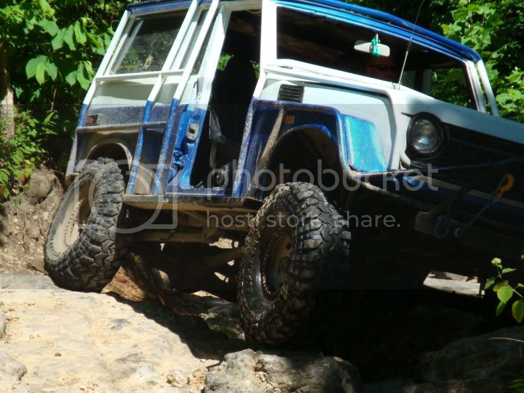

I have an interior loop too. I wanted a place to mount the shoulder harnesses and a triangulated hoop in case of a hard barrel roll. The exo just can't have good enough lateral strength. It also ties into my rear shock hoop and supports a shelf just below the height of the tail gate for reachable storage.
It is behind the B pillar because there is no room for my shoulder and the B-pillar. It would completely intrude on the back seat if I had one. I thought about running one inside the B pillar had I kept it a 4 door.

That is one heck of a cage!!!!! I am kind of thinking about something to mount my seat belts to. I don't plan to get up that path you are going.
What a scene to be in that spot from your picture. How long did it take to get outa there? Did you go foward or backward?
