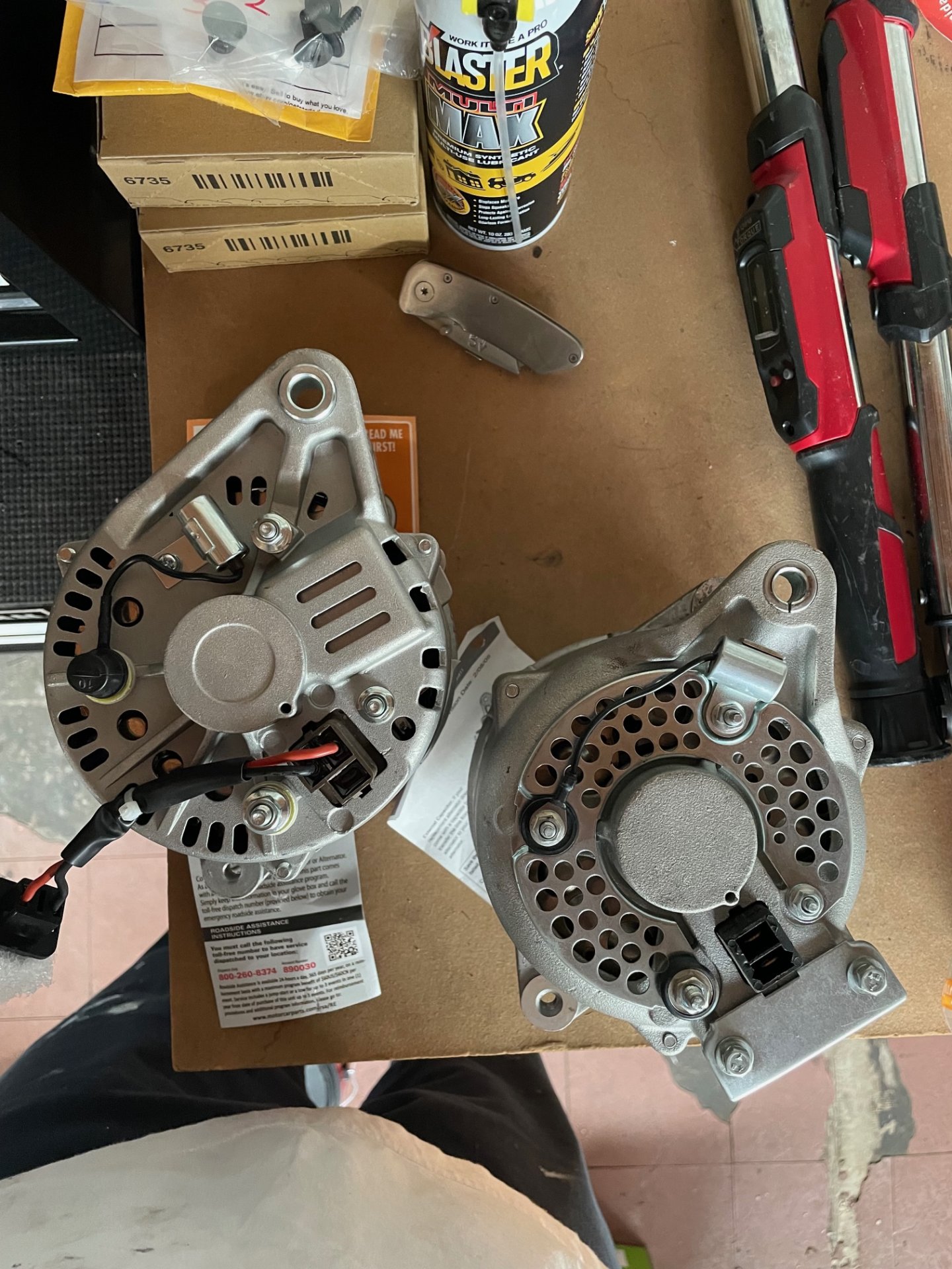

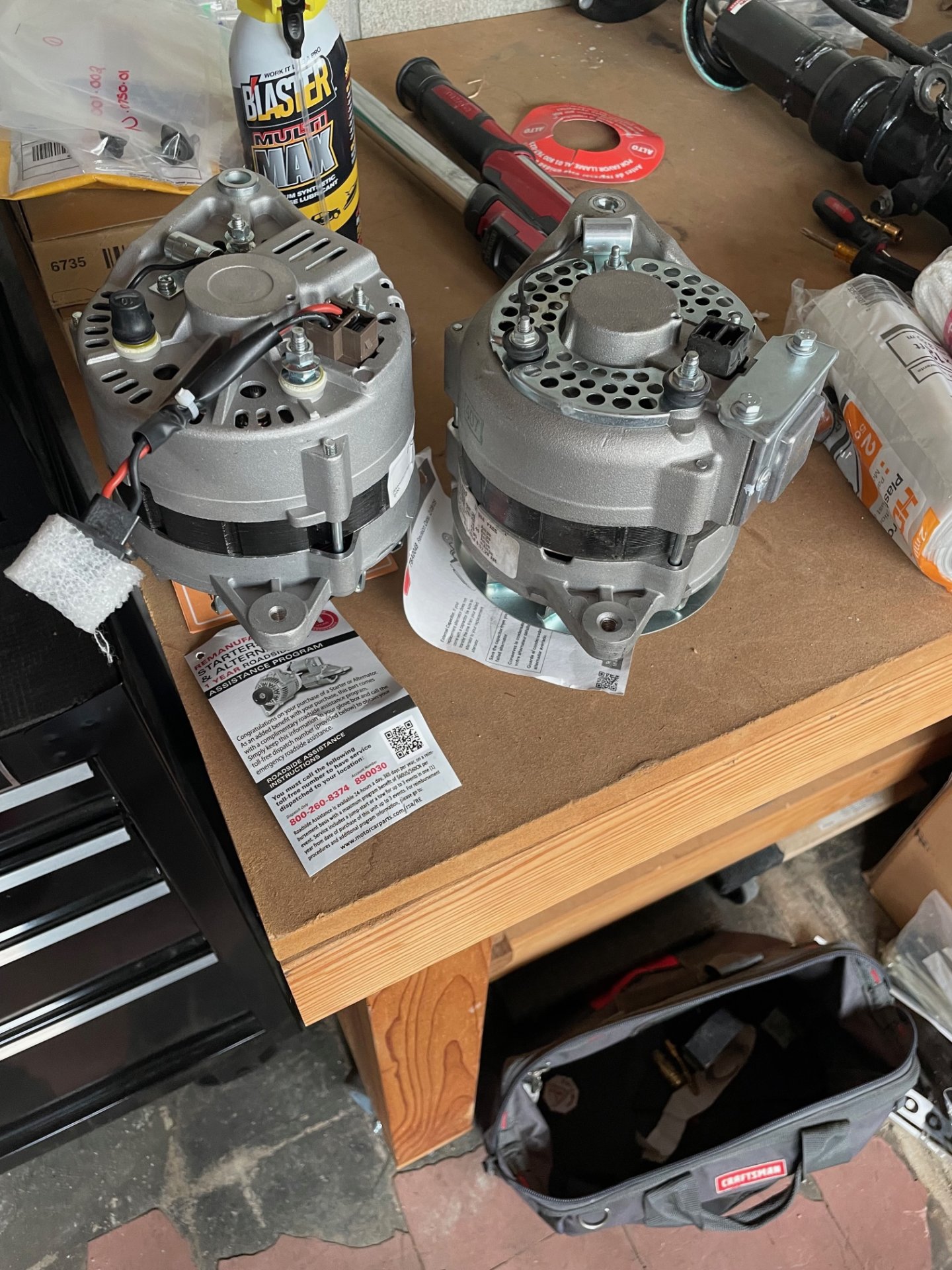

Ordered this alternator from Rock Auto. It should be a 55amp with an internal regulator at 2:00. However, what I received (pictured on the left below) doesn't seem to have an internal regulator, at least not in the way I'm used to seeing them. The part number listed on the alternator is what I ordered, but before I submit the issue with RA, I just want to make sure I'm not missing something here.
They did the same thing to me. I sent it back. I know it will work but there are too many adaptations.
View attachment 2863000 View attachment 2863001
I was also just sent this bizarre alternator. It is totally not what I ordered. I have an exchange set up, but now I know they will just send this same one back! Is it possible that the voltage regulator is inside where that rectangular part is (with the three long cutouts)? If so, that makes it not easily replaceable, if at all. Also, what is with those nuts on either side of the rectangular part? Is something supposed to be mounted there, or is it holding the VR on inside? They turned a three wire into a two wire with a pigtail which they probably think makes up for sending 10 o’clock’s as 2’s. Was this an external one before? If anyone has tried to use one of these, please let me know before I send it back! I’m planning to rebuild my original, but wouldn’t mind a spare if it won’t fry my wiring. It’s part number 14340, they must have run out of rebuildable cores.
UPDATE as of 03/18/2022: I took the plunge and installed that weird alternator from Rock Auto because I was desperate. It installed perfectly and easily (had to swap the pulleys which was like butter with my impact air tool and a glove), and it worked great for a few days, but once again the intermittent charging problems started again. It turns out that my battery ground wiring OR fusible link terminals were just microscopically tarnished or not getting a good connection (also a now fixed leaking radiator possibly spraying them with an undetected mist). When I disconnected the wiring to install the weird Rock Auto alternator, that was enough to jar the connections back to life until it would get below zero (weird) and then the alternator would just cut out on me and stall while driving, but restart and run fine once slightly warmed up. It was super sucky. I once again took all of the connections apart, cleaned them with super fine sandpaper and it has worked perfectly ever since! I would not hesitate to install this weird alternator and I see a new fusible link in my future. I'm also rebuilding my old alternator for a spare because I kept it because it is worth more than the core value.

Very likely the original alternator you got from Rockauto would have worked just fine. I would say that most modern alternators have the V reg hidden inside. The toyota ones with the V reg box bolted to the outside were first I had seen like that in quite a while.
Just an update for people who come across this looking for answers:
The RockAuto Alternator (in OP picture), is a MPA 14340 also sold under Pure Energy 14340 and many other brands: MPA Electrical (itself), Remy, Terrepower (formerly BBB Industries), Quality-Built, and Duralast are all the same unit with 14340 part number.
It's an Internally regulated NEW alternator from China, though it says remanufactured on the box and unit sticker.
It will bolt up just fine and plugs in with an included pigtail. It does not look anything like the OE unit, but works fine, bolts up properly and is 55 amps per MPA tech support. It comes with a two-grove-pully and the single groove pulley should be swapped over, but you can use the INNER groove pulley in a pinch, but it is 15mm, not the 17mm of the stock pulley. If you use the two-groove pulley, the belt will sit a little proud, but work fine.

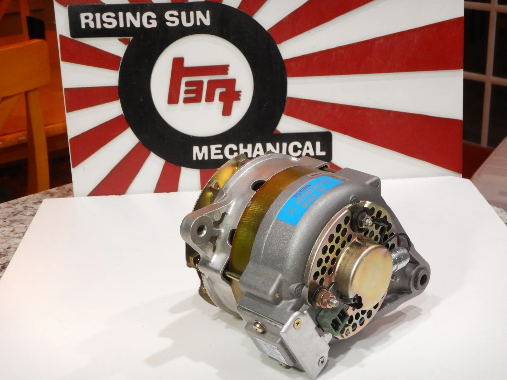

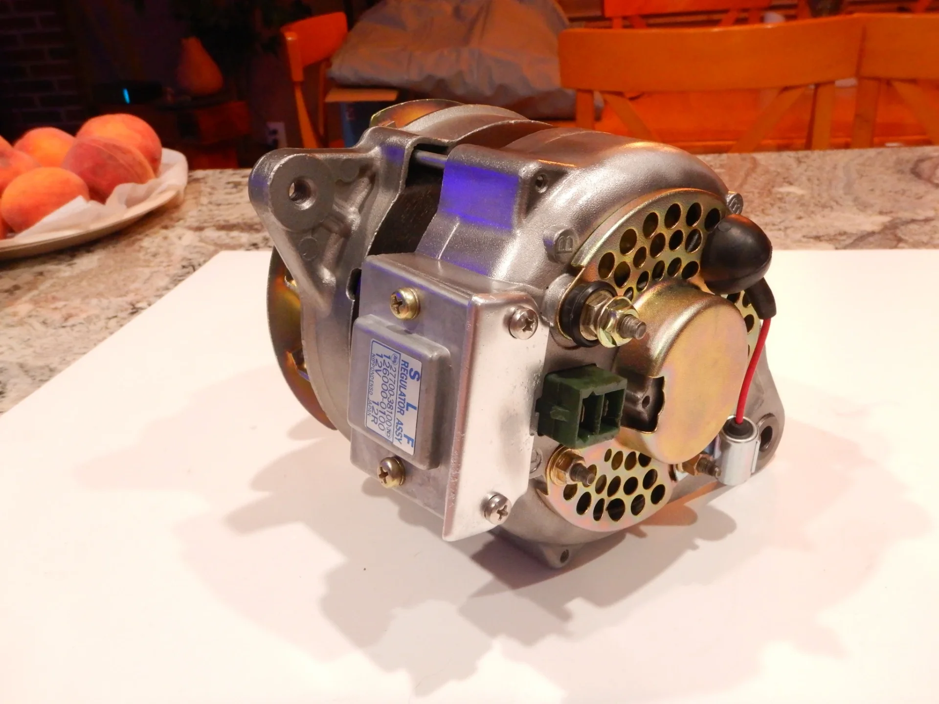

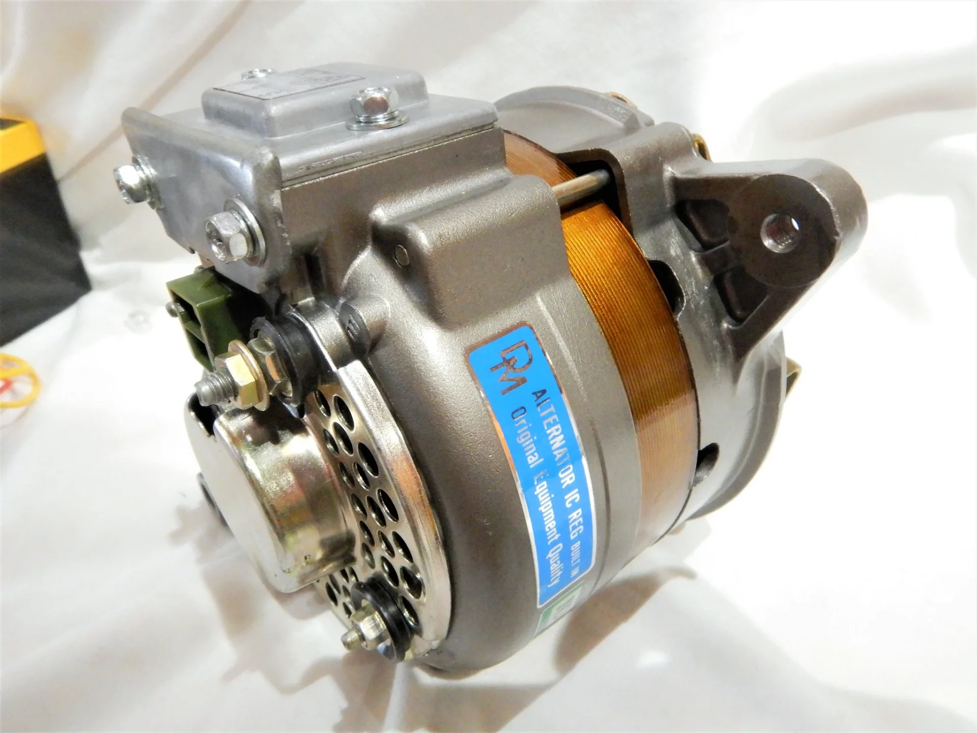

@DrRock installed something similar but looks like a better unit. Unfortunately, that model # on the sticker just leads to a 10 o'clock version of the stock alternator which is really used on non-usa versions and early Celica. Be nice to find out what the actual part number is of that unit....
