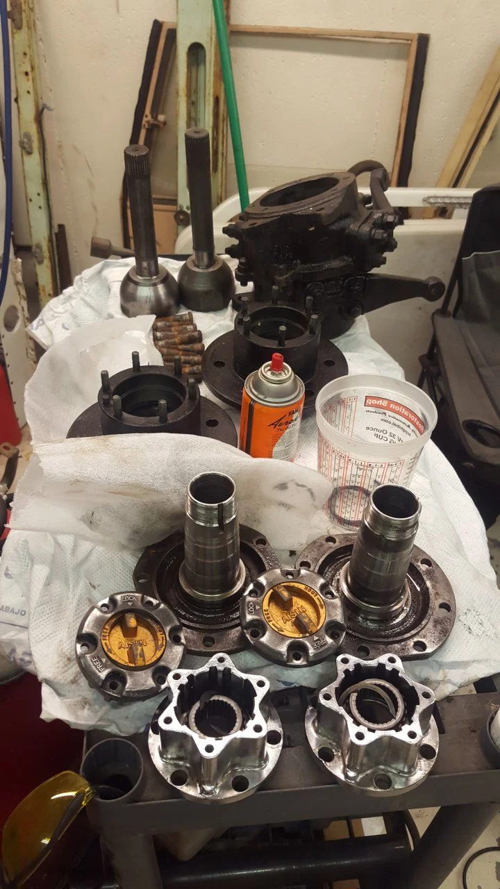

Cleaner parts, how someone can get stainless tarnished is beyond me. Waiting on correct birf, not really a prob since I have spares but got wrong length with parts pile
Will re blast and paint knuckles, not happy with them. Ordering rotors etc next week need to go thru my parts list for correct hoses to bypass backing plate. Cannot remember what I ordered. Calipers will come from local to avoid core charges.
Evan, knuckle rebuild kit is on the way. we need to touch base after new years to discuss your build and get started on the front axle. probably easiest if you bring the donor axle to my house. we can clean and strip it one weekend. I will paint the donor and knuckles, then we reassemble. I have everything but rotors that fit that era but let me do some research if later pressed rotors will work or not. In the arsenal i have a new master, new upgraded calipers for the front, new soft lines all the way around and new rear calipers and rotors. We will need to goto Kelly's to have the rear rotors machined and order some brackets from Poser for the rear disks. You get that thing started yet?

up to you my friend. I can get both front and rear axles all cleaned up and painted with disks on them. No need to do hard lines or master until they go on the truck tho.
