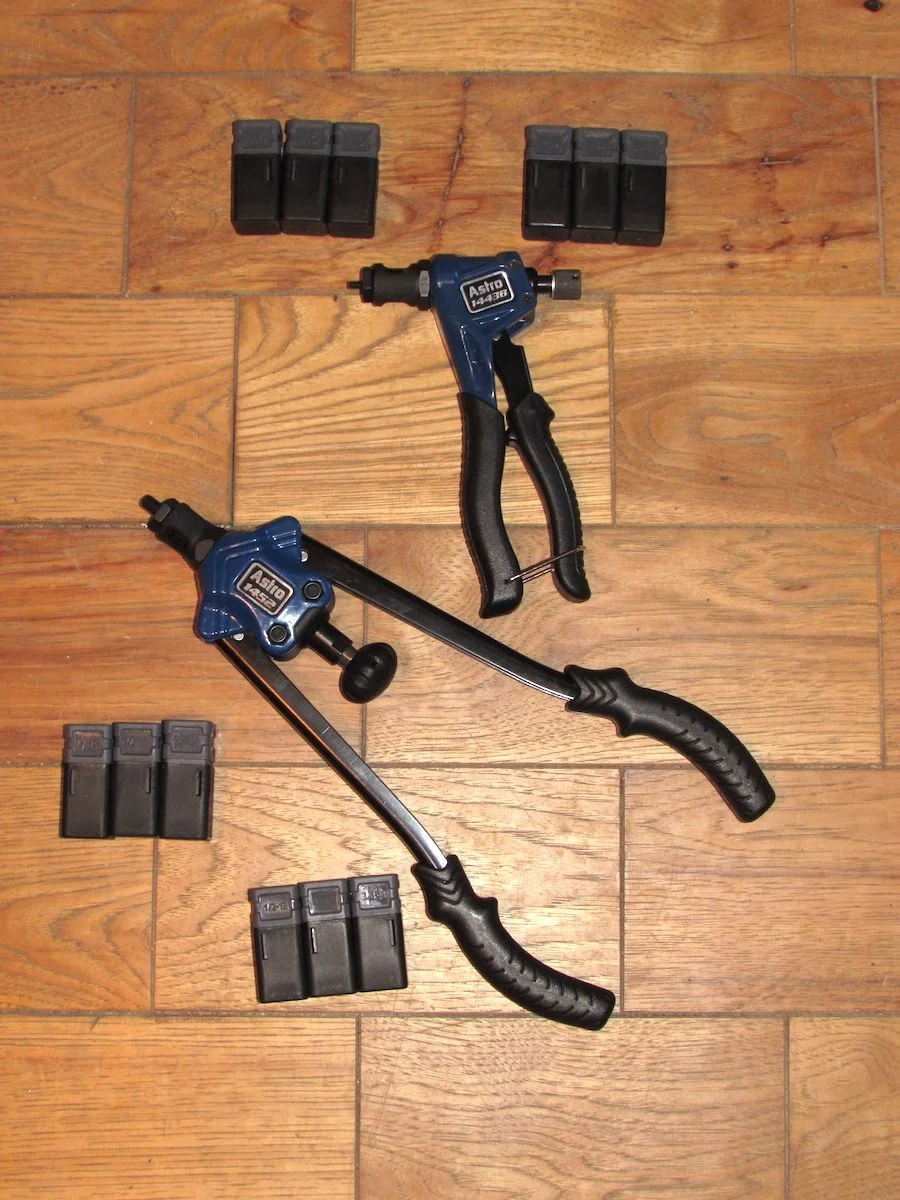

After "making do" with some cheaper alternatives, I picked up this pair - Astro Pneumatic's 1443B (the small one) and 1452 (the large one).
The mandrels swap between the two, but you only want to use the smaller mandrels with the 1443B (M4 and 1/4" and under). You can probably get away with some light use of larger ones, but you're liable to mess it up if you aren't careful. However, using the smaller mandrels on the 1452 gives you more leverage and reach if needed.
Between the two of them, they come with M4, M5, M6 (1443B), M8, M10, & M12 (1452) metric and 8-32, 10-24, 1/4-20 (1443B), 5/16-18, 3/8-16, & 1/2-13 (1452) SAE. I've got a 10-32 mandrel set on order just because that seems to be a size I use a number of fasteners. I haven't confirmed it yet, but mandrels from some other manufacturers look to be the same and offer M3 mandrels.
Both are quality tools and make installing rivnuts a breeze. I really wish I did this sooner.
I've mostly been using steel, but picked up some aluminum ones as well.

Note that they come with a limited number of rivnuts - three each size for the small one and a few more of each for the large one. The large one comes with a case. I'm going to have to put something together for the small one to keep all the parts together.
A friend has one off one of the tool trucks. Takes tools to change the mandrels and one size for everything, which makes it bulky for trying to set the smaller ones and a real struggle to set the larger ones. He's drooling over my set now.

The pair of them is likely overkill. I've used the larger one a couple times, but doubt I'll be reaching for it often.

The 1452 starts at M8 & 5/16". At that size and above, you're not really able to use the structural capacity of bolt - you're probably going to start bending the sheet that you're putting the rivet into. But I've put in some M8-M10 or 5/16"-3/8" sizes for mounting off-road style lights due to the size of the threaded mounting shaft. The light doesn't need structural support the same way a spring hanger or such would require, so mounting that size rivnut in a panel isn't a concern - but you also couldn't effectively mount the light with a smaller rivnut. Also, you can mount the rivnuts into square tube, which is more structural than a flat sheet.
