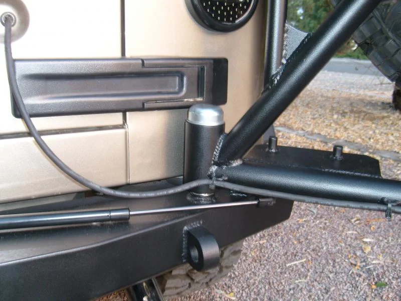

Lots of people put them on their swing aways. They work great, but you need to make a stop for it or else the strut wont last long.
Here's one I put on the bumper I built for my dad's Jeep.

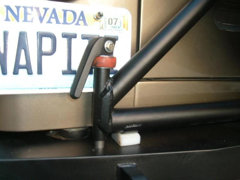

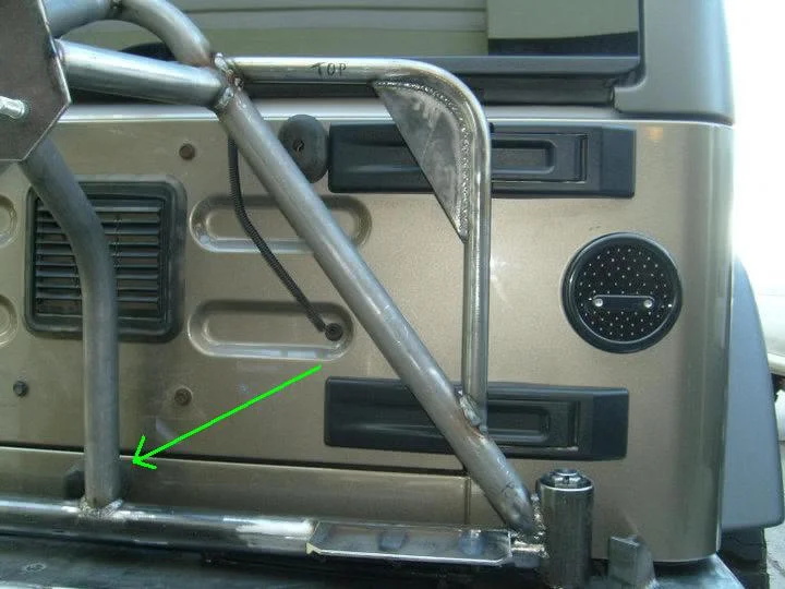

I designed and made this one from scratch. Its the same design Im going to use on the 80. I like it cause it adds a vertical support, and you never have to worry about the swing away opening up on the freeway or trail. Even if its not latched down, it wont open.

Nice. So what stops that thing from slamming into the back of the truck? Is it the strut, or is there a discreet stop somewhere I don't see?

On the jeep, there's a rubber bumper on the tail gate where the spare tire went. It keeps the swing away from hitting the jeep.
