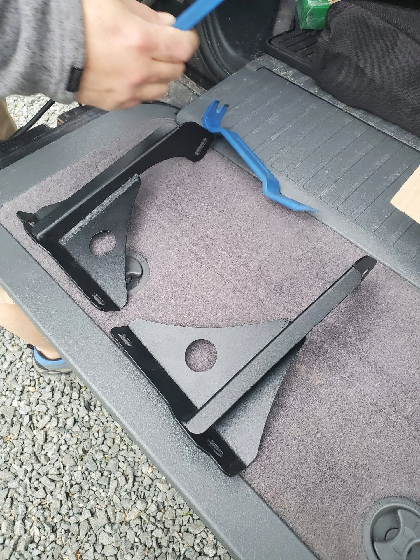

I have two of these pieces... can anyone show me where they are supposed to go? They look like a left and a right.
My guess is they are used to support the headlights? I have not seen the parts list for pre-face lift.
They support the headlights. They bolt to two existing bolts in the firewall outside the radiator. They then angle inwards to the inside, lower corners of the headlights.
Awesome... and I did NOT get that detailed set of instructions. I got 4 pages and something like... "after you bolt part a on... do everything else and you should be good."
