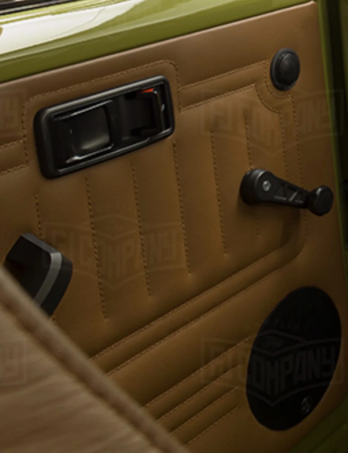

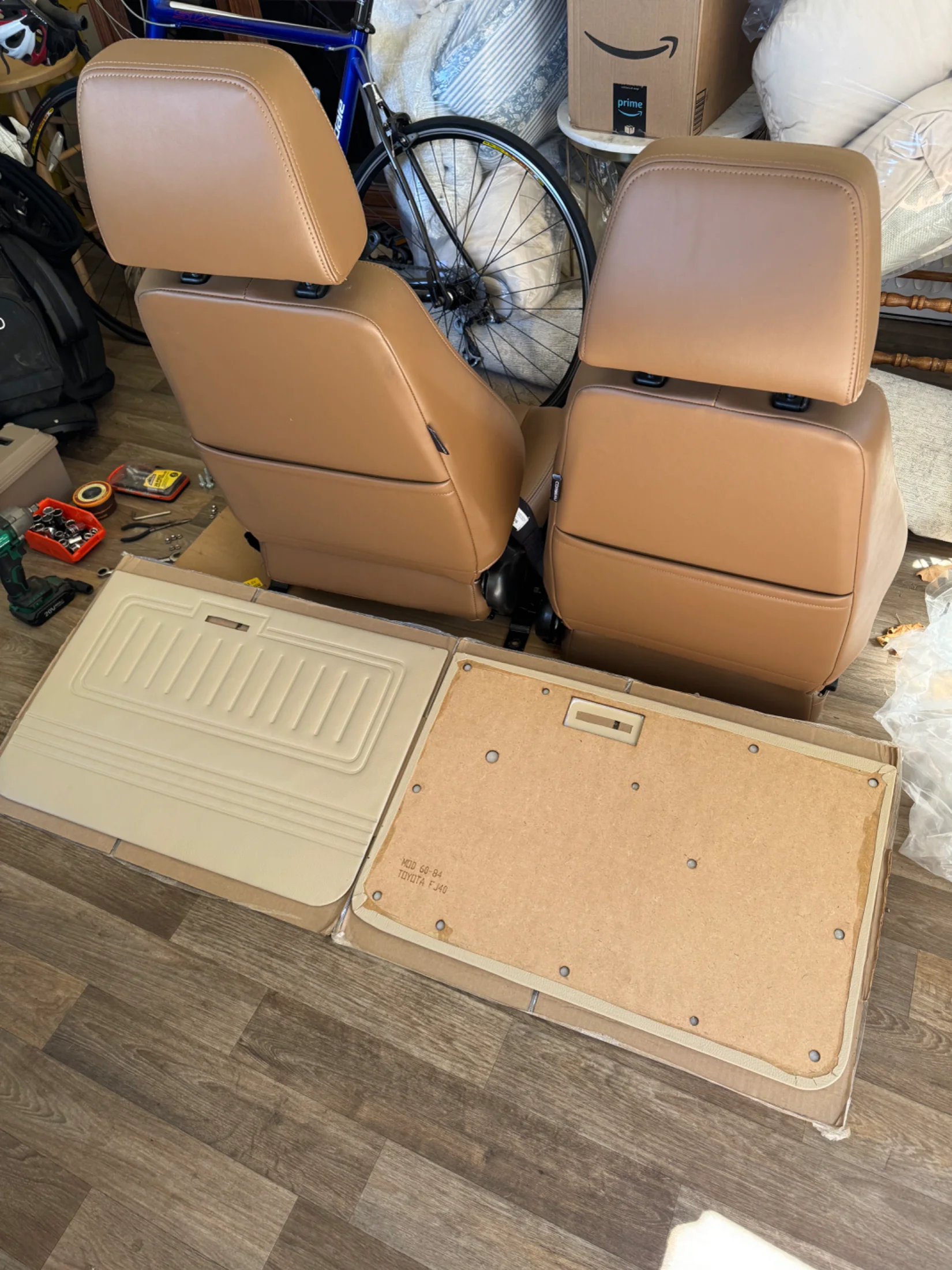

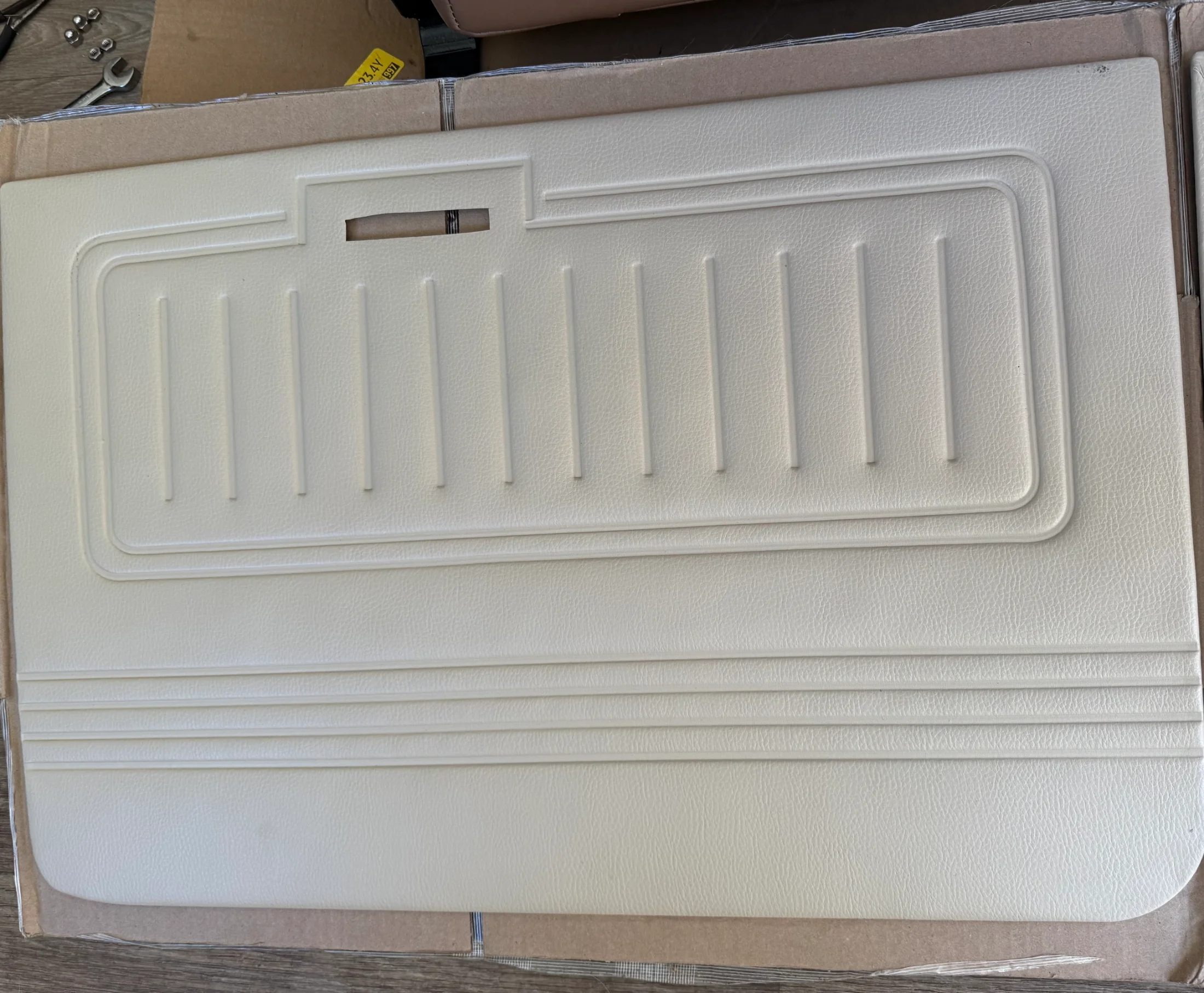

I added some pictures for your reference just so you guys have an idea in your mind of what I'm talking about.
I also found multiple pictures of people who have reupholstered their door panels with sewing the original lines back in not necessarily to the exact, but very, very similar.
Anybody have any ideas on who else I could take this to to get this reupholstered? Considering I have all of the material materials needed I just need someone to sew the pattern

I doubt my worm drive Singer could do that and it will do about 10 layers of denim. The hand crank china shoe patcher sewing machine $120 can do 3/8 + leather. But if you just sew the pattern in the vinyl with the foam backing mom could likely do it then glue it to the backing stiffener.
That guy doesn't want the job - so the price is sky high, that way he doesn't have to tell you NO.
Dye the cream ones to match your seats.
Maybe it's time to learn a new skill. Id bet a 15-91 singer worm drive would do it. A regulator home unit probably wont work. A 15-91 is a little more robust. You'd be limited on thread size. Tracing the pattern probably be the most time consuming. Then find a good contact adhesive.
