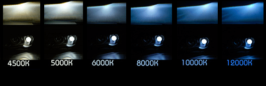

I just finished the tsx projector retrofit with ds2 4500 K morimoto and ballasts. All the parts are from TRS.
First impression is they're better than stock. Not as bright as I expected. Seems almost warm incandescent in color. I have a xenon depot kit in 4300 on a 2016 4Runner with stock projectors which is much brighter and whiter.
Don't know if it takes a while to break in for a color shift?

Your 4500k bulbs wont be white or bluish. This is a generic photo off the net, but the actual light output is better at the 4500 level which is why most OEM bulbs are that temp.

Did notice that the 4500K was more yellow for the morimoto kit, so I guess this is the.normal color.
