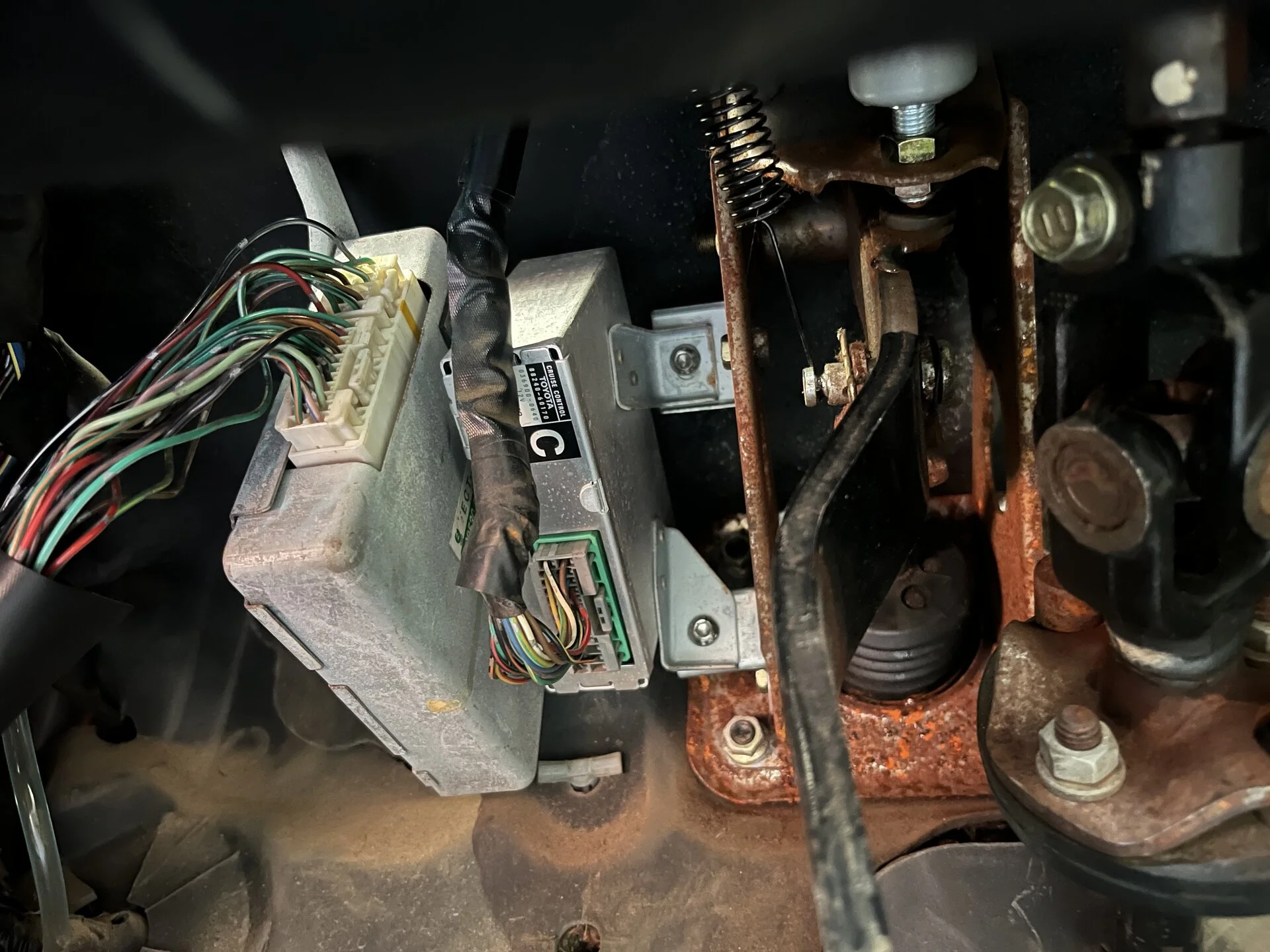

08/1996 to 01/1998 - 88240-60170 -> this is the one I purchased and it worked as expected. Bolts in same way as other modules; onto the brake pedal.

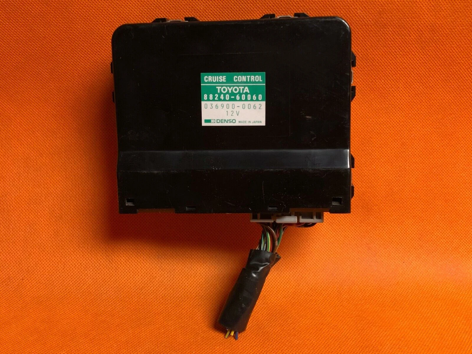

11/1995 to 08/1996 - 88240-60060 -> not compatible with my late year 80 series.

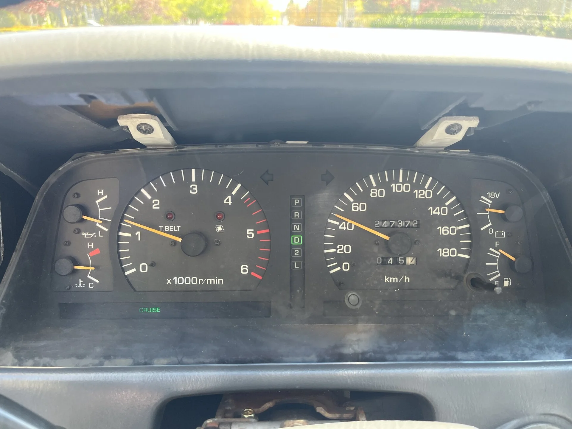

Cruise control is active and my foot is off the pedal.
This is how it mounts.
