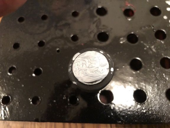

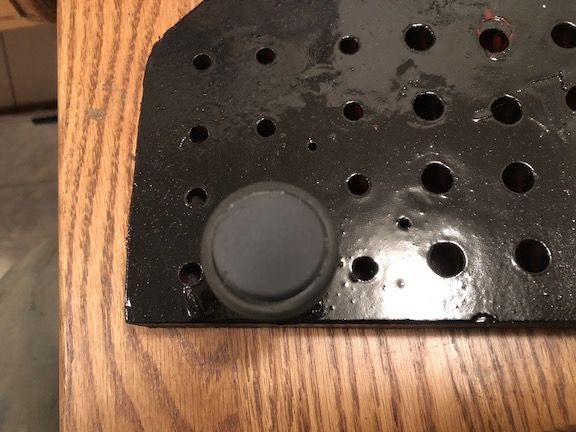

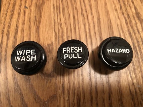

Another option of those who do not have access to a buffing wheel, or are too lazy to spend the time buffing:
1. Sandblast the knob to remove all old paint and etch the knob. You can't see the engraved letters in this pic, but they are there
2. Using a paint stick, fill in the engraved letters and top surface of the knob:
3. Carefullly sand the paint off the surface of the knob using 800-1000 grit paper
4. Spray the entire knob with several coats of clear enamel (I use Rust-oleum):
