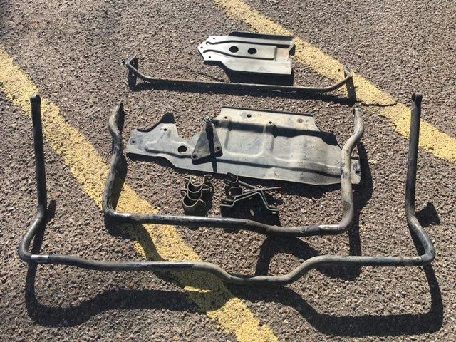

I don't see the need for adjustable pan rods or adjustable lateral braces as my height it still relatively stock. Since I am working with the stock 20 years old components here. I would like to have these stock arms, pan rods, bar etc sand blasted and powdercoated (maybe silver so possible leaks could be seen a little easier). I figure this would give me a good chance to have them inspected for stress cracks, dents, overall condition, and add a fresh coat of durable paint.

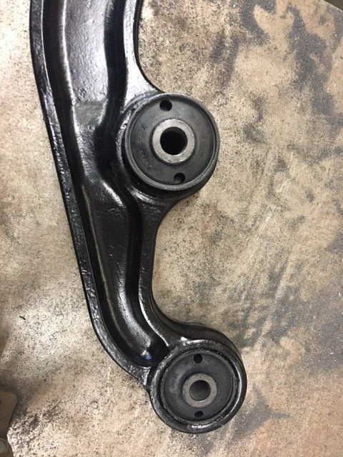

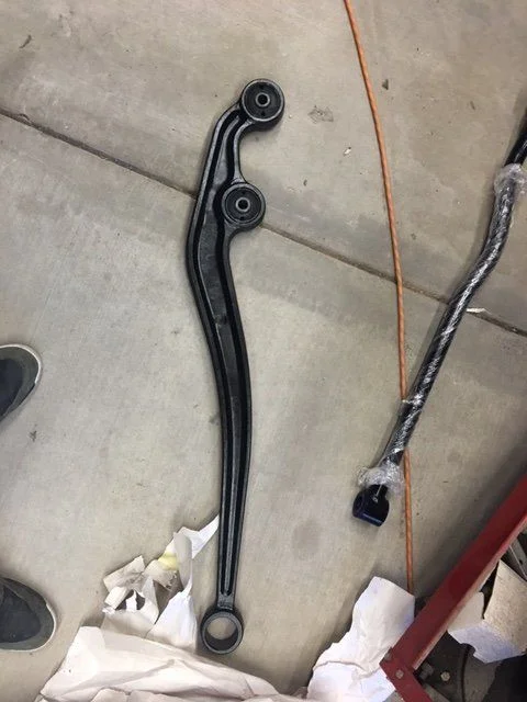

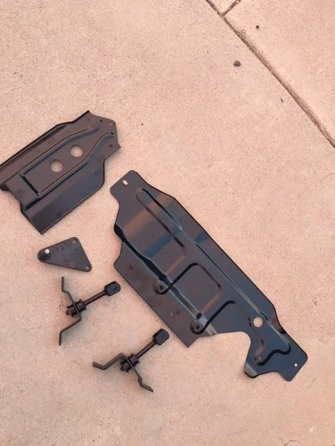

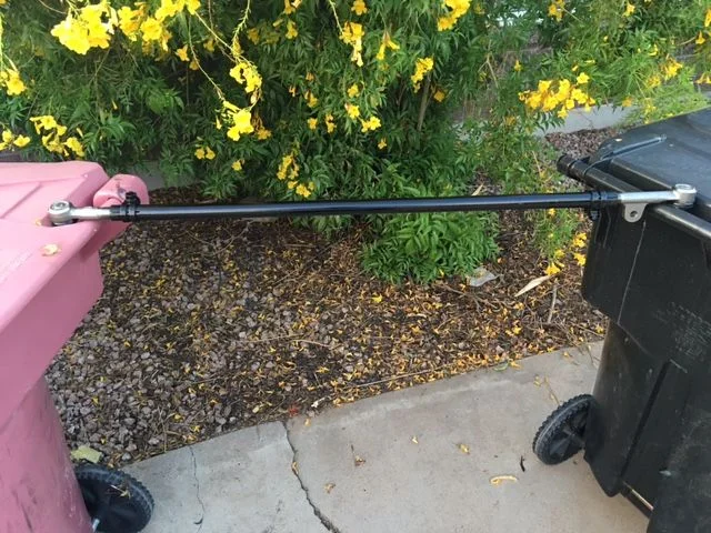

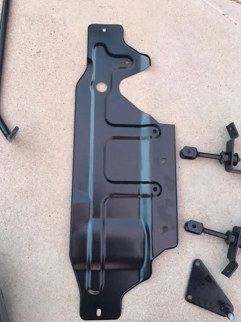

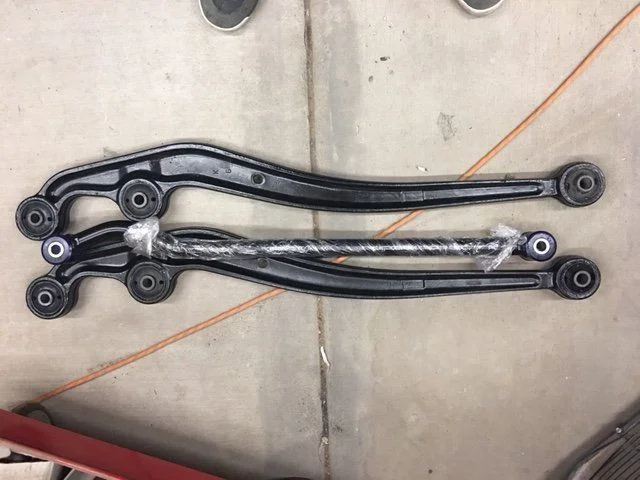

AZ Power Coat did an amazing job of making these 20 year old bits look new again. Got everything in a factory friendly matte black
Since I'm getting a feel for internet like this forum is, the things that look like smudges in the paint our grease paw print from me installing the poly end link bushings on the rear links and then touching the other parts when moving them to the ground for pics.

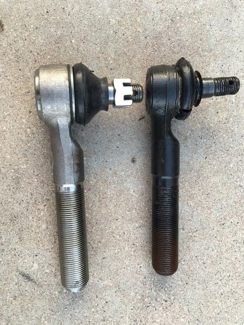

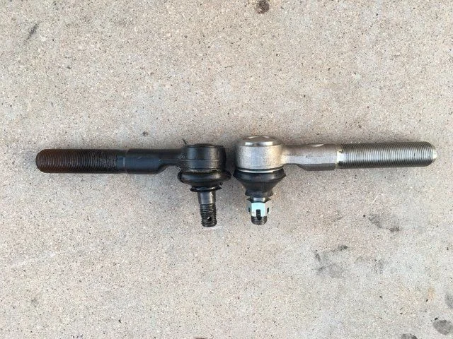

Finally got the LC back together last Thursday, final push cam in replacing the tie rod ends, rod, and relay rod ends.
