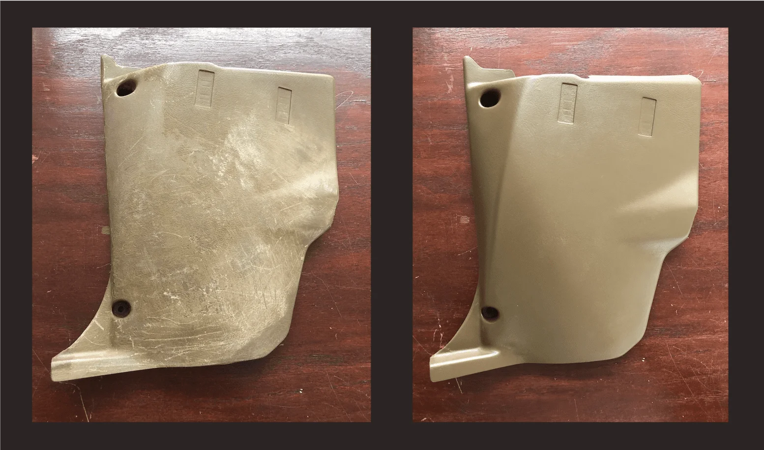

You guys NAILED it. I ordered some SEM Bluebird brown, did some cleaning, some sanding, some more cleaning... then some painting:
May not win any trophies at the Concourse de Elegance, but tucked under the dash... yeah, that works!

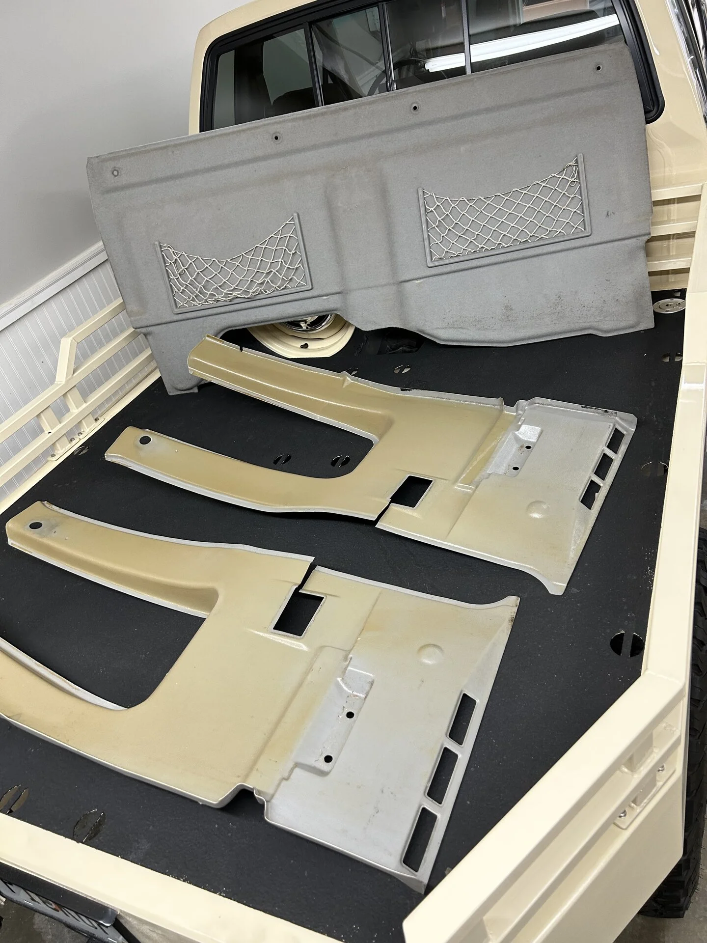

My patience paid off. After a couple years of watching for part-out sales, I snagged some near-perfect rear interior panels. Not a single crack in any of the three panels. Next up: clean and paint. These panels were the last pieces I needed for the interior.
Have you guys painted that rear panel? It's kinda fuzzy. I've painted/dyed carpet and cloth seats before - just spray, then brush with stiff brush, repeat. But haven't done a material like this. Also, any experience removing/replacing the "net pockets" - the pins on the back?

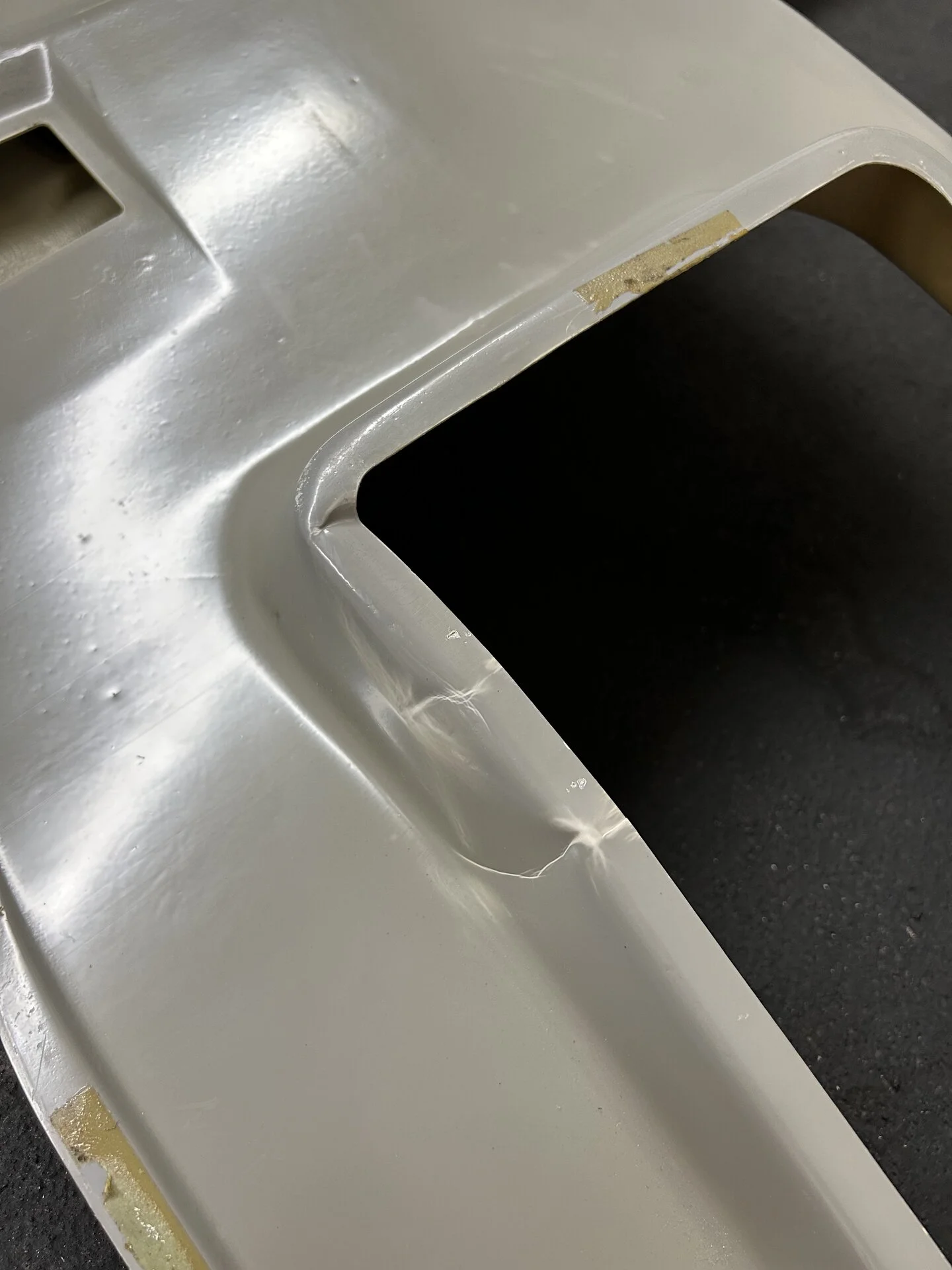

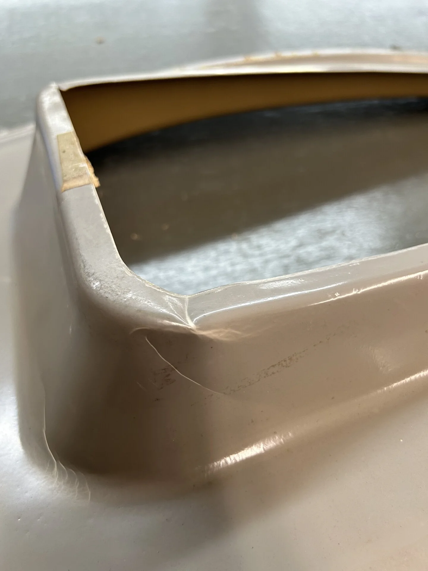

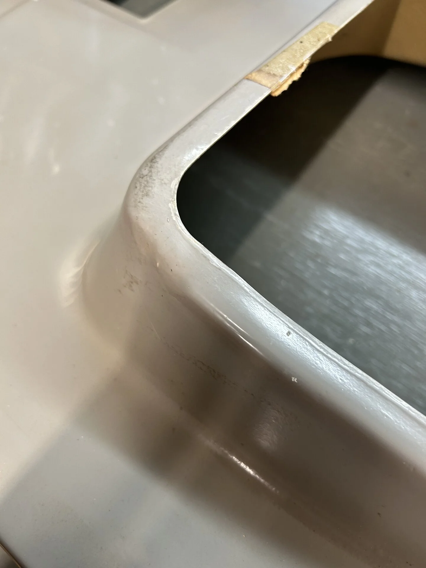

also, there's a spot that looks like it got crushed in shipping (wasn't there in the seller's pics) that I want to fix. Before I break out the heat gun and play plastic sculptor, any tip here?
I'm glad you found a set. I'm also glad I didn't sell my back panel because I found all the other panels. I had to get a complete cab though. Actually a cut in half truck with a siezed engine.
I thought the back panel had material glued on. I haven't messed with mine yet to see if it can be pulled off. The nets on mine are saggy.
Looks like I'm watching to see what you do instead of offering guidance. :p
I just looked at mine. It almost looks like felt on the plastic and it will definitely peel off mine. Keep in mind it baked in the sun for years before I bought it.
yeah, it's definitely a fuzzy felt-like material. The one I got is in such good condition - seems like I'd spend days peeling it off. Maybe I should ship it to you to bake in the sun for the summer ;-)
I kinda answered my own question on the creased/crushed sections - low heat and gentle massaging does it. This is some THIN plastic.
