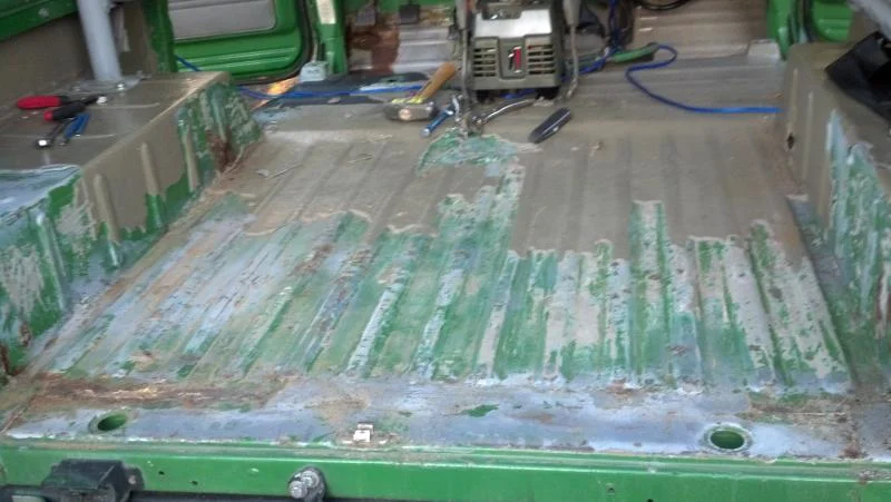

So, I have begun removing the poorly applied bedliner to get to the raw metal. Here is my game plan:
1) Remove as much bedliner as possible to expose the metal
2) Remove the tub and get it soda/sand blasted and primed
3) Remove fenders/Cowl also to get blasted and primed
4) Cut out the rusty parts and weld in Pacol patches
5) Prime the areas and take every thing to paint
6) Inspect and paint frame?
7) Do any engine work (oil pan gasket?)
8) Put it all back together
This isn't going to be a super fast resto, I still have to make it to Cruise Moab Rising Sun's 4x4 Toyota event in May. I just thought I'd post up pictures as I got stuff done.
The following pictures are of all the bedliner I've removed and what was underneath, looking for input on what exact patches I should order and such. (Did I mention I have 0 welding experience?) Thanks all!
5)
I don't know if you can order anything for the wheel well where just the brackets are rusted through. If the rest of that area looks sound, I would look for some doner parts and just cut and weld in new brackets and metal. Those places are bad for collecting water/rust. Maybe the pictures aren't showing it as bad in the other areas as it is.
Did the heat gun help with the liner removal?
I know there are small patches for that ripped section I should be able to buy that would work.. It's not rusted through any where,besides the wheel well, the floorboards and the back part of the bed. The head gun helped a little, nothing drastic but it did help it come up in sheets.

Is that fiberglass in the floorboard I see?? I have fiberglass patched from the PO in mine. I am still seeing how they hold up over time. For now I am just enjoying using it (except right now axle tore apart for disk upgrade) paying to much attention to the body.
You spy correctly! There is fiberglass in the front floorboards a little scattered throughout the tub. It held up well, but since it is still rusting through the bottom, the problem isn't really solved. So, I like to fix problems only once, so I stripping it down to metal!

I don't know if you have finished taking off the liner, but I used the $29.00 harbor freight multipurpose tool today and thought about how that might work on the liner. The tinn blades just vibrate and remove stuff.
What tool is that? Is it pneumatic or electric? Any help would be awesome.
It's electric with variable speed. Goes on sale every month. Made by Chicago, I think.
Most the blades wear out fast, but then they are smooth and work good for cutting into things like silicone around windows.
Check in the tool section, they are always showing the latest HF coupons.
