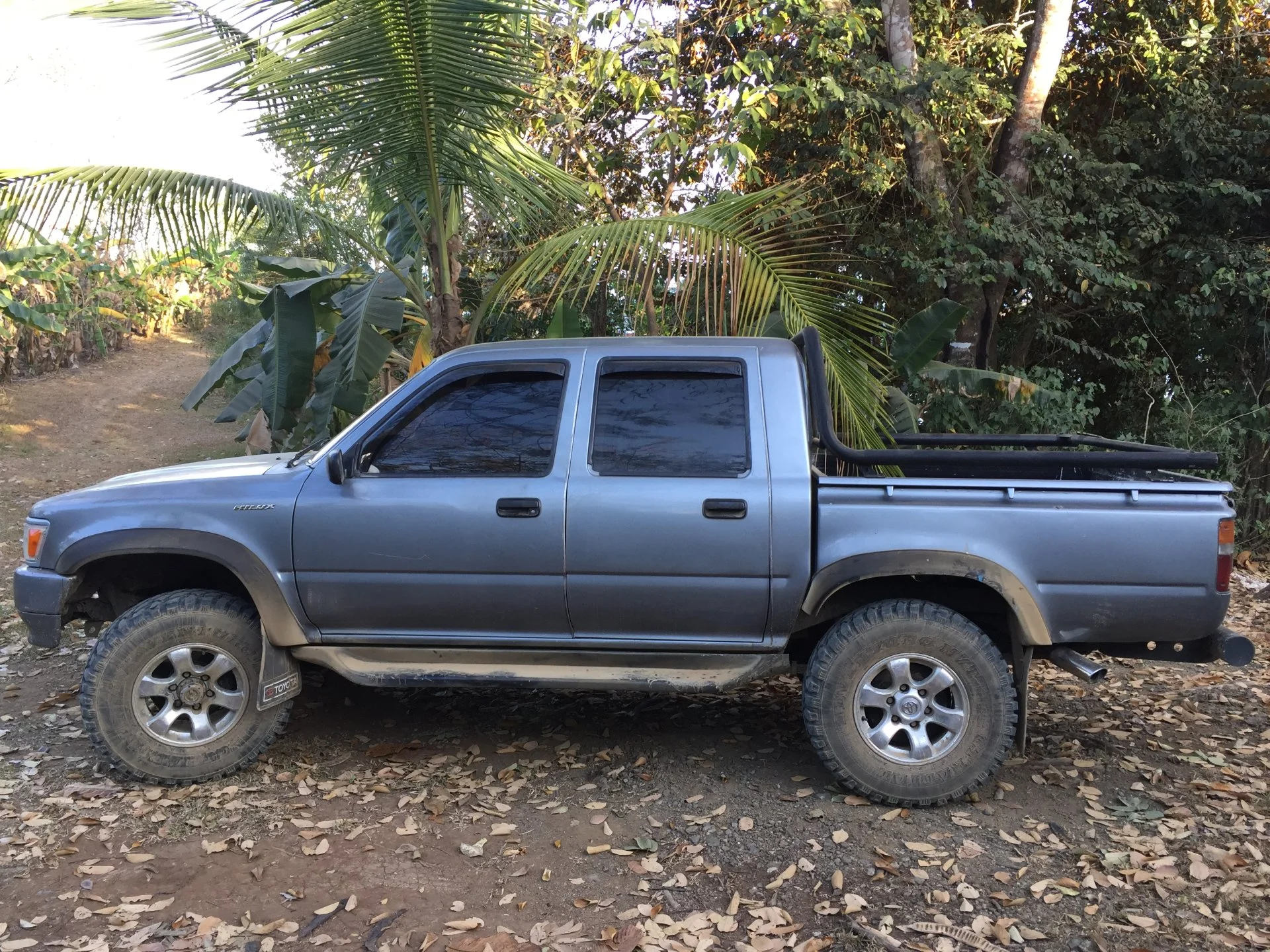

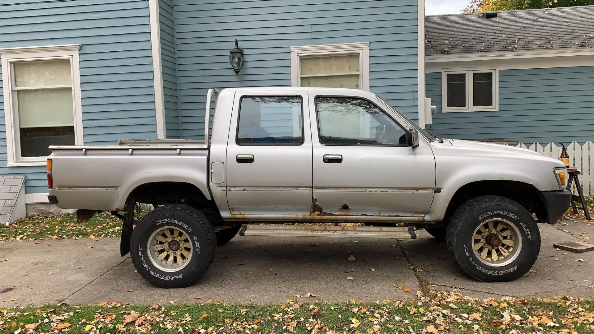

Hello Everyone,

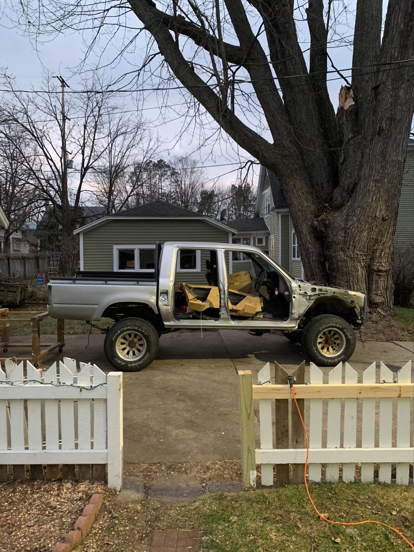

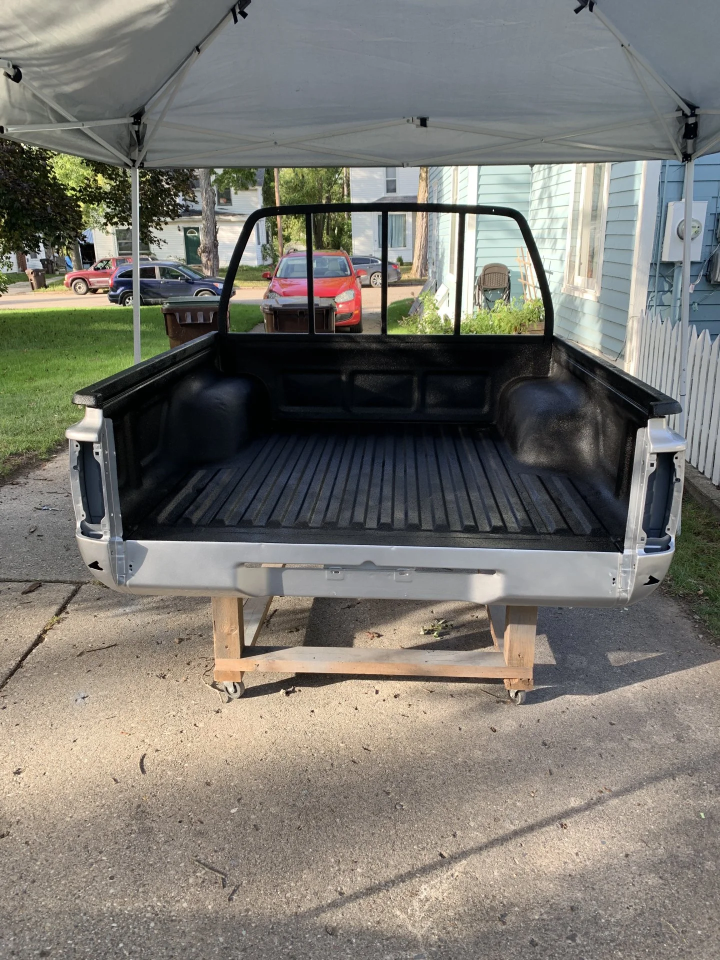

I decided to join the community and post about my 1989 Hilux I bought a few years ago and am finally getting around to restoring. I am the lucky guy that managed to find a JDM Hilux in the USA with a owner that was not much of a car guy. He just knew he saw Hilux's in Iraq and had to have one. Well after a few years the novelty wore off as finding people to work on the truck was not easy, finding parts was not easy and when the rear pinion decided to start scream he decided it was time for him to sell it off. Lucky for me he posted it terribly as a Diesel Toyota and I was able to get it for relatively reasonable considering a decent one goes for +20K. This truck has it issue and well as of now I have it in a few pieces repairing rust and getting it ready for paint... So far the bed is done but I still have the cab and not to mention some of the mechanical. Anyways below are some pics.
I also have a 77 Celica my dad and I restored when I was younger that I decided to tempt you with a pic, but this is a off road forum so you only get one! LOL

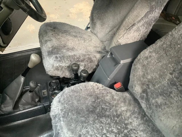

My LN106 has an R151F with Dyna 5th and the Marlin crawler dual cases. Best mod on any 4x4 I've ever done is that doubler :)

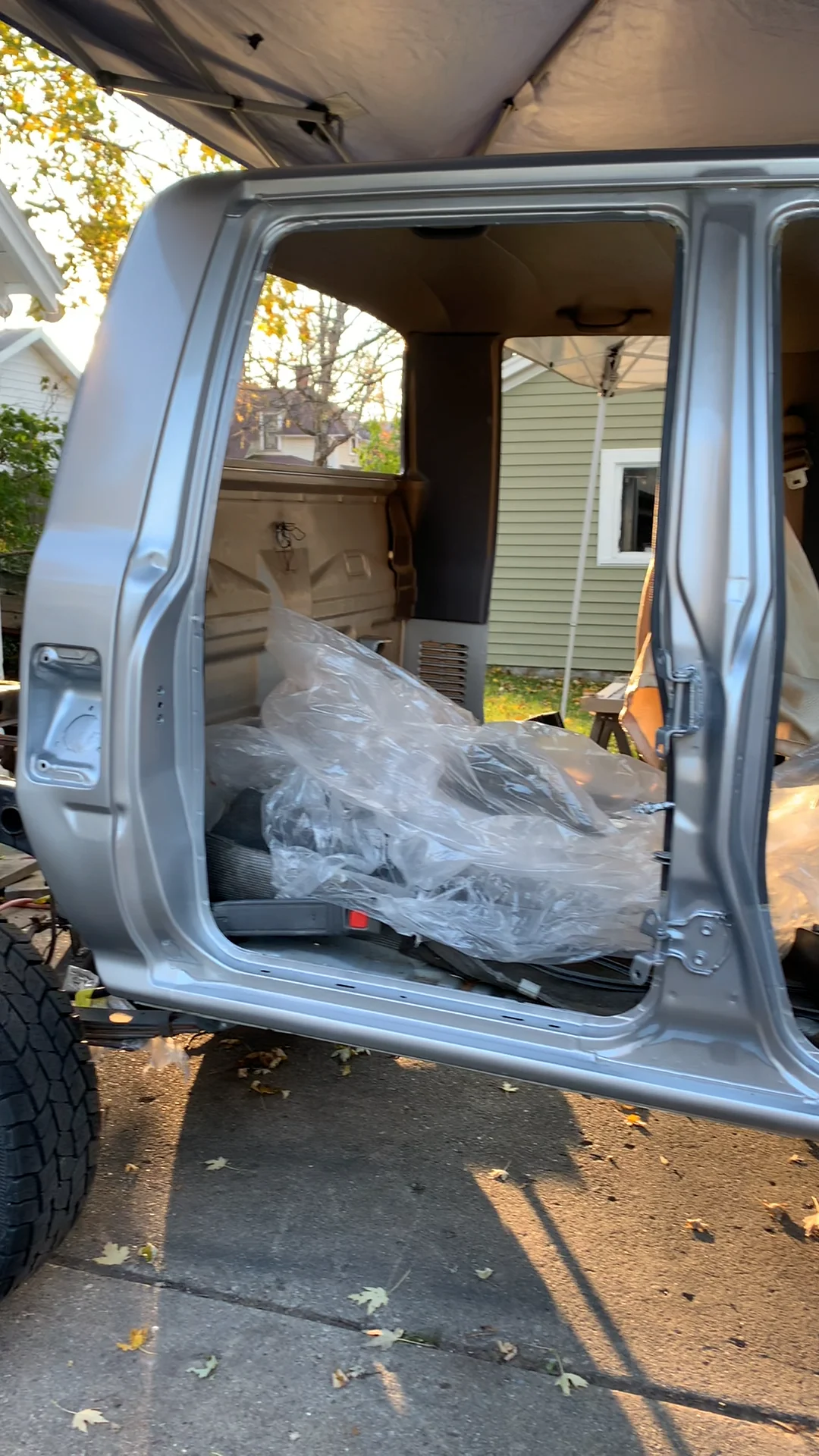

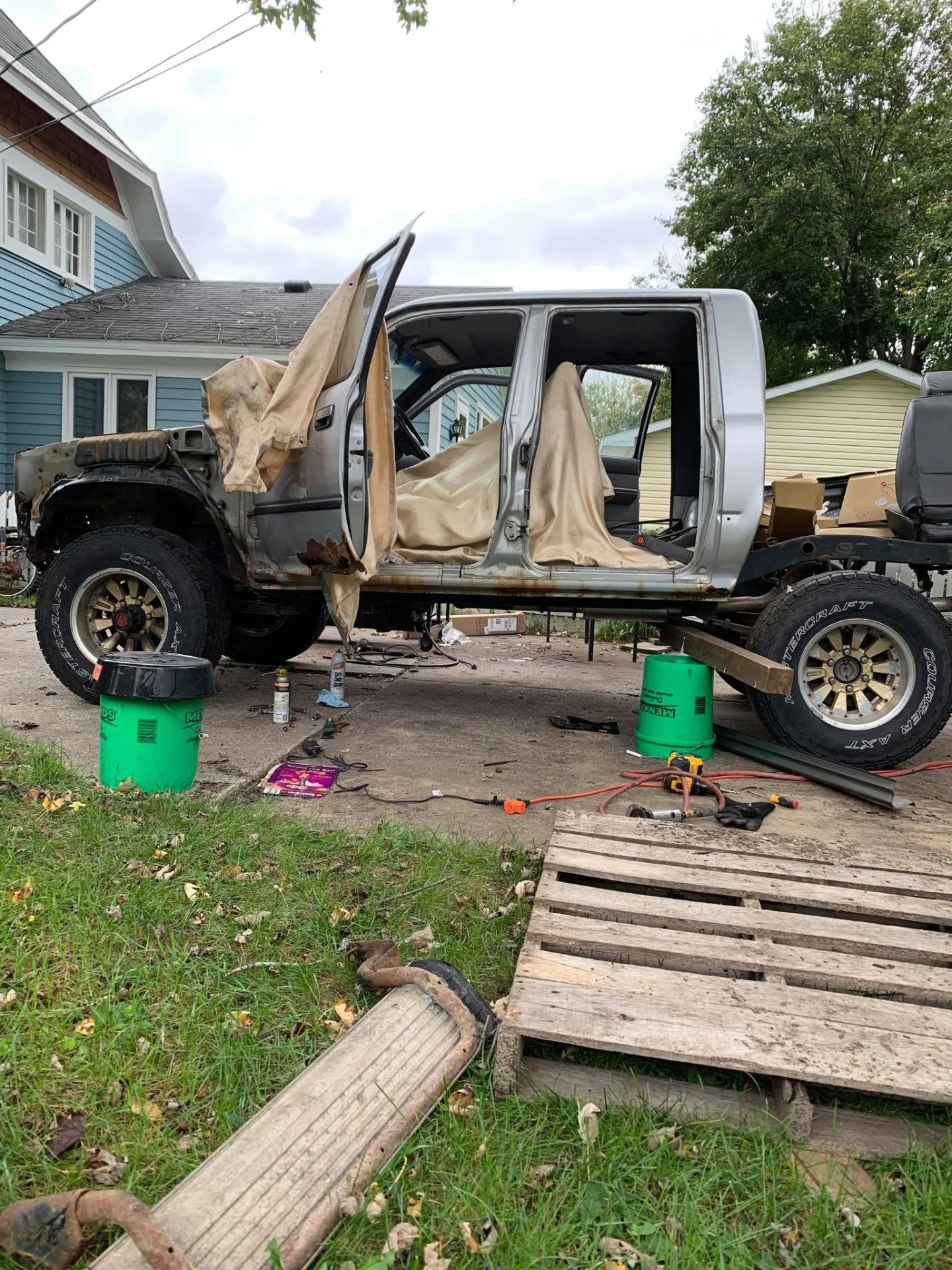

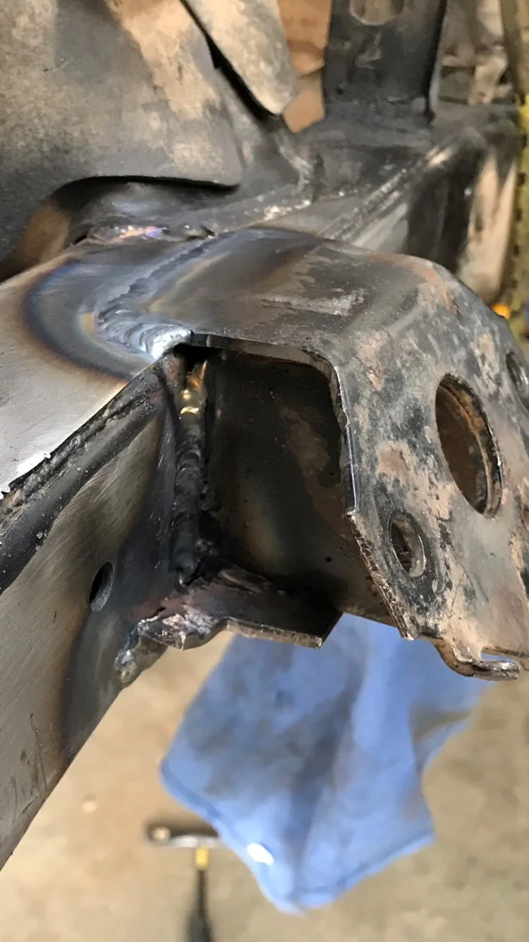

Hey Yall,

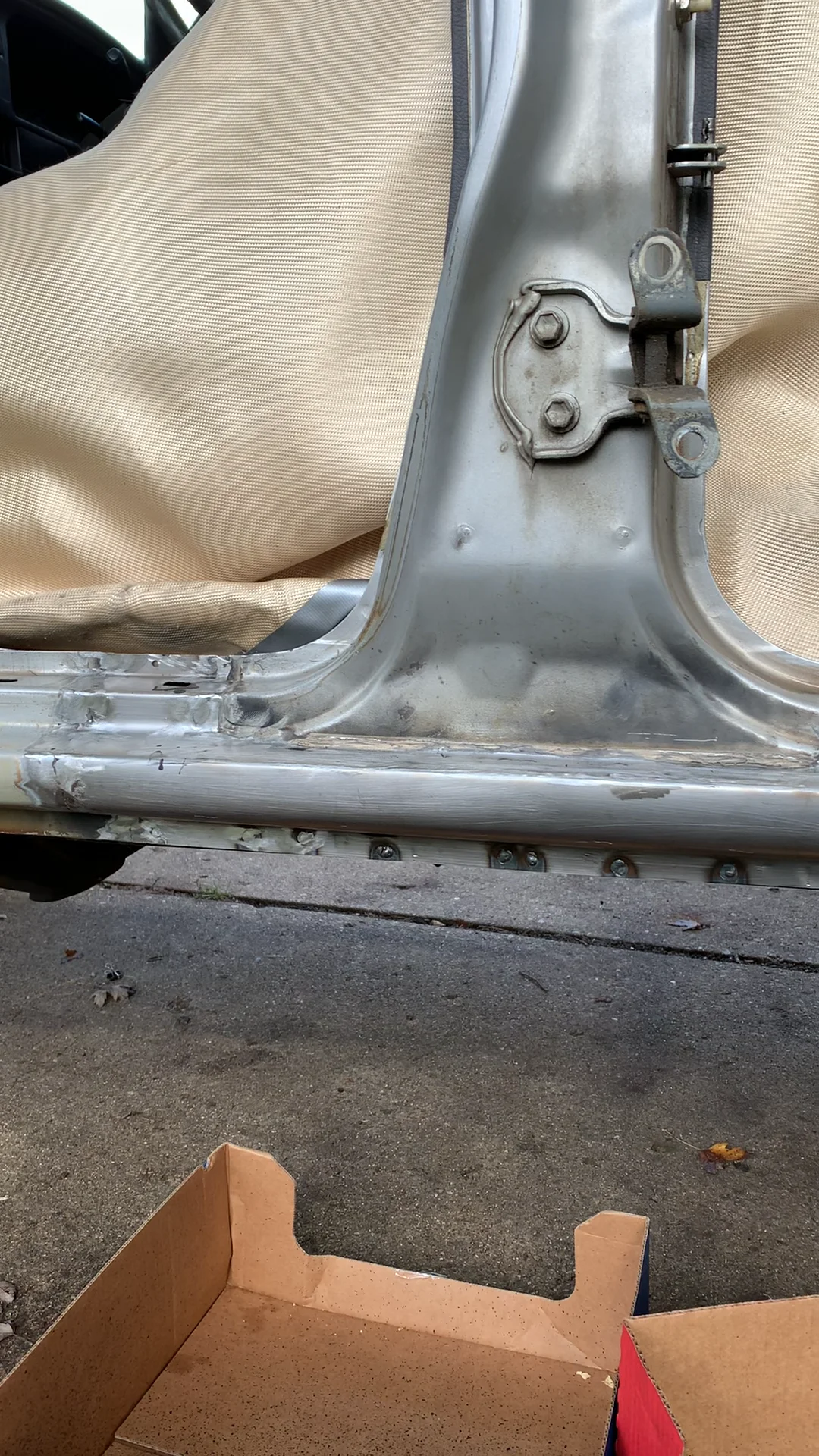

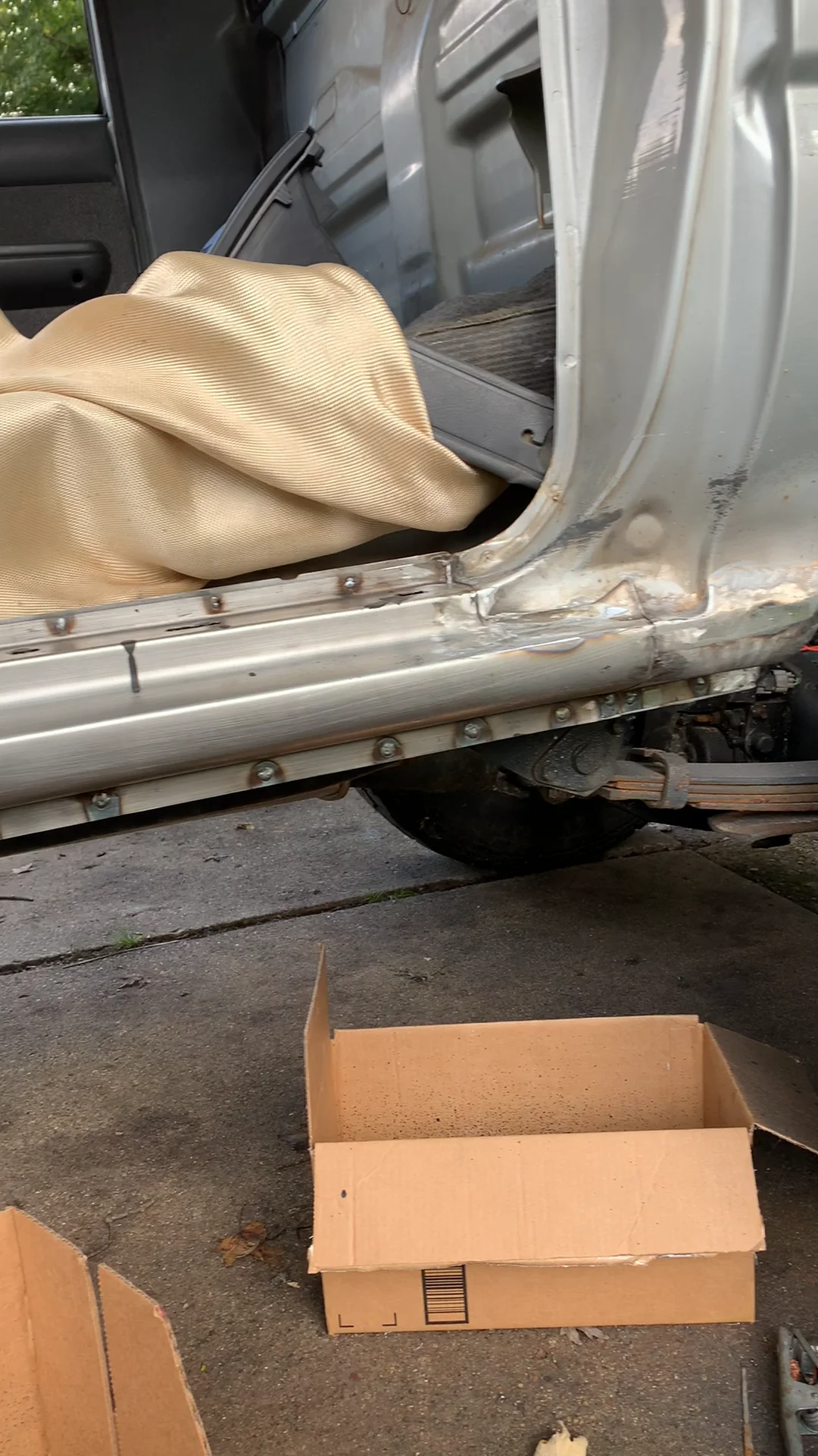

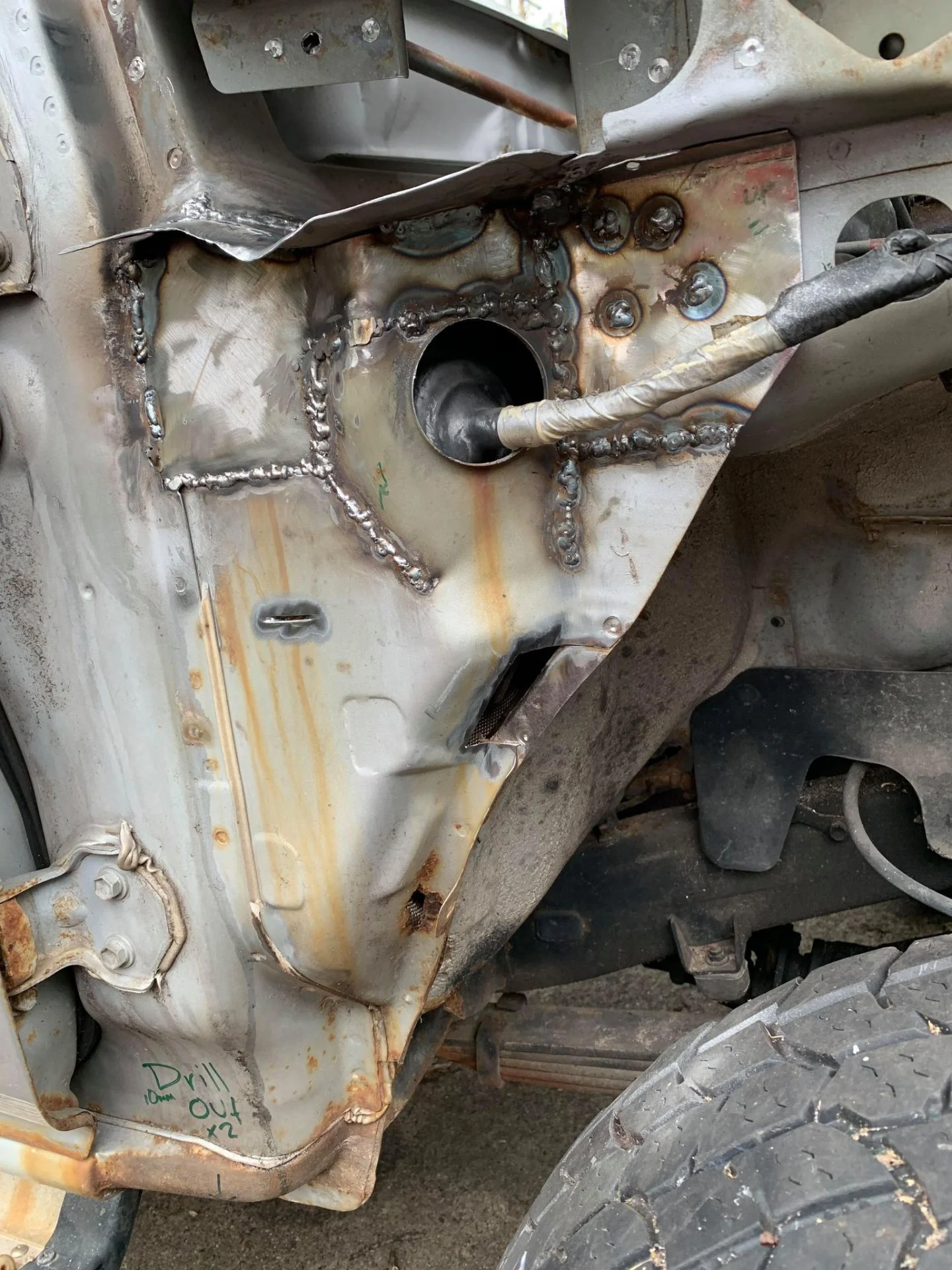

So I have done some cutting and welding and thought I would share, I also have cleaned out the front half of the rocker the best I could with a 1/4 in rod welded to a wire wheel, a shop vac and then rust encapsulated it to prevent moisture attacking the metal... I will also be using some type of wax seal in the rockers once done making it where the rust should not return and if it does it will be a very long time from now. The Other rocker is sold but will be getting the clean out and seal treatment just in case. The other rust holes are also patched in the first pic... but I forgot to take pics of it.

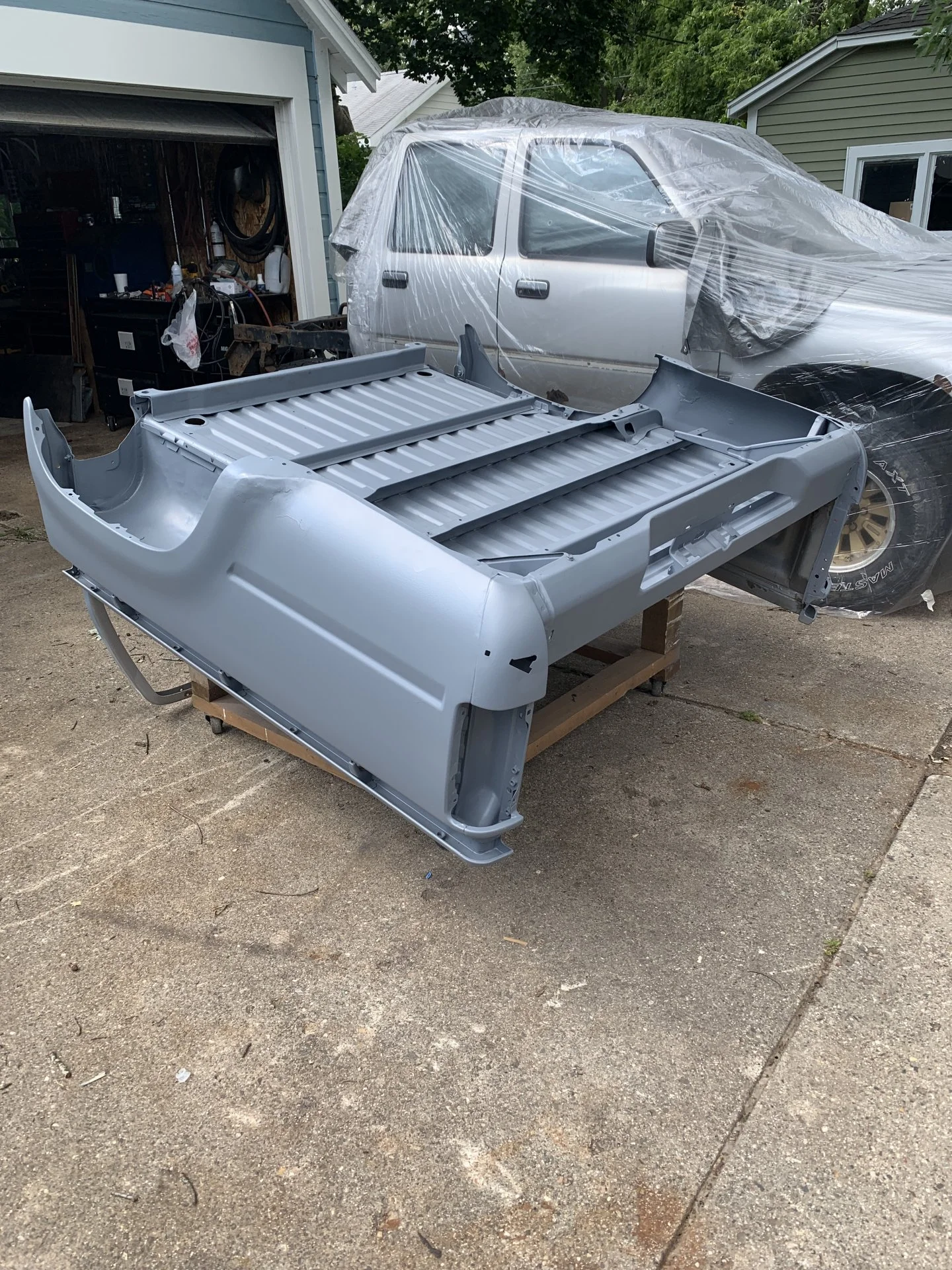

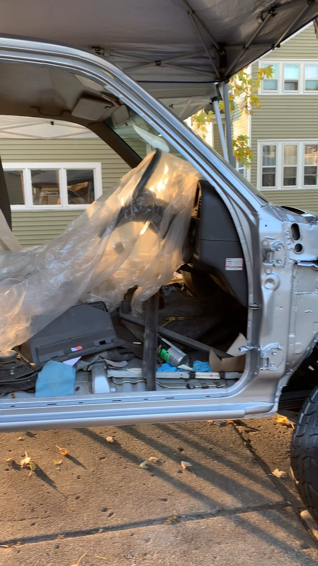

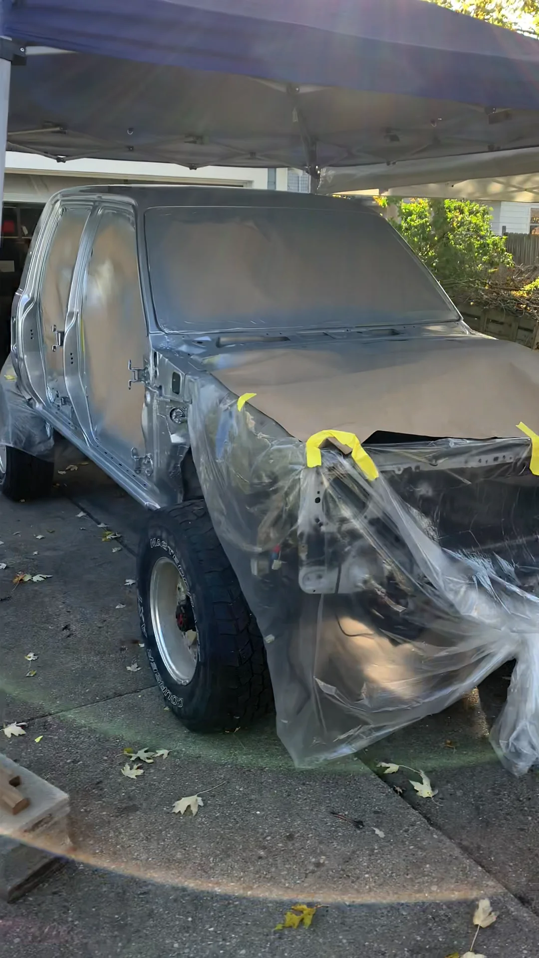

Been working hard trying to beat the snow fall and praying for it stay away this year. Well it finally snowed but I have gotten a lot done since my last post. For the most part the rust has been patched. All that is left are rear doors and a small bad spot in the passenger floor. But since those can be taken care of in the spring. I moved on to painting the cab and taking care of the rear half of the chassi. Along with removing the rust of the radiator support and painting it in a rust encapsulate for the spots that were difficult to get 100% rust free. I am hoping it won't bite me later but if it does luckily I can just order a NEW radiator support here for a Toyota Pickup (Which is probably what I have should have done with all the broken bolts that got drilled and either extracted or tapped)

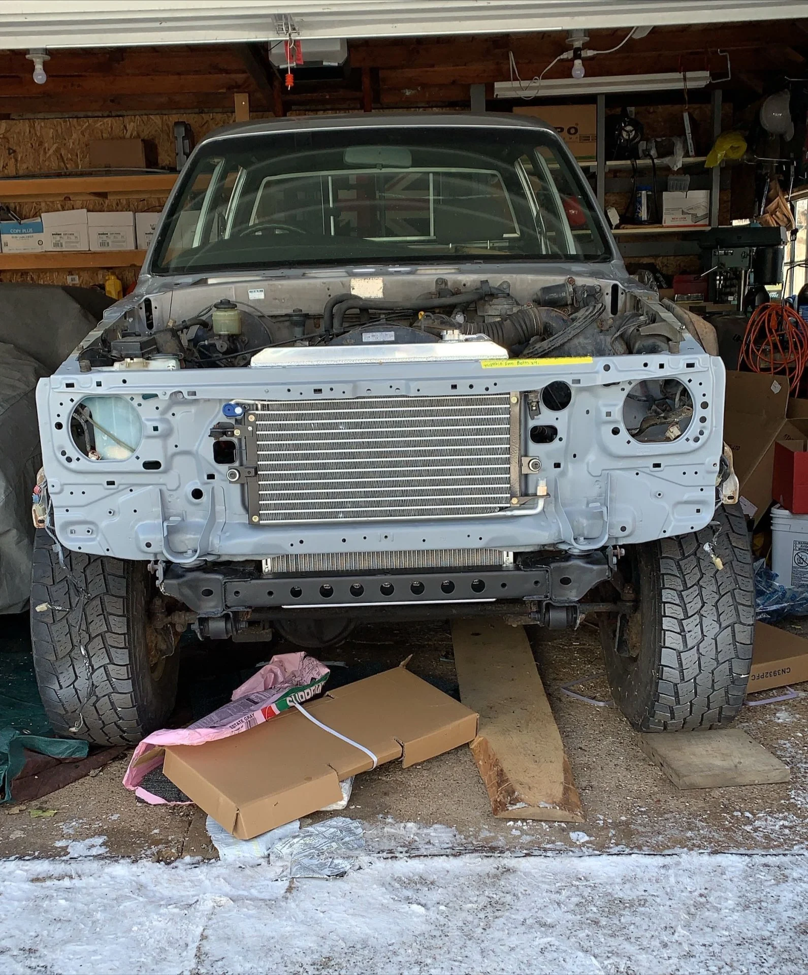

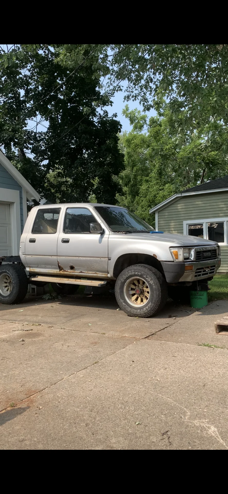

So for updates. Unfortunately, I am in Michigan and it is cold and my tiny garage is able to house the Hilux, Celica, and a few bikes to keep them out of the weather, but with a very minimal room for movement around everything. That being the case I have not done much since snow has been on the ground, But I have done some things! Before the snow hit in Dec I was able to place the truck bed on the frame! Since then I was able to get it bolted down and 1 whole tail light installed, The other is waiting for its day. Yesterday was also a nice day and although I didn't have a lot of time due to a 82nd birthday for my wife's grandma, I was able to bolt in the radiator, condenser and the upper radiator shroud. I then sandblasted and epoxy painted the lower shroud and to my wifes enjoyment it is now in the house drying. LOL
Not a lot of pics/progress but hey some progress is still progress!

Is that a deeper than standard radiator as mine doesn't come down behind the front x-member ?
You know it would have been logical to check at the time... but I didn't. I saw that the radiator inlet and outlet were in the same spots and was happy! I will say that it is a 3 row aluminum which is the biggest I found. I would like to run a turbo at some point but for now I will just get major cooling! hopefully it is not so much that it angers the motor but It seemed fine getting up to temp in 65 degrees.

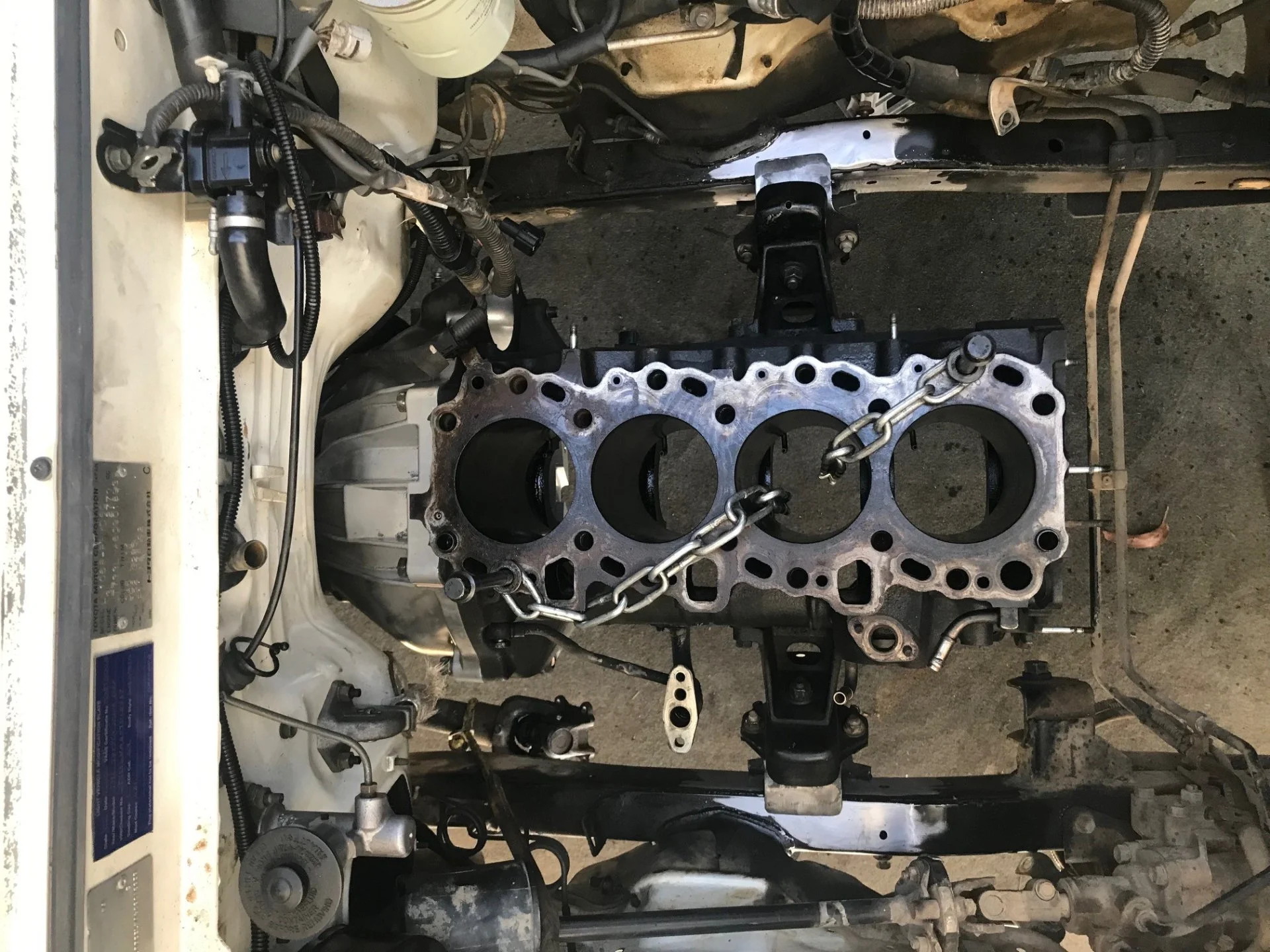

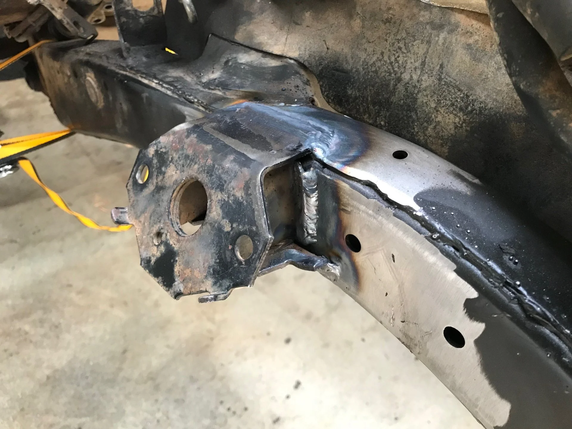

I'm now well down the 'convert to 1KZ' path no going back..... Test fitting dummy block for mount location
Then get my (qualified) mate to weld 'em on. Next is engineer inspect and approve....
