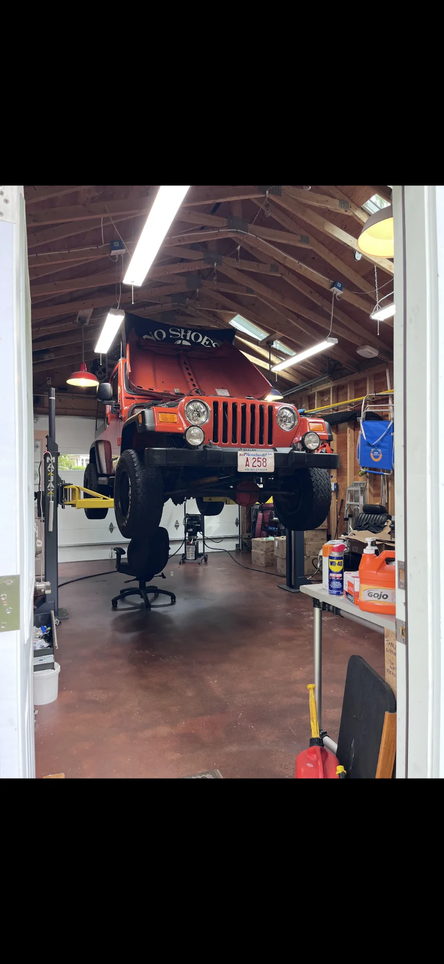

You are right. On y'all's advice I have shifted to intending on closing it in as a shop in the long run. Similar to this (biggest I can go)
