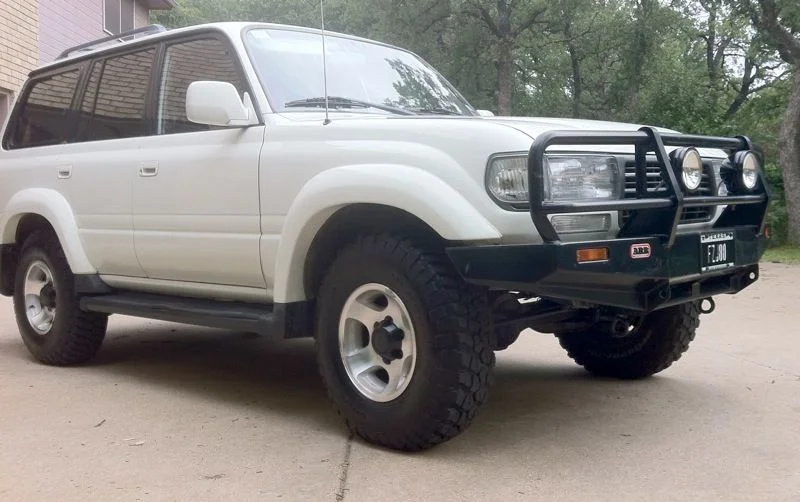

Friday I picked up a used but un-damaged ARB non winch bumper from a Mud Member, and set to work installing it Friday night. Having finished it late in the evening, I did not drive it until the next day.
Walking outside in the morning, there was significant stink bug due to the increased weight of the bumper - even given the fact that my rear springs are old as well. Driving the the truck, it was a bit squirrely and touchy on the steering. I was not surprised - a Toy dealership in Vegas that actually had a guy that was familiar with alignments on 80s had previously said that my caster was already off due the sagging springs.
I had purchased some Man-A-Fre 30mm spacers from the parts section previously and had them sitting in a box for the day I would want to level the stance of a medium lift, so Saturday I decided to put them in.
First of all - before doing this (it is not technically a hard job) make sure you have adequate jack stands. Mine are undersized at 2 ton each - they do not go high enough and I ended up using what I deem as un-safe techniques to get the truck frame high enough to drop the front axle. Lets put it this way - If I found my son doing it I would have reamed him out.
Dropping both front shocks, brake lines, diff breather line (pulled itself out), I still had to muscle the axle down and muscle the springs in after installing the space over the bump stops. It was not easy and a few choice expletives were offered up to the wrench gods. Finally, I got them in.
Drove it briefly that night to to set the spacers (they don't just slide in, they need to be installed with a layer of silicon lube spray after cleaning the bump stop - the weight of the truck will push them into place when you drive it) and put it to rest.
Sunday morning - the truck was sitting level perhaps even 1cm or so higher in the front than the back. It drove much better - squirrely handling gone. With the weight of the bumper, its a bit more boat like in cornering - from what i read, I gained roughly 60 -65 lbs in front - but I am very satisfied.
Center of hub to bottom of flair, I am sitting at 21.5" right now. As soon as my 4x4 labs bumper kit gets in, the running boards come back off (put them back on for a recent move), and OME stock height replacement springs I bought used last week will go in until I put a 2.5" lift on.

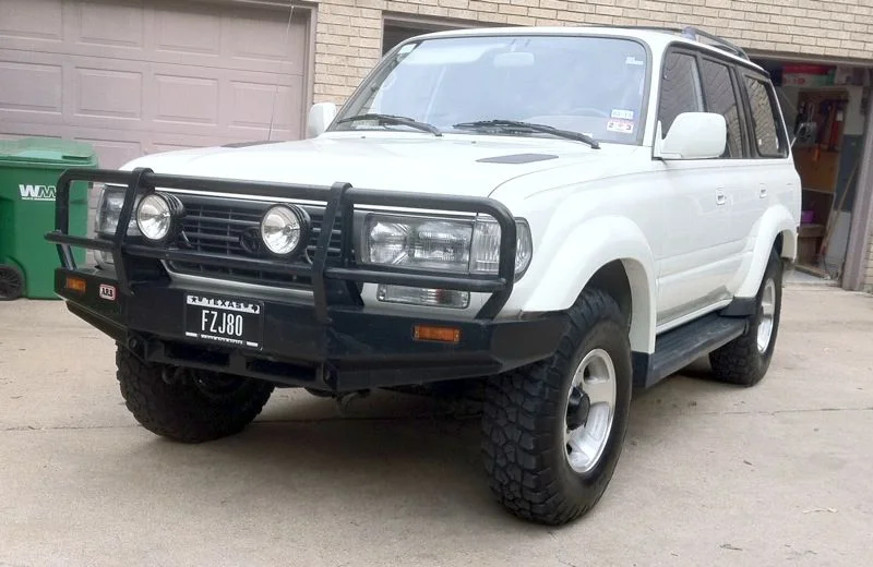

Looks good. Liking the hood as well
yeah man looks good. good find on the bumper too.
the look of those bumpers never gets old......can't wait for mine to arrive.
and the white on a an 80 looks pretty good as well.

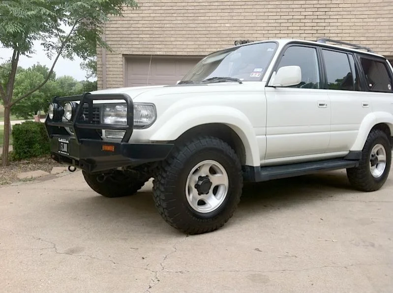

just an fyi on labs rear bumper.
don't know what for extras you have coming with, but with the basic bumper you take more oem weight off the cruiser than you put back on with the new bumper.
Good to know. My Luke bumper is coming as the base unit only - I have the spindles, latches and pins to fab up swing arms myself.
Between you and me, this ARB is pretty scuffed up, which doesn't bother me right now - it's not intended to be a mall queen. But if I ever paint it, it will most likely be going charcoal grey.
Looks good Flank.
If I had kept the ARB I intended to repaint it with some color matching to my truck. Its usable as is but its showing its age.
