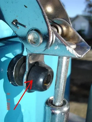

My hooks here are aftermarket stainless ones and I'm finding that rubber (arrowed) is wearing really fast where it rubs against the hood side panels.
:beer:
PS. As you can see, I glued little plastic/stainless discs to the paint on my hood side panels to stop the paint from wearing through there (and to stop the associated rust streaks that would otherwise occur).
I used some rubber clamp tips that have a threaded rod in them. They are commonly used on squeeze clamps. Got them from Grainger and they worked perfectly.
