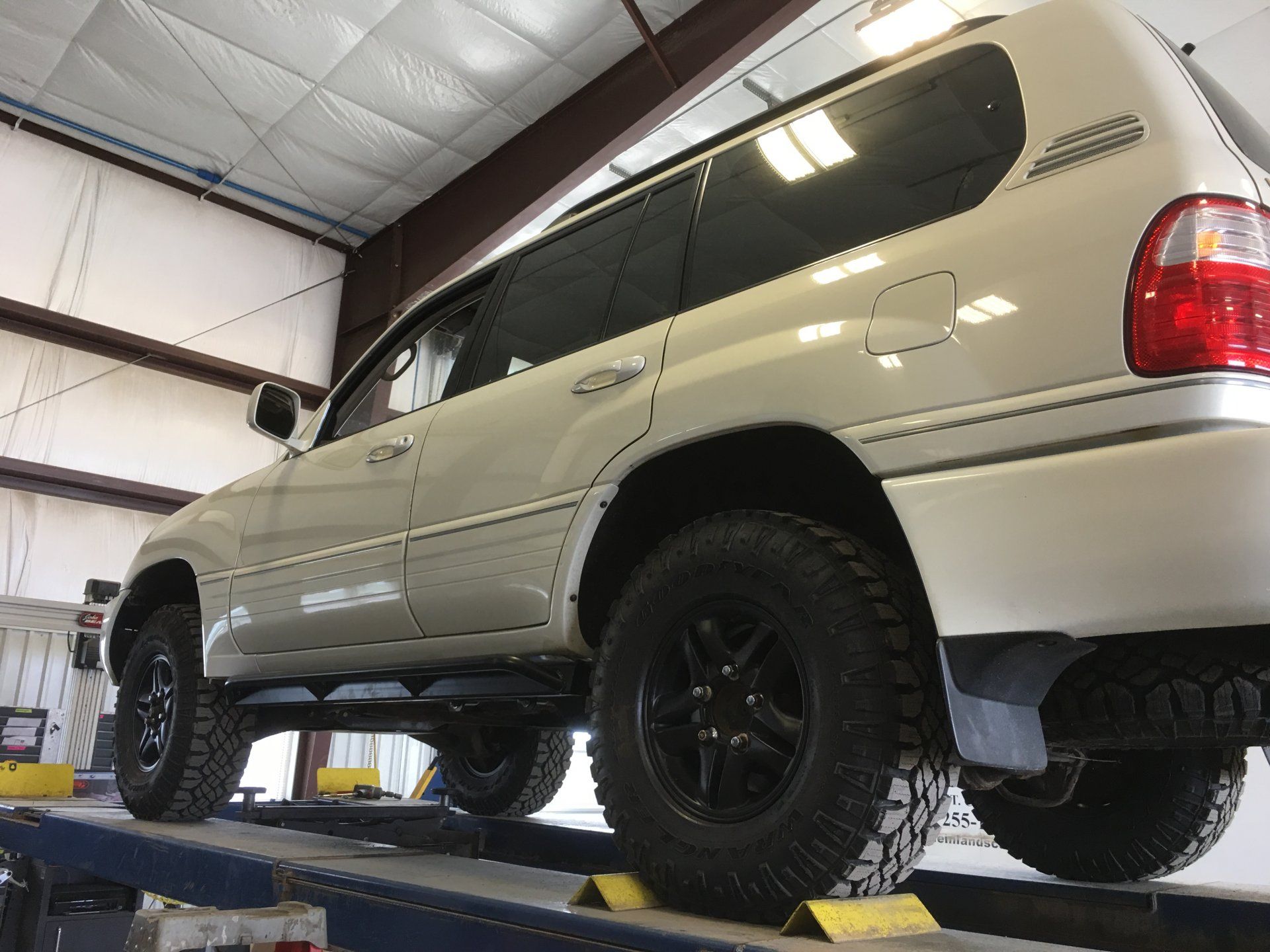

After I add the bumpers and potentially adjust the torsion bars, do I need another alignment? It is getting aligned with the install of the lift.
Ok, so if I change anything with the torsion bars, I will need alignment, right?
Not if you just adjust the torsion bars to compensate for the weight of the bumper. If you adjust the bars to arrive back at the same height as before the bumper you will not need an alignment.
Got it, makes sense. Sorry, I am slow sometimes ;)

Here is the kit:
