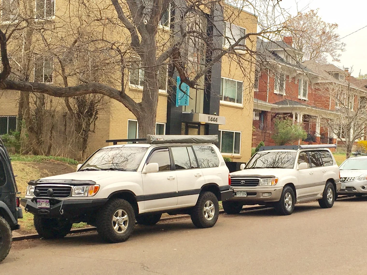

Not sure I can help you specifically, but here is a picture of my old land cruiser without a lift, and my new land cruiser that had a 2.5" OME lift. Both Cruisers have 285/75/16 tires. The lifted Cruiser had Duratracs and the non-lifted had BFGoodrich All-Terrain T/A KO.
Keep in mind too that the non-lifted cruiser still has it's running boards.

Thanks, that helps.
Going from my not so reliable memory, the wheel-well gaps definitely look like your lifted gaps. As well, the running boards were still on mine (until tomorrow).

Wow what a contrast!
Makes me want the OME 2.5" lift also...
What roof rack is on each rig?
Also on the lifted rig I like the black door moulding to match the front and rear bumpers, looks good.
Also on the lifted rig I like the black door molding to match the front and rear bumpers, looks good.
On the lifted Cruiser is has a Front Runner Rack and non-lifted Cruiser has a Gamaviti.
Both are pretty awesome. Would highly recommend both.
The lifted rig has plasti dip on the trim. Works pretty good and it is completely removable.

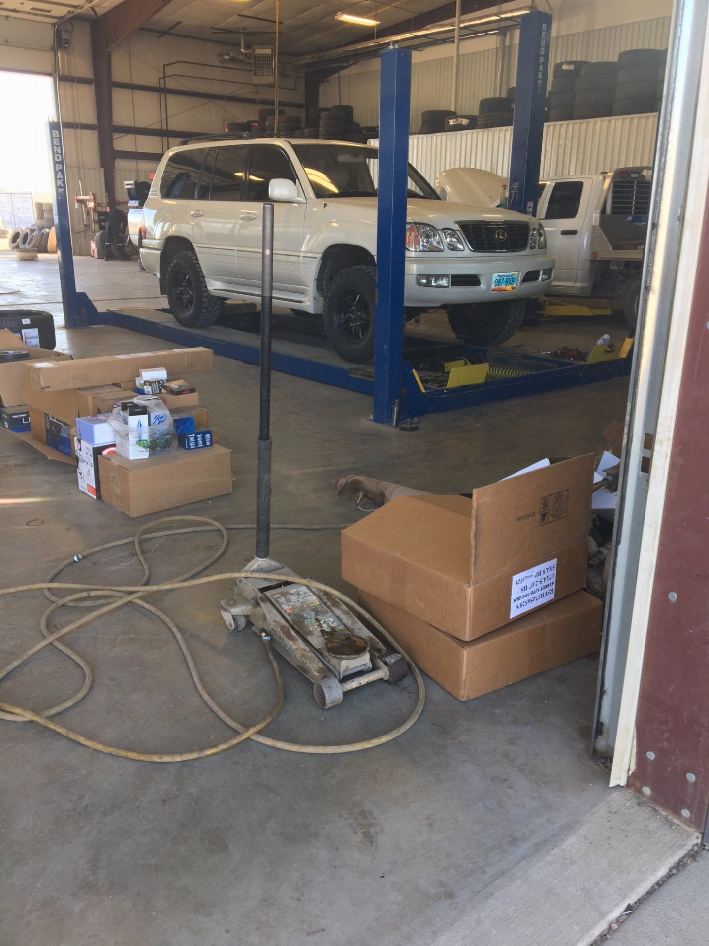

By chance a friend was in the shop today and sent me this pic...
Looks lifted to me...
Agreed, front end should be a little lower than the rear. I had mine cranked level and after all the noise from the suspension maxing out over speed bumps or dips in the road, I dropped it down about an inch or so.
The shop that replaced my AHC with Tough Dog suspension first leveled out the truck like this:
Needless to say it rode like absolute dog****. After lowering the front it looks like this:
It has too much rake for me now (around 23" in the back and 20.5" in the front off the top of my head) so I will crank the front up about 1,5 cm when I get new tyres. Yes, I know i need bigger shoes! This is with OEM size 275/60r18.
One thing I have learned is that a 2.5" lift on a 100 series just doesnt look "lifted" as I am used to seeing. You look at 80 series with bigger tires and they really look lifted. I did the 2.5" Ironman and I am planning to add a rear spacer to give it a bit more aggressive look. tires...295 75/16. Trail Taylor rack.
I wouldn't advise lifting the front any more than it is. You either need more weight in the rear, different springs.... or park facing up hill from now on. :)
No more than 20.5"? I'm sitting at 21.75" with no driveability or mechanical issues.
20.5" was the number that stuck in my head but maybe I was thinking 21.5"... in any case, I do know at 21.5", caster is not correctable to spec with stock UCA's.
I was able to barely get in stock caster specs at 21.5. At 21.75 I'm barely out.
Looks like they have the front end cranked way too high.
Agreed.
How do you guys feel about this: I know when the pic was taken the lift was not fully installed. I was thinking when it is complete, take it home "as is" even if the front is riding high. Install the bumpers and winch, then see how it sits and bring it back if necessary...??
The shop is good, I have no doubt that they will adjust at no charge. However, I want to avoid having them adjust it now, only to have me return it in a few weeks to adjust it again.
But I am new to this....perhaps the bumpers and winch are perfectly weighted, resulting in the front and rear dropping in unison, leaving the truck still looking like an "reverse-stinkbug."
