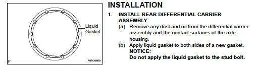

From my FJC FSM (which shouldn't differ) run a thin bead on both sides of the gasket. See excerpt picture. I believe Toyota FIPG cures in roughly 20 minutes. I can dig up the torque specs out of my 2003 Tacoma FSM which should be the same rear-end. Let me know.

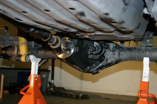

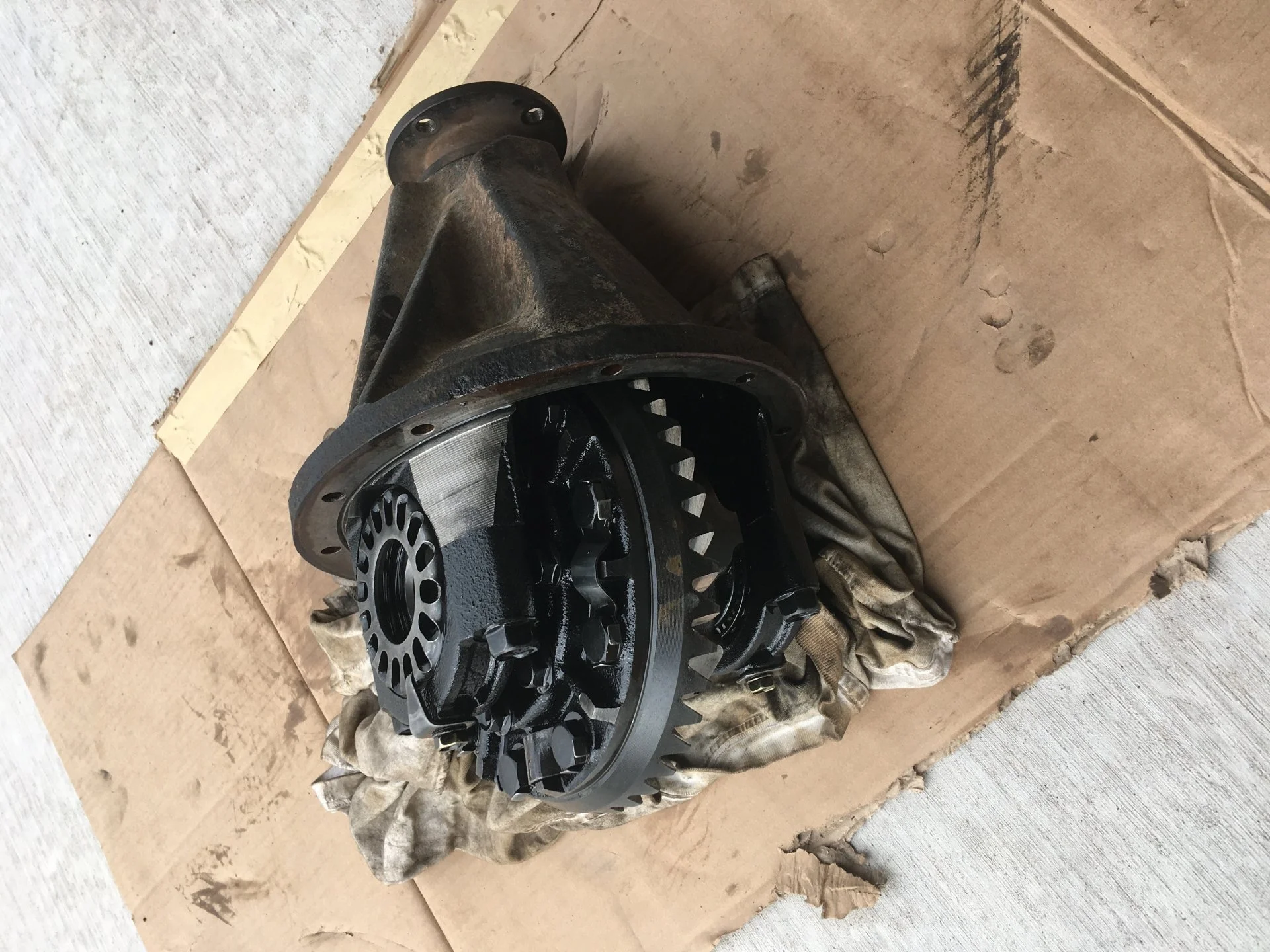

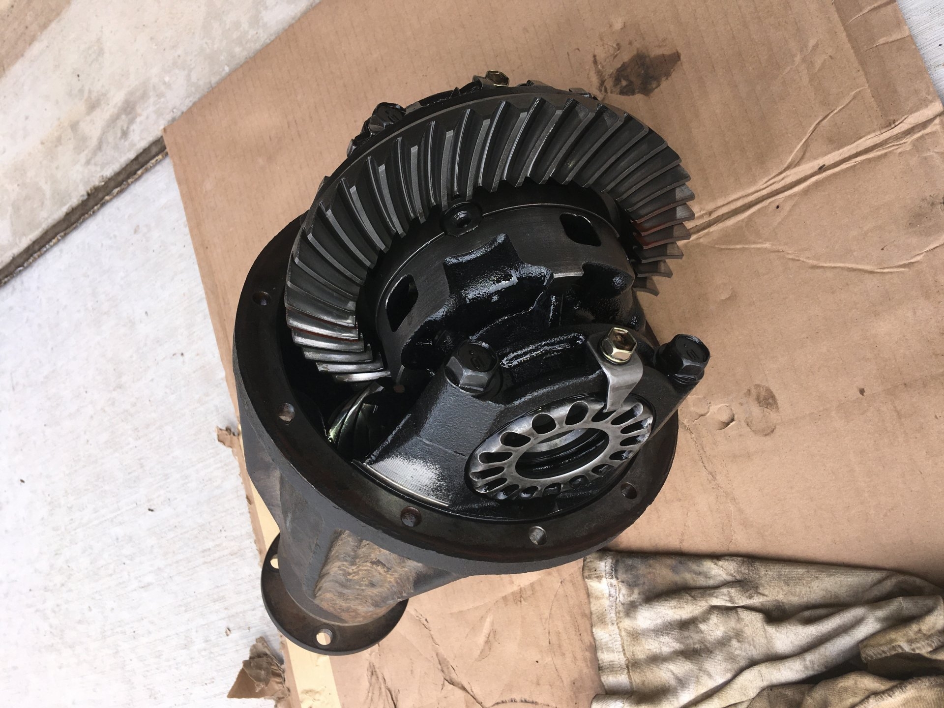

Making slow and steady progress. Got the 3rd member out this weekend. This job kind of sucks without a lift and a proper jack. I had the vehicle jacked up like a stink bug and on stands but still had barely enough room to get under it. Then I used a ratchet strap to secure the diff housing to my floor jack and got my daughter to help with dropping the jack and pushing/pulling it out from underneath it while I wrangled this 60lb hunk of junk from underneath. Everything is covered in what appears to be carbon. When turning the input/pinion flange by hand, there is a ton of slop and you can hear clanking/clacking sounds. And it feels rough when turning, to me indicating that the pinion bearing failed. I can't see any obvious damage on any gear faces and the spider gears/bearings appear ok when I turn it manually but I honestly wouldn't trust anything inside there at this point. Also was very relieved to find out that I had determined the right gear ratio a couple years back by turning tires and counting revolutions of the drive-shaft. I did a tooth count on the ring and pinion gears and came up with 43:11 (3.91) on the old one and the 'new' used unit I had purchased from a salvage yard in CA a couple years ago. Whew! Now I just need to spray a couple gallons of brake parts cleaner into the used one I bought because it's full of sand from the salvage yard that sent it to me.
