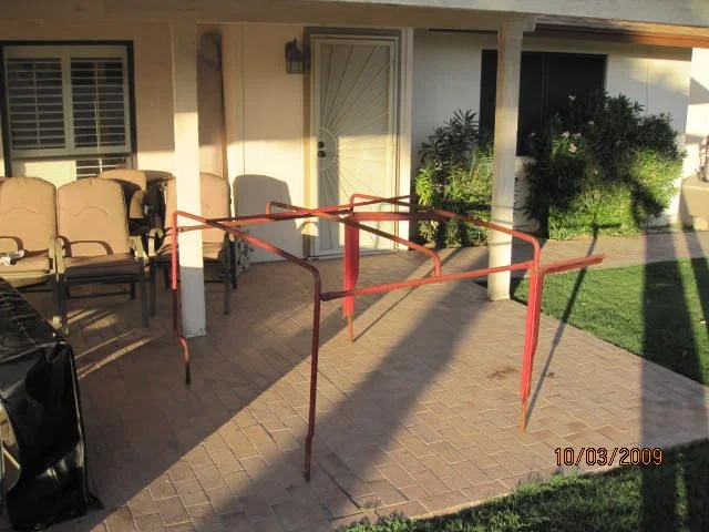

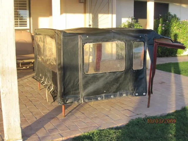

Opps I guess this top is closer to the Kayline than I thought. The windows are both in the side roll up part. It is not split between the windows like I posted earlier. I was cleaning the top I got this week and the top looks pretty close except the window are smaller in SOR's top. The only thing I can say about SOR top the color may be closer to OEM. When I bought my Kayline new white and black were the only colors. That may have been different in earlier years. In Johnny's OEM soft top tread in the 40/55 section someone posted a red one. STC was offering them in many colors too but I don't remember every seeing anything but white and black.:meh:
Compraring the two tops plus a pictures of the bows.
