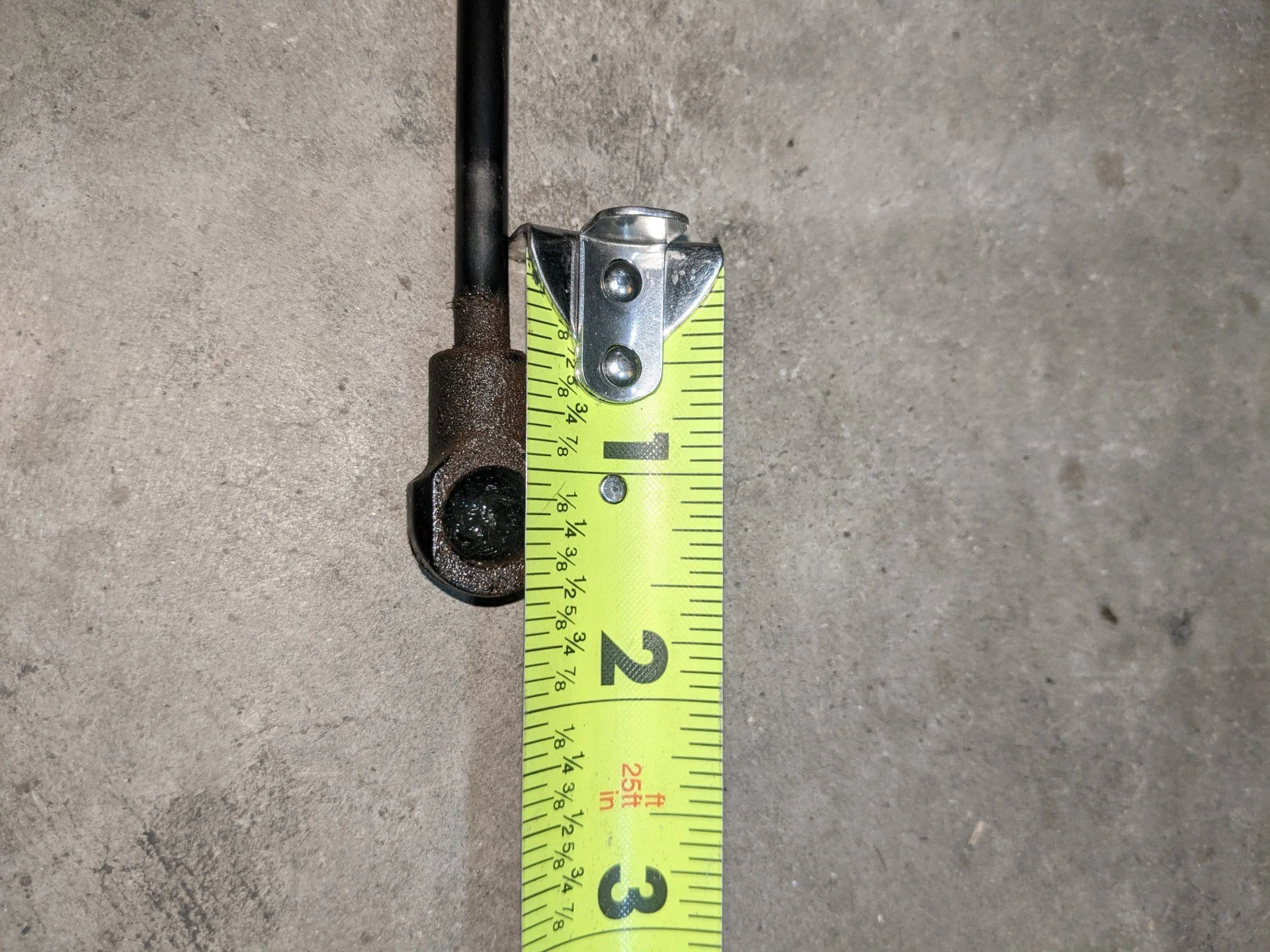

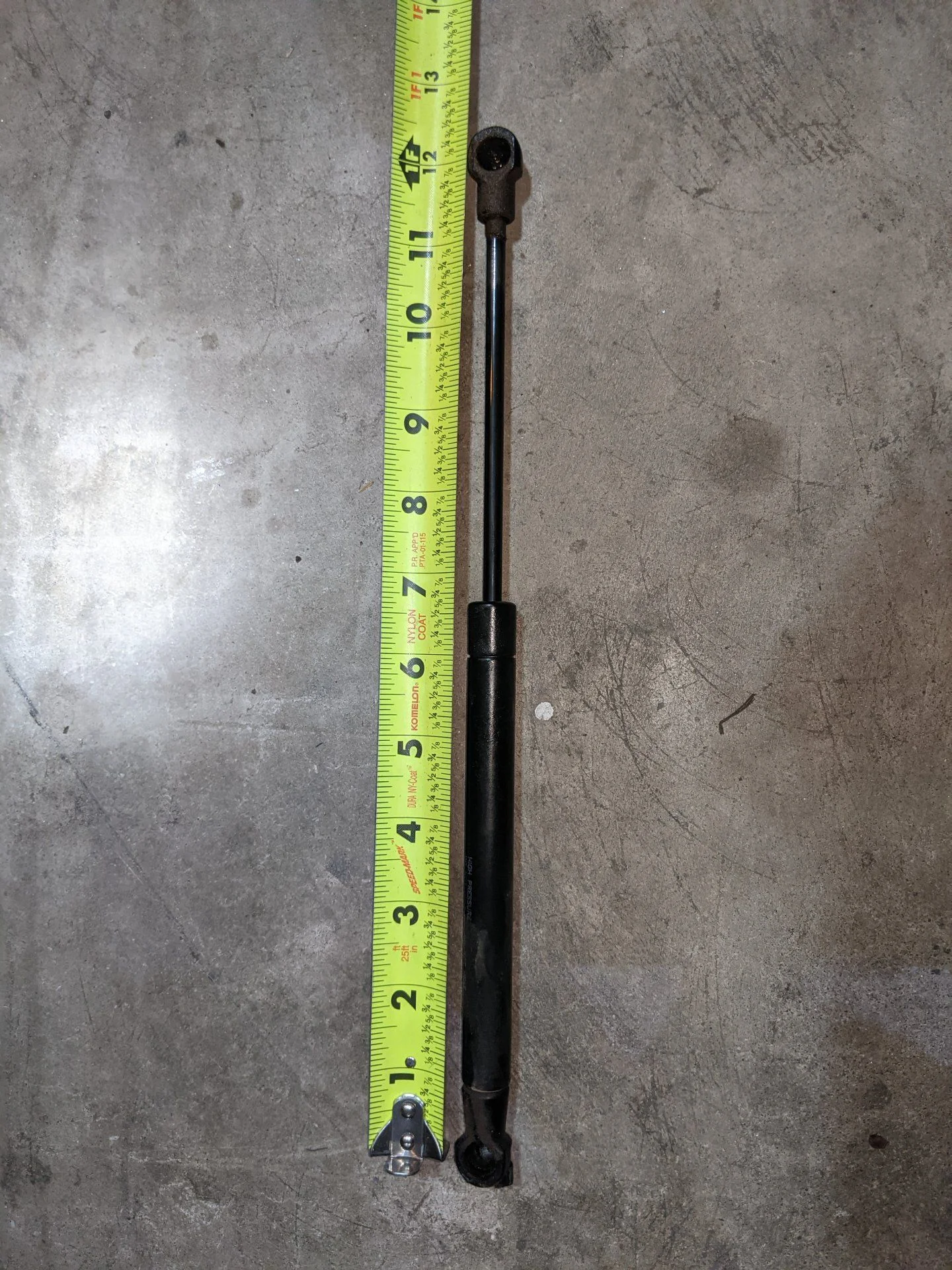

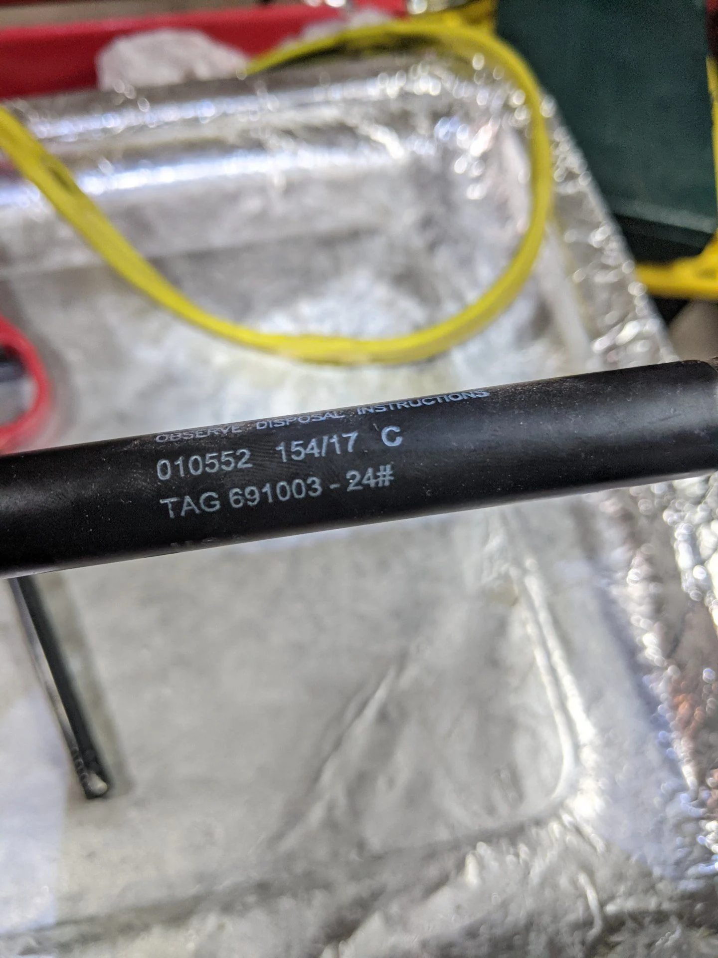

So the gas struts for my Leer camper shell is leaking and they are struggling to hold up the rest hatch. I tried entering the numbers printed on the strut on Google to find replacement but having difficulties finding replacement. Any recommendation on where I can find equivalent replacement? What are the key dimensions that I should pay attention to beside extended/collapse lengths, lift poundage and the size of the ball joints? I attached a few images of strut that I'm trying to replace.
These were good replacements for the leer on my 2000 tacoma. They have a bit more pressure than the originals, but thats what I was looking for. I matched them up by extended/collapsed length

I didn't know napa has them, I'll try them out. If not, I'll either try Amazon or lift strut website. Thanks for the suggestions.
