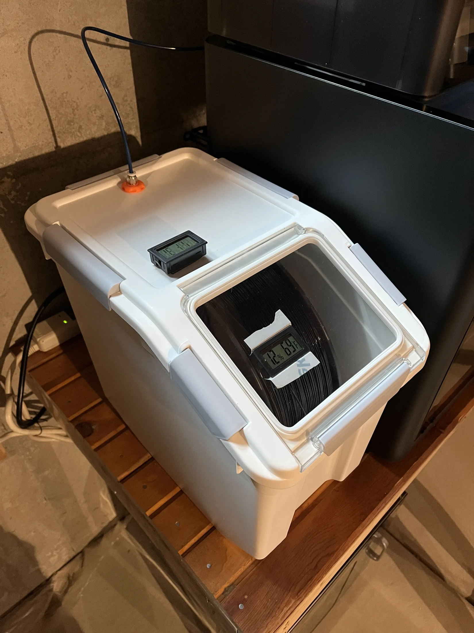

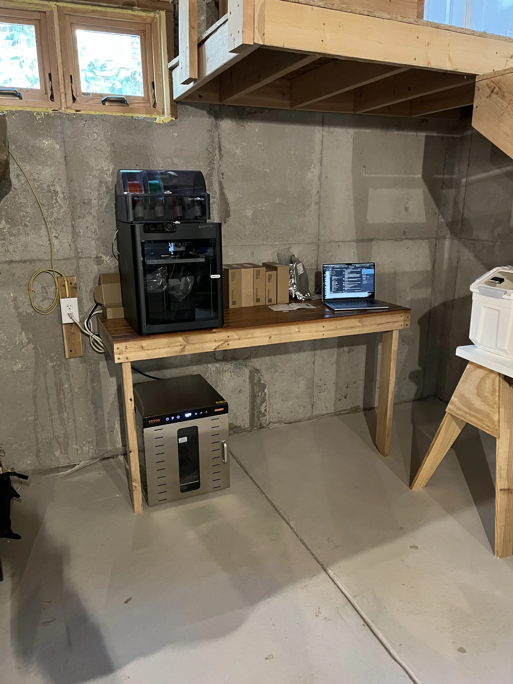

3D printer is set up. Have a dedicated space now, plus a filament drier (the large dehydrator), a dry box for a 5KG roll of Nylon, and we're off to the races. Kids are enthralled:

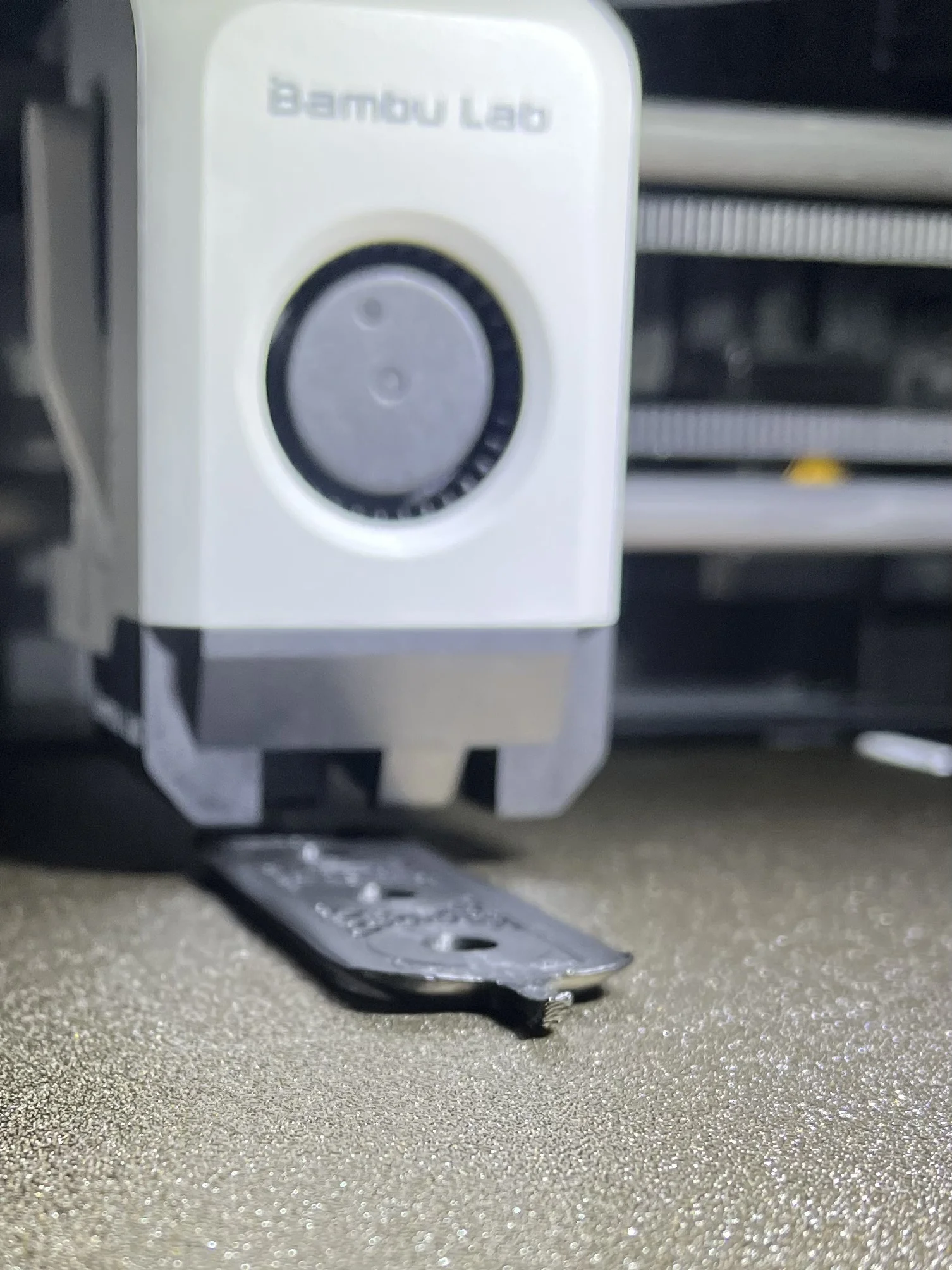

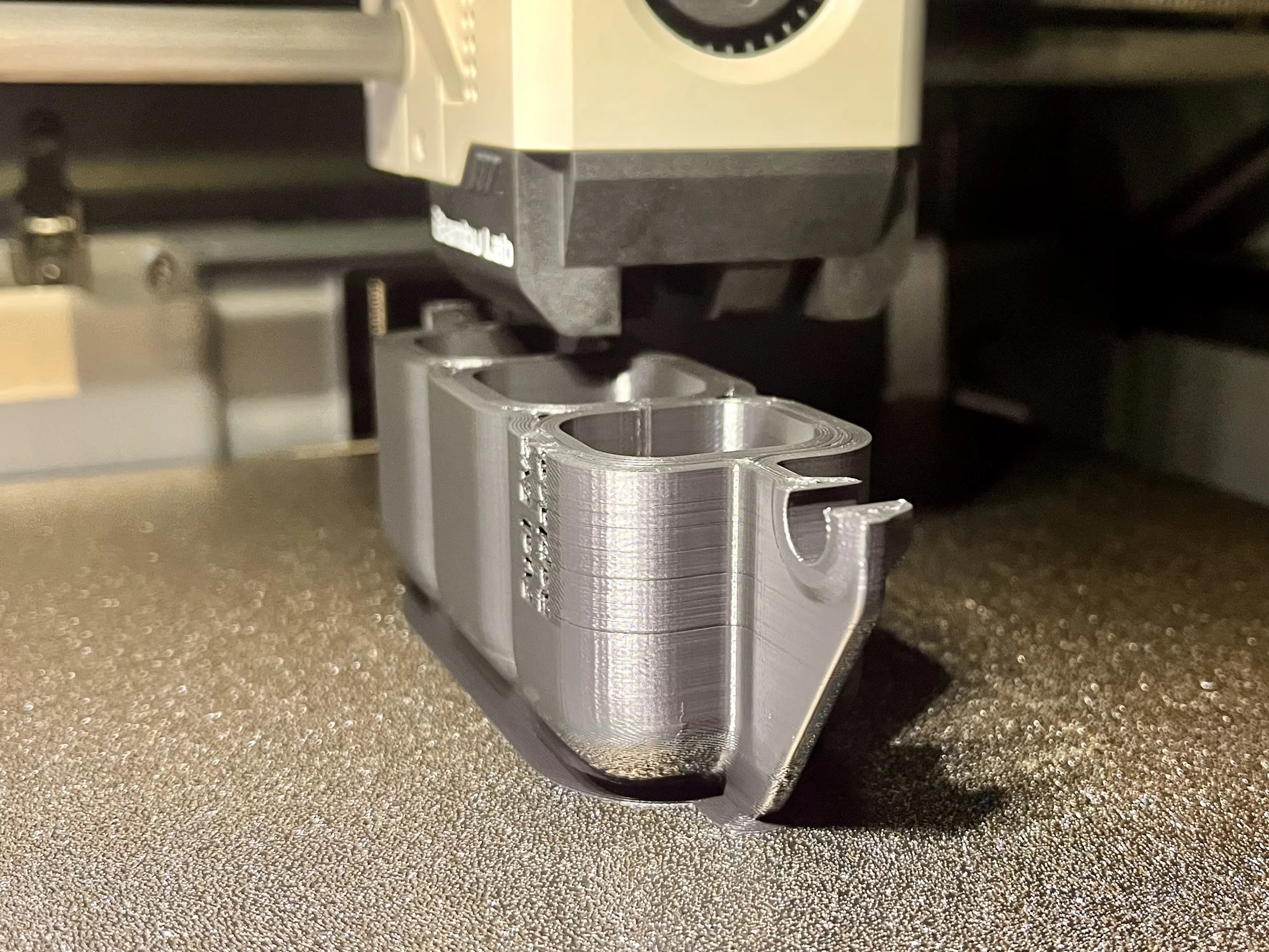

Working on dialing in print settings for nylon... Aborted the first print after 15 or so layers as the edges were curling. Here's what that was looking like:
Knocked down the fan speed to keep temps up and the current print is looking much better thus far, but I can tell I'll need to be dialing in surface finish. Here's the current prototype:
They said Nylon is a PITA, and it seems to be living up to the reputation, but I think it will be manageable.

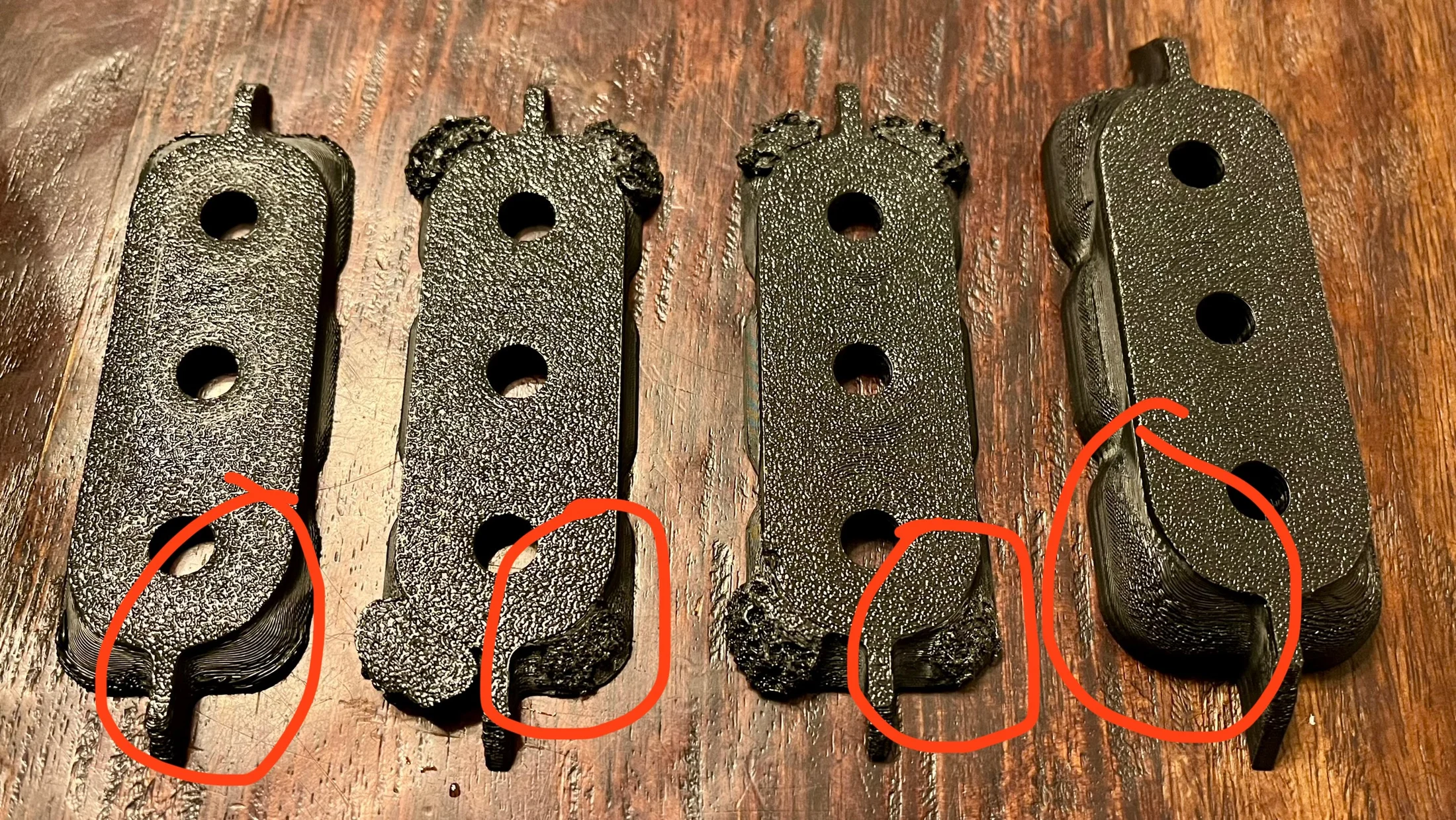

For those who want to delve into the madness of 3D printing, here are my attempts up to now:
  1. Stopped this print after seeing poor surface quality and lots of curling. This was due to poor bed adhesion (didn't properly clean the bed first) and too much cooling in the print chamber.
  2. This print failed around 90% through, likely also due to poor bed adhesion (still hadn't properly cleaned the print bed). Quality is pretty rough on the sides, only recently learned this was mostly due to under-extrusion (print speed too fast)
  3. This print completed successfully, but still terrible surface quality, and some pitting/holes due to under-extrusion. I hadn't started slowing things down yet. There also may have been too much moisture in the nylon. I did use supports for this print, although they did not break away cleanly and left a terrible surface finish on the bottom. Thanks to a properly-cleaned print bed, it took real effort to remove it.
  4. Turned off all cooling for this print, played around with support settings. Surface quality was not looking great still, and I noticed on the infill sections it was god-awful. This was the ah-ha moment, as the infill sections print much faster than the walls. Still can not remove the damn supports, leaves a lot of artifacts.
  5. Slowed things down from ~200mm/s print speed to ~100mm/s. Quality notably improved, but not there yet. Played with support settings again, but still too much adhesion.
  6. Slowed down to ~60mm/s, and now seeing much better quality. I had resolved to let this print continue, but there was a filament tangle in the dry box and it failed. I am still seeing minor curling on the overhangs, so I will play with even slower speeds or perhaps some cooling for those parts. Ditched the supports, but added a brim (much easier to remove)
  7. In progres... Added some cooling to the overhangs, looks good so far. Wall quality is great. We'll see tomorrow how it looks, hoping to have the first nylon print I can pressure-test.

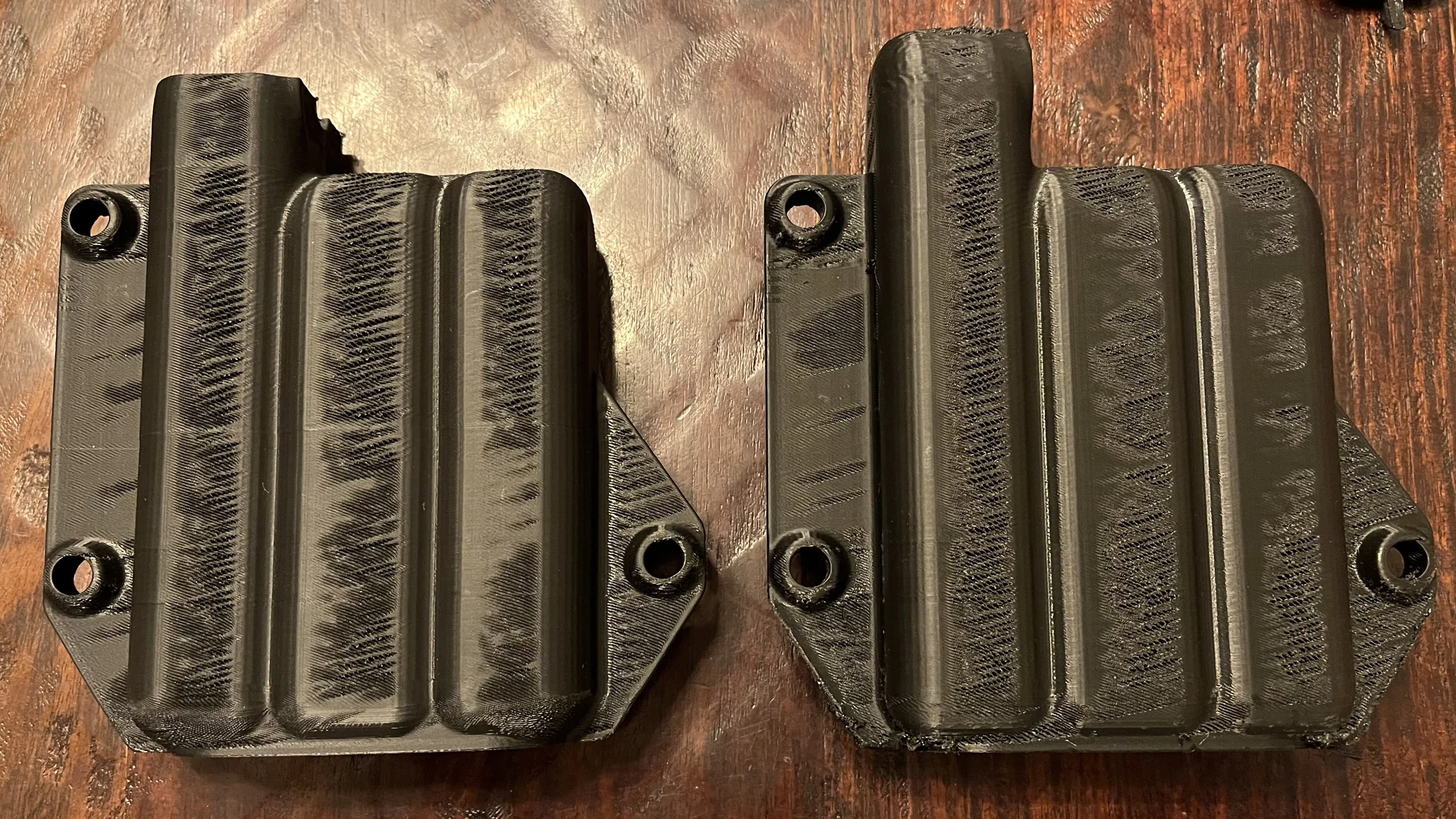

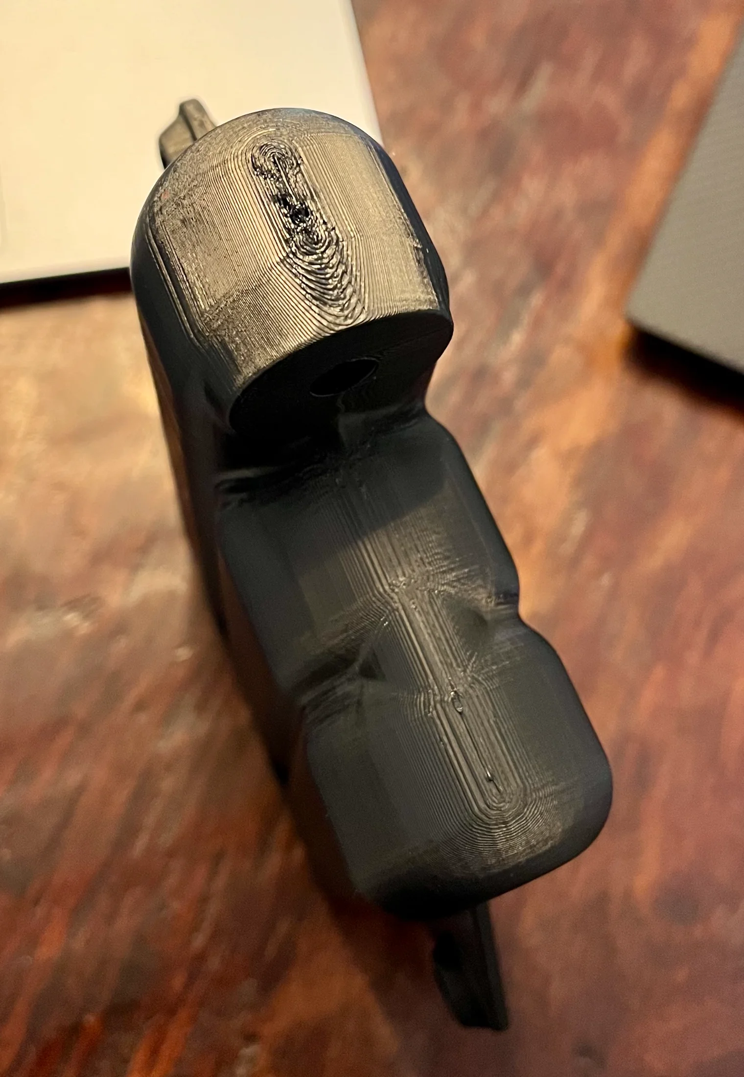

Circles in red: curling on 1, stuck supports on 4 and 5. Also note how thick the walls are on print 6. Aside from meat where brass threads are going, I think the walls can be half that thickness and still be plenty strong. The next photo shows more detail on the surface quality for overhangs. Left to right: first print, curling. 4th and 5th prints, stuck supports. 6th print, getting there but not there yet (no supports).
Under-extrusion (looks like scratches) due to print speed too fast:

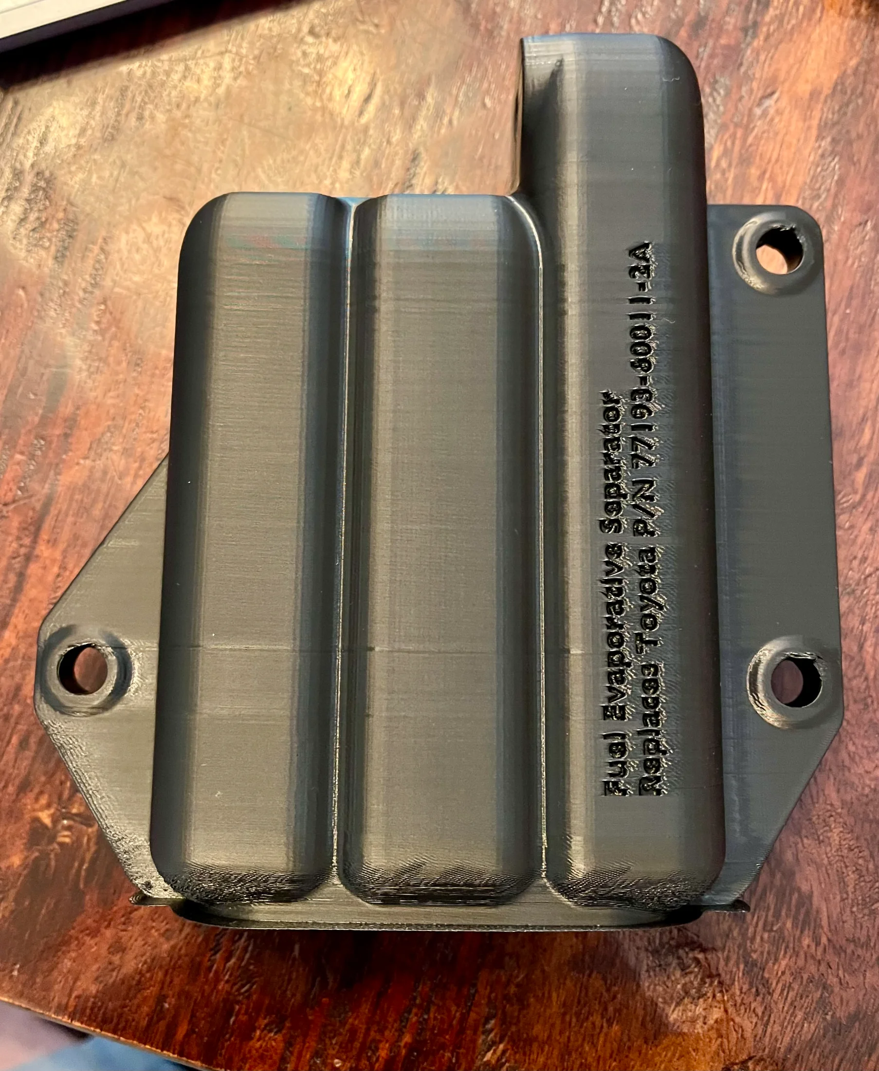

Here's print #7 in-progress, so far so good. We're in "functional but not pretty" territory now, I still want those overhangs looking nicer. You can see the brim printed around the first layer to reduce curling/warping:

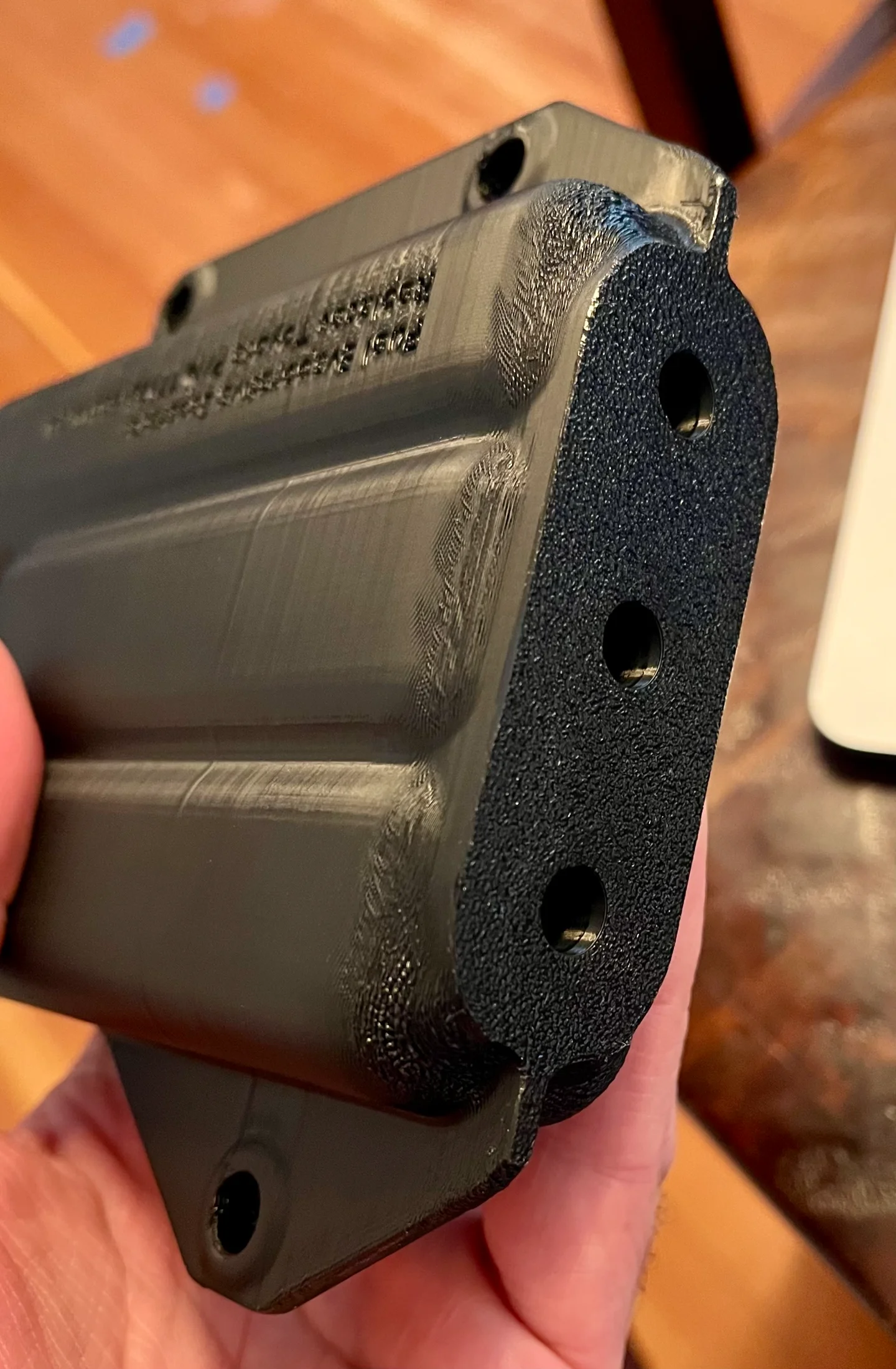

Print #7 is a success! Seems to hold air pressure (very un-scientific "plug holes and blow into it" method), but good enough to test drill/tap etc. I'm still not satisfied with the overhang surface quality and the top of it is a bit rough too, but this is leagues better than prior prints, and without supports as well (which is how I designed the part). I'm doing more iterations to test overhang surface quality next, and I'm going to make some design tweaks to slim down the ridiculous wall thickness.
Lastly, I have a new build plate on order which will provide a smooth finish to the bottom of the separator. This may require PVA glue for bed adhesion, we'll see.

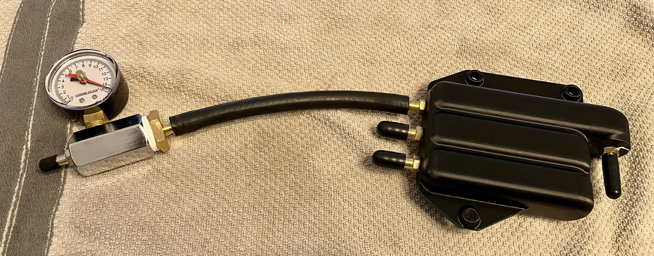

Even though it took some babysitting, it holds pressure! This is a huge milestone as 3D prints are not known for air-sealing. I've gotten here because of the filament type and the small layer-height / line widths, as well as how dense Im making it.
Been at 14.5 PSI all day today, still holding. Had one issue w/ the top port because I went too far w/ the tap, but that's an easy-to-fix skill issue in the future, for now teflon is holding it fine.

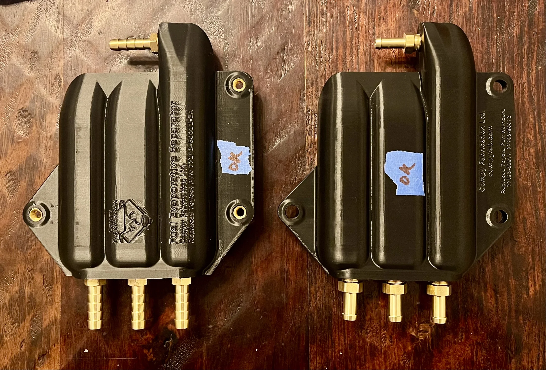

Question for the masses... I now have models for early and late versions of this, the main difference being 2 mounting points versus 3 (see pics):
2-bolt version (small cover)
3-bolt version (large cover)
But I don't have good visual references for the fuel separator that was installed in the middle bench seat for some trucks, only the one that is mounted on the passenger side of the cabin behind the seat (next to to the fuel neck).
Does anyone have a reference for what the in-seat separator looks like? I'd like to model that one as well, and I plan to model the '80+ separators too.

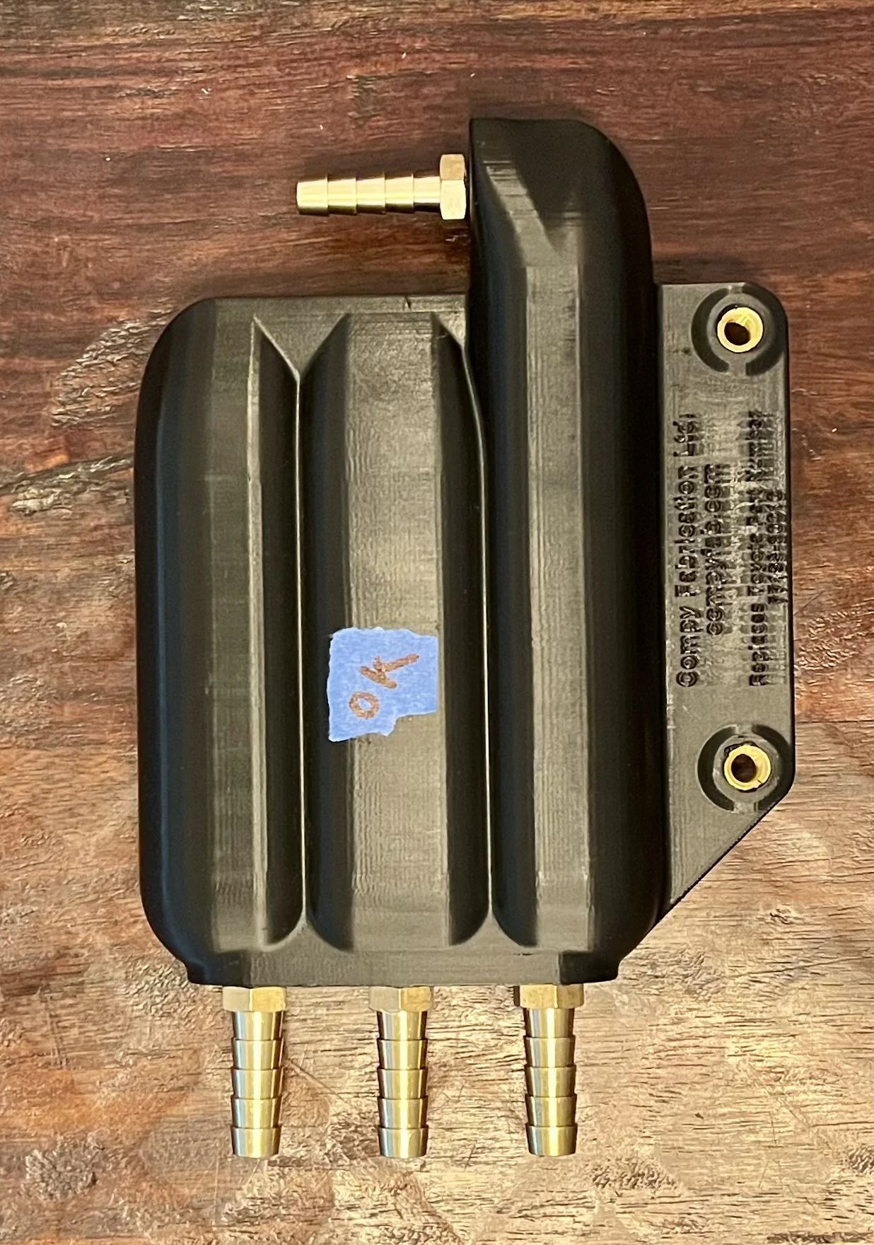

I'm also planning on changing the hose barb style to match the OEM version more. The barbs are slightly shorter, but only have a single nipple and seal just fine / hold pressure with my testing. I decided to make the change after noticing that the more aggressive barb style was tearing up the test hoses I was using because it was so dififcult to remove. I have serviceability in-mind, and this part is in an awkward spot anyway.
I think the shorter barbs will reduce strain on the whole unit, especially considering one of the lower hoses curves to the side (and this is why I think that barb is typically the one that fails). Let me know what y'all think:
View attachment 4007680 View attachment 4007681

With regards to universal fit, currently the 2-hole and 3-hole versions are compatible with each other. You could mount up a 2-hole version to a 3-hole setup and nobody would be the wiser unless you removed the cover. Similarly, you could mount up the 3-hole to a setup which uses a narrower cover, and either deal w. the fin sticking out or cut it off. The 80+ models appear to use the same bolt pattern as well, its just the internals are shifted. Again, if anyone has pics / reference for the in-seat vapor separator, I'd love to see some pics.
As for 3D-printing viability... So far so good, but it's hard to say what will happen in 40+ years with these things. I will say that I am doing everything I can front the CAD, to filament, to print settings to ensure its as reliable as I can make it. Thus far, they hold pressure, and I mean around 15 PSI for days on end (until I remove the setup and test the next one). The filament Im using is 100% PA12 nylon, no carbon fiber or glass fiber reinforcement. If you have a suggestion on a test rig to punish these things, I might consider it if its within my means.

It's nice to know it can handle 15psi, but that's probably overkill. I did a test one time and I don't think these vapor separators ever see more than 0.2-0.3 psi, because the tank itself would probably blow up at 1psi.
The smooth hose fittings would be a nice upgrade, I had forgotten how hard it is to remove those hoses once they've been clamped for a while.
Received my vaper separator from @procomsignathid , and my initial thought is that it looks great and is super high quality. I hope to install it this weekend and will post more thoughts soon.
