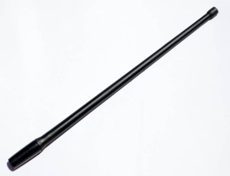

Hey Guys,
Been trying to research if anyone has replaced their powered mast with a flexible static one? Looking to replace my broken one, but I'd rather just use a shorter antenna mast that is static. Something like this.
Any thoughts? Would this work if I removed the motor?

So, no one has put a static flex antenna on their 100 series?
I saw a writeup on mud of someone using a tundra antenna. came out great, but was more than I wanted to do. I was thrilled when my audio guy fixed the old one...
Thanks guys. I saw the tundra one. Not exactly the same thing.

Did you ever get this question answered? I am in the same boat where I do not want the retractable motorized antenna, just a short one.

Successful replacement, man it was not fun pulling on the mast to get the mast cable out but i managed to do it and looks so much better w/ the shorty fixed mast
