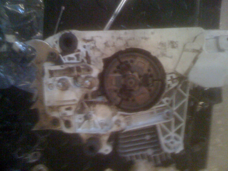

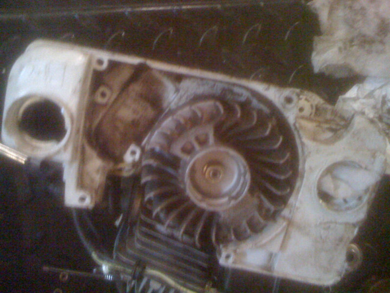

Anyone know how to remove the engine block from the plastic case? My gray plastic case is cracked, got hit by my son's truck. I have a new case and everything stripped down to what you see, just not to sure how to remove clutch oiler or what else has to come off/flywheel? See pics
STIHl MS310
Got it found this post great write up. I guess I need to get a piston stop to remove the clutch. Any tricks to getting the flywheel off or do I need that tool too?
stihl ms310
Got everything apart I was hoping not to have to split the motor apart but it was the only way to get it out of the plastic case.
