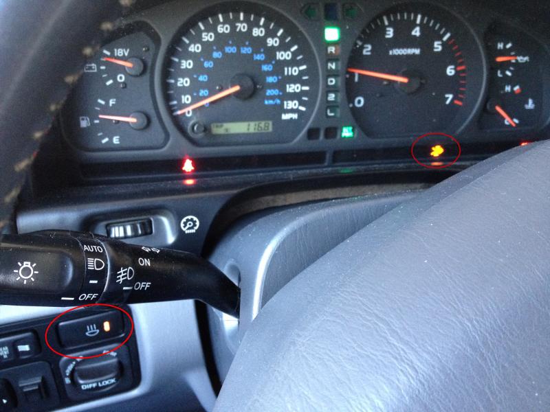

Respect. If already retrofitting an OEM diff switch, have you given any thought to retrofitting a Toyota switch to operate the compressor as well? Very slick.
No I decided to pass on the OEM diff switch so I could still independently lock my front. However I am still looking for other alternatives. Not sure if anyone has the ARB switches like mine but they get rather warm to the touch...has anyone else noticed that?
BUT the OEM compressor switch! Now I like that one! Wouldn't happen to have a switch available would you RobRed? If not looks like I will be digging through some part-outs... And just curious but is that actually a OEM compressor switch? Looks somewhat like a fog light switch or something mounted sideways. I came from 4runners so cut me just a little slack, the tricks of the trade are still new to me on a 100!!
Thanks guys for all the input btw... :cheers:
The fog light switch above the locker switch controls the compressor. When depressed the compressor turns on, the lamp in the switch activates and the "clogged air filter" lamp illuminates in the dash. I thought the clogged air filter lamp looked most like it was compressing air. :)
Not going to lie but I never even noticed the dash light that was circled in red! That's really cool I think I might give that a shot!
Very nicely done. For some reason, I confused Artwerks picture of his 100 (very nice BTW) for yours. The added dash light is decidedly the piece de resistance to me. Also, a big thanx for TLC FAQ. Just an awesome resource.
Excuse me if this is a silly post, but I have an actual front diff lock indicator on my instrument panel. If you have this, wouldn't you prefer to have that indicate when your ARB front locker is engaged instead of the "replace air filter" indicator?
