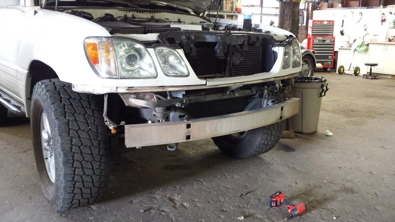

First: I removed the plastic bumper bolts securing it to the sub bumper and body of the vehicle, this exposed the sub bumper.
A good buddy and co worker of mine lets me use his and his friends shop. It's more than just a shop IMO though....Here is the Blueberry waiting for its install!!!!
The sub bumper is held on by a few bolts that are easily accessible, once these were removed this exposed the frame mounting plates....were going to cut these off...hopefully without any boo boos....
Here is a picture of the plate/bracket that you have to remove in order to mount the Blueberry. Cutting along the welds with an grinder worked great for me! After that I went over the spots with a smoothing wheel.
Here it is after it was cut off, smoothed, and painted with Rustoleum Semi Gloss Black
Can you spot the finished product?! Well at this point let me tell you there is a lot more things involved in the install of this bumper. After temporarily mounting it you have to carefully align the bumper correctly and mark two holes through the side of the bumper. You then VERY CAREFULLY drill two holes all the way through your bumper. This part was very attention demanding I guess you would say so the pictures pretty much stopped at that point and it was 100% hands-on until the job was done! Hope you guys enjoyed the few pictures....

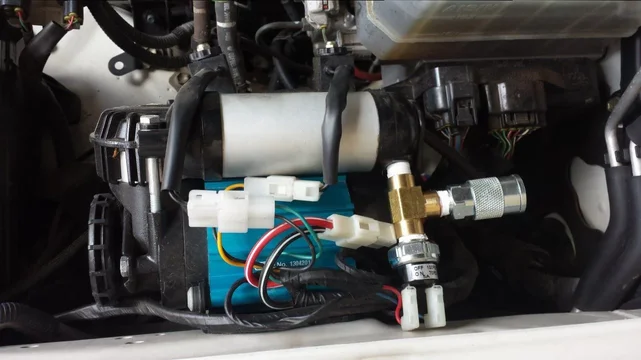

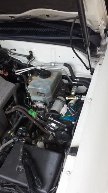

Well, after doing a little more wheeling out here in Moab, I started to realize how nice it would be to be able to air down and air back up after the trail run instead of having to drive all the way into town to air back up after wheeling if there are no other vehicles or we are w/o air. So I went off to my local hardware shop to get some air fittings. Here is what I came up with on my OBA system. I have been thinking about plumbing a slider and using it as a tank as a few of you have done but that will come one day when I get a bug to tinker I'm sure. BTW with this new forum layout is it better to attach the full image or just the thumbnail? Or which would the reader prefer?
