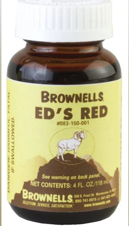

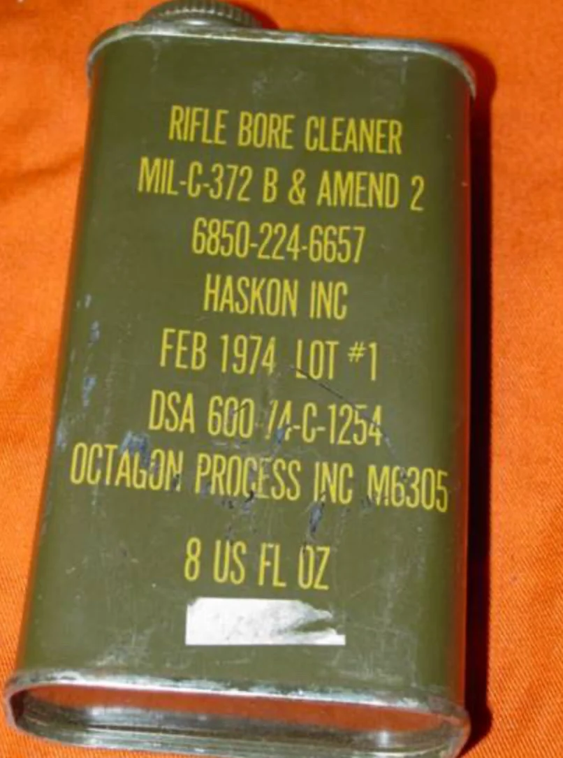

I had looked before to find a commercial preparation but this is only what showed up…I don’t think the 3rd photo would do much
So no commercial version; just a recipe. Is that correct?
The recipe I’ve always used is in post 4.
4 ingredients…make what you need but I use 16oz of each & put it in a industrial spray bottle. Need a heavy duty spray bottle as a normal one won’t stand up to the mixture.
As mentioned above, Brownells sells/did sell it as word spread about it over the years.
But other than that. there is no widespread commercial availability. It is so easy to make and so cheap that this probably impacts any commercial sales viability.
I keep a couple gallons on hand here and often give small bottles to local friends/customers. Mainly just so they can try it and become converts. ;)

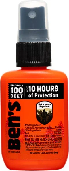

If you do mix some up, keep in in tightly sealed containers. I use small (50ML) bottles with needle tips like these for dispensing it. (Longer tips than these are better usually)
if you decide to use it in spray bottle, do not bother trying to use the generic ones that you can pick up at the grocry store in the cosmetic isle or in the "travel kits". The aetone will destroy the plastic inner working of the valve in the spray mechanism pretty quick. I am sure there are spray bottle available for harsher chemicals that will work, but I just have a couple of small spray bottles like these that originally contained DEET spray. Stands up to the acetone just fine.
The small sizes of these containers makes them very handy for getting into tight spaces for application.
