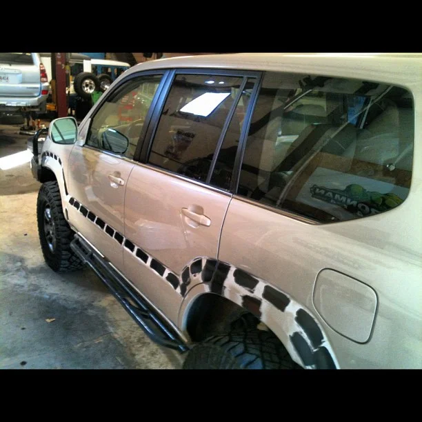

Did some searches and found details on the Land Cruiser 200 but nothing for GX that I saw. I'd like to remove the side cladding on the doors of the GX if there are only 3M tape strips holding the trim on or if it has holes drilled in the doors. Looking at Prados, I have to imagine they are only held on by tape.
Does anyone know? Anyone done this before?

If you go to my build thread, starting at post #170: Builds - R2M 2013 GX460 Overland Build - https://forum.ih8mud.com/threads/r2m-2013-gx460-overland-build.1104719/page-9
You can kind of see the molding coming off the doors and it doesn't look like any holes, just adhesive.
Take a look and see what you think. :meh:
Look like there are holes to me.
there is tape as well to seal it off and keep it on.
Yeah the post with the red truck with the panels off clearly has holes. Seems like a bunch of unnecessary cost by Toyota but what do I know. I guess I'll wrap the chrome on the strips black at some point instead because I'm not filling holes just for aesthetics
There are holes. A lot of them. The 460 has fewer as the side trim is less extensive, but they have holes. A 470? Don't even get me started.
